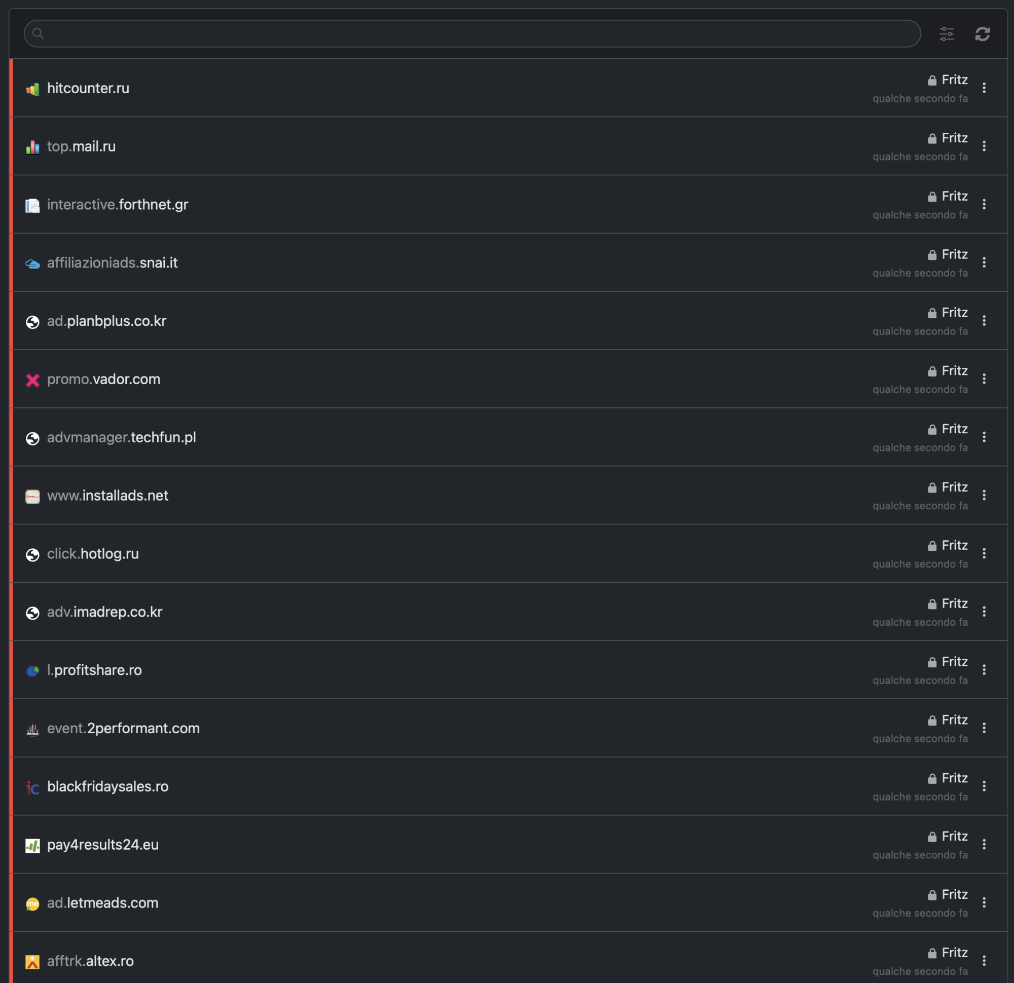

I have been using NextDNS for a long time to filter and control outgoing connections from my devices. My iPhone, iPad, and iMac (2019) use a DNS configuration profile, and the router is also configured to use NextDNS via DoT.
For the past few days, around the same time each day, there have been "ghost" connections to Russian tracking sites, gambling sites, or adult sites, which are correctly identified and blocked by NextDNS. In the NextDNS logs, these connections appear to be coming from the router, not from any Apple device with a configuration profile. So, I installed Pi-hole on an old laptop running Ubuntu and, to my surprise, I noticed that these connections were actually coming from my iMac.

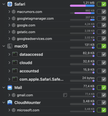

At this point, without losing hope, I removed the configuration profile and installed Little Snitch, confident that I would find the culprit, but so far I haven't had any success: tonight, NextDNS recorded the same connections highlighted in the screenshot (which, by the way, are always the same, in the same sequence, for days), even though these connections don't appear in Little Snitch.
At 22:02, while I was writing the post, it happened exactly the same odd behavior... Little Snitch was not reporting it (see attachment)
