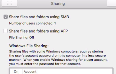

Having the same issue since I've applied the patch. Interestingly, I had previously experienced this at some point running a beta version of 10.13.1.
What works for me is to activate Windows File Sharing for the account, but that seems like an insecure workaround.

You have Windows File Sharing checked right. That's a work around, a little insecure.
I just now realise that I only have SMB connections from my Mac to my NAS, not to my Mac (and I don't have Windows File Sharing checked). I missed this in your second post, sorry for the confusion.

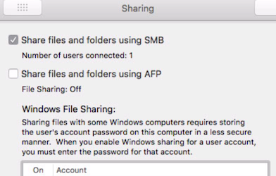

.... insecure ... .... WHY?
;JOOP!
