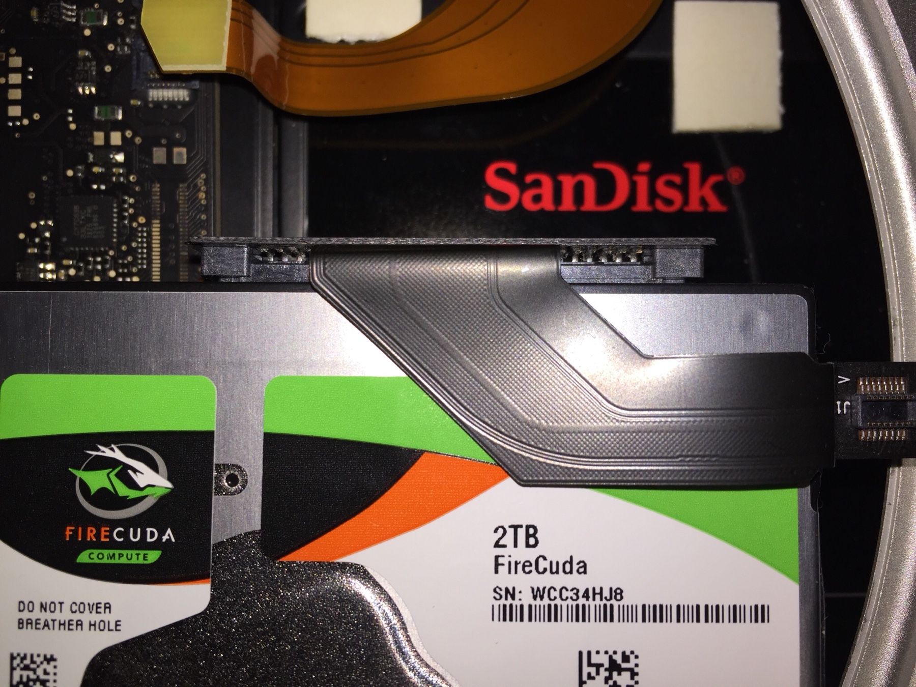

EDIT: I did a clean install on external drive and SU went fine with it. But I don't have big enough spare drive to clone my whole internal FD or timemachineBU to it. Something in my internal FD's system hangs the mini at boot after SU and I would just like to know what...
I never found those verbose boot logs.
But in the picture might be the reason.
Now I have plain old hdd as the slower part of Fusion and update went fine and no beachballs yet.
Would be nice to know more about Fusion and how it defines which drive is faster and can user fix that. But since apple wants to get rid of fusion alltogether to sell their ssd with huge profits, I guess we’ll never know...
