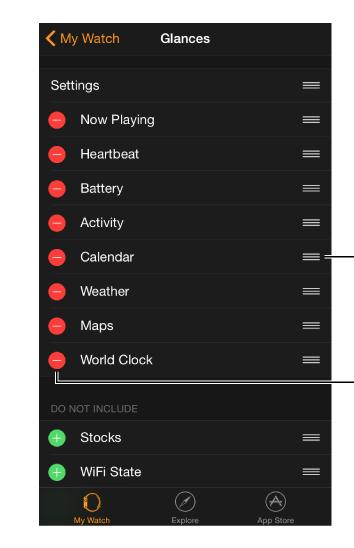

It looks like there is a "Wi-Fi State" glance that can be enabled as well to potentially see which Wi-Fi network the watch is on?

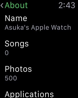

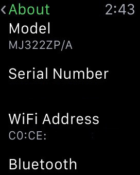

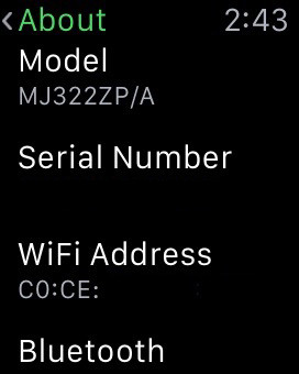

I know that my watch does not connect to my Airport Extreme at home (the one that my iPhone connects to). You can display the watch's WiFi MAC address, and mine is not seen on the access point.
Curiously, that glance is absent on my watch and watch app.

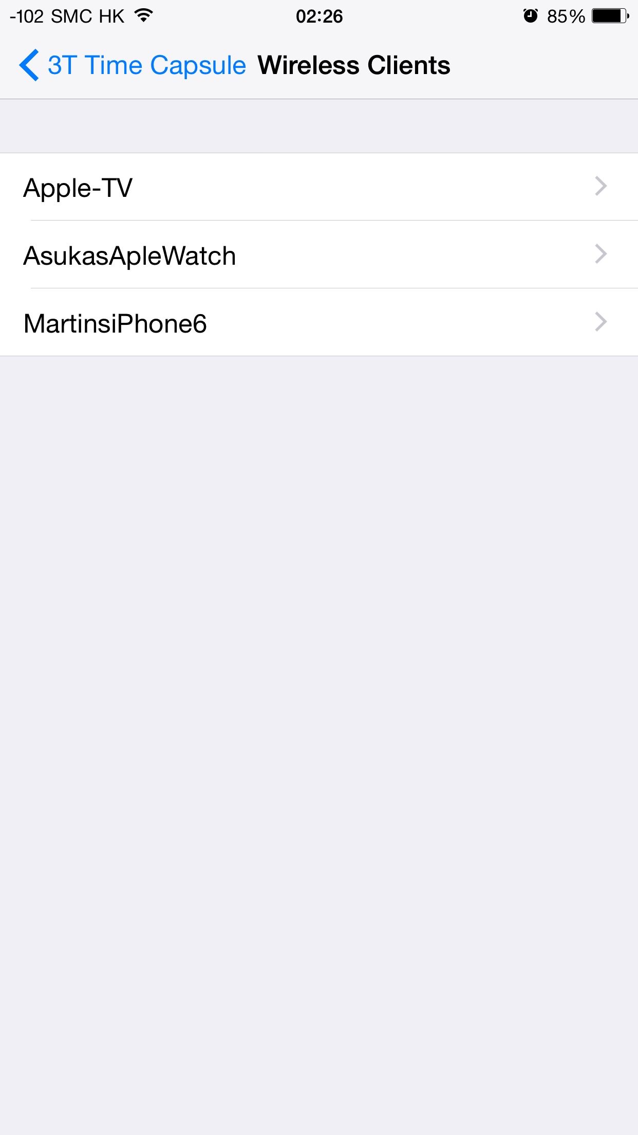

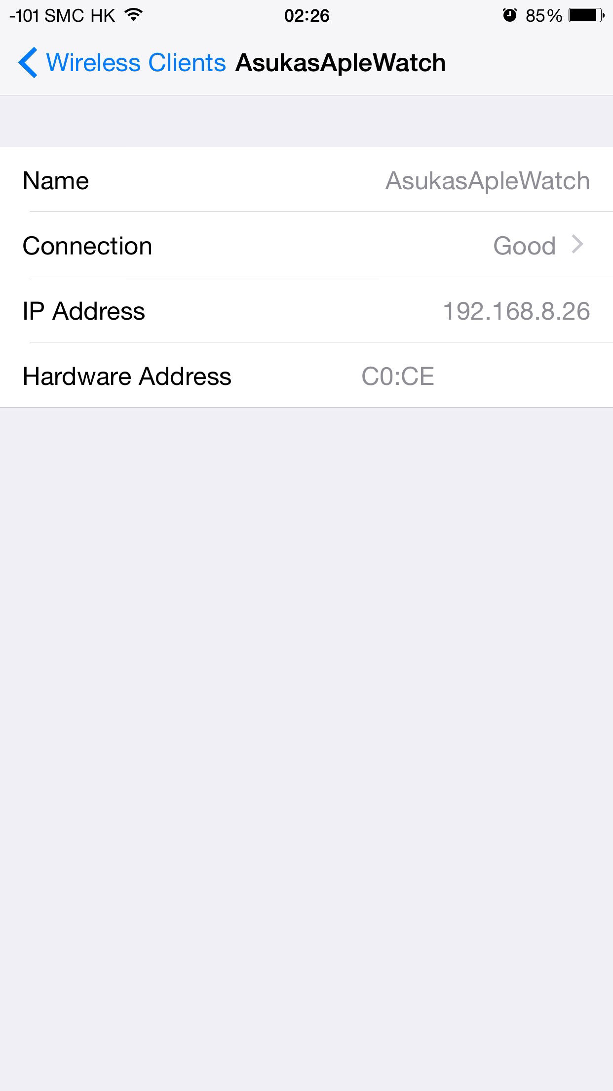

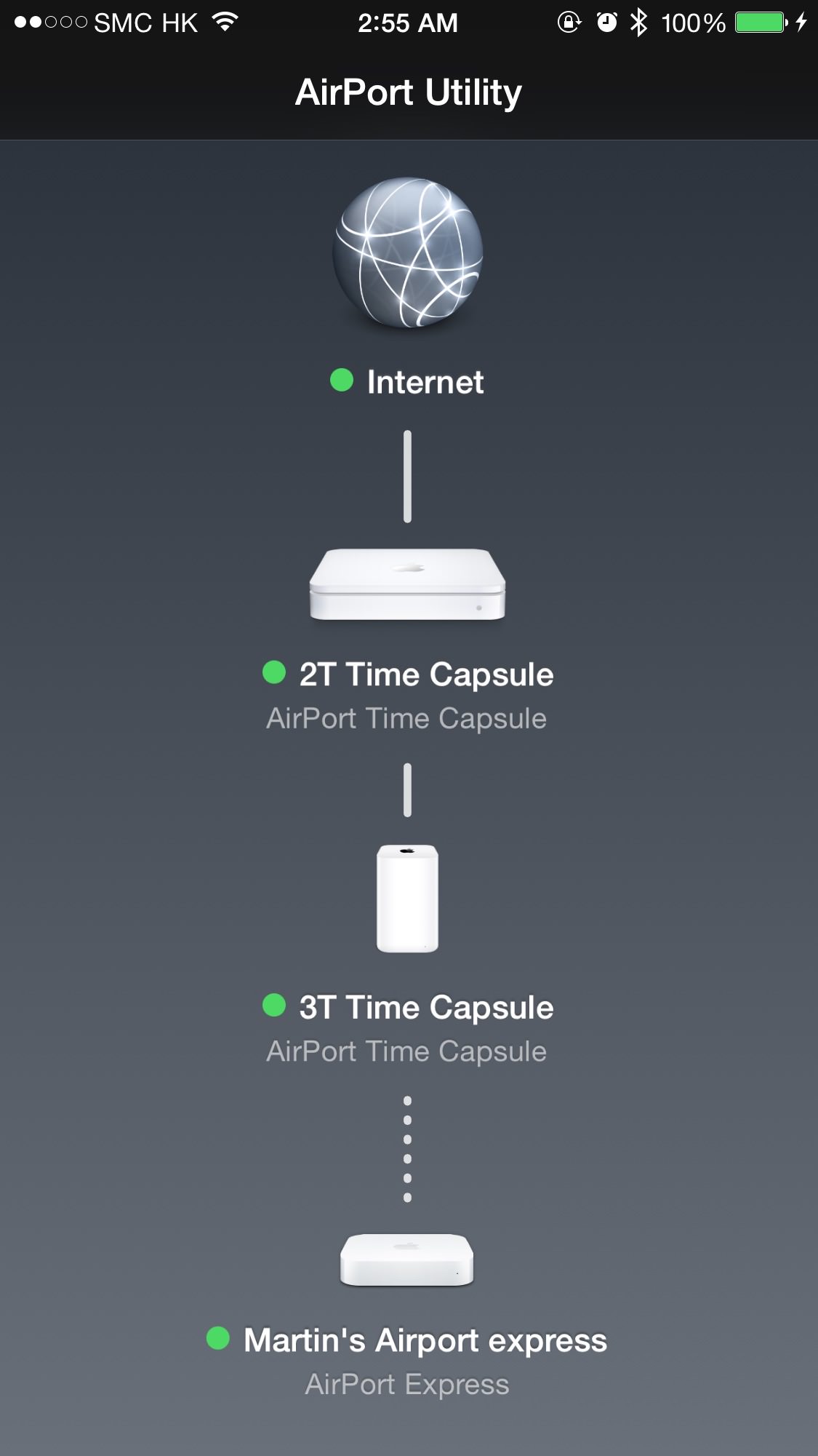

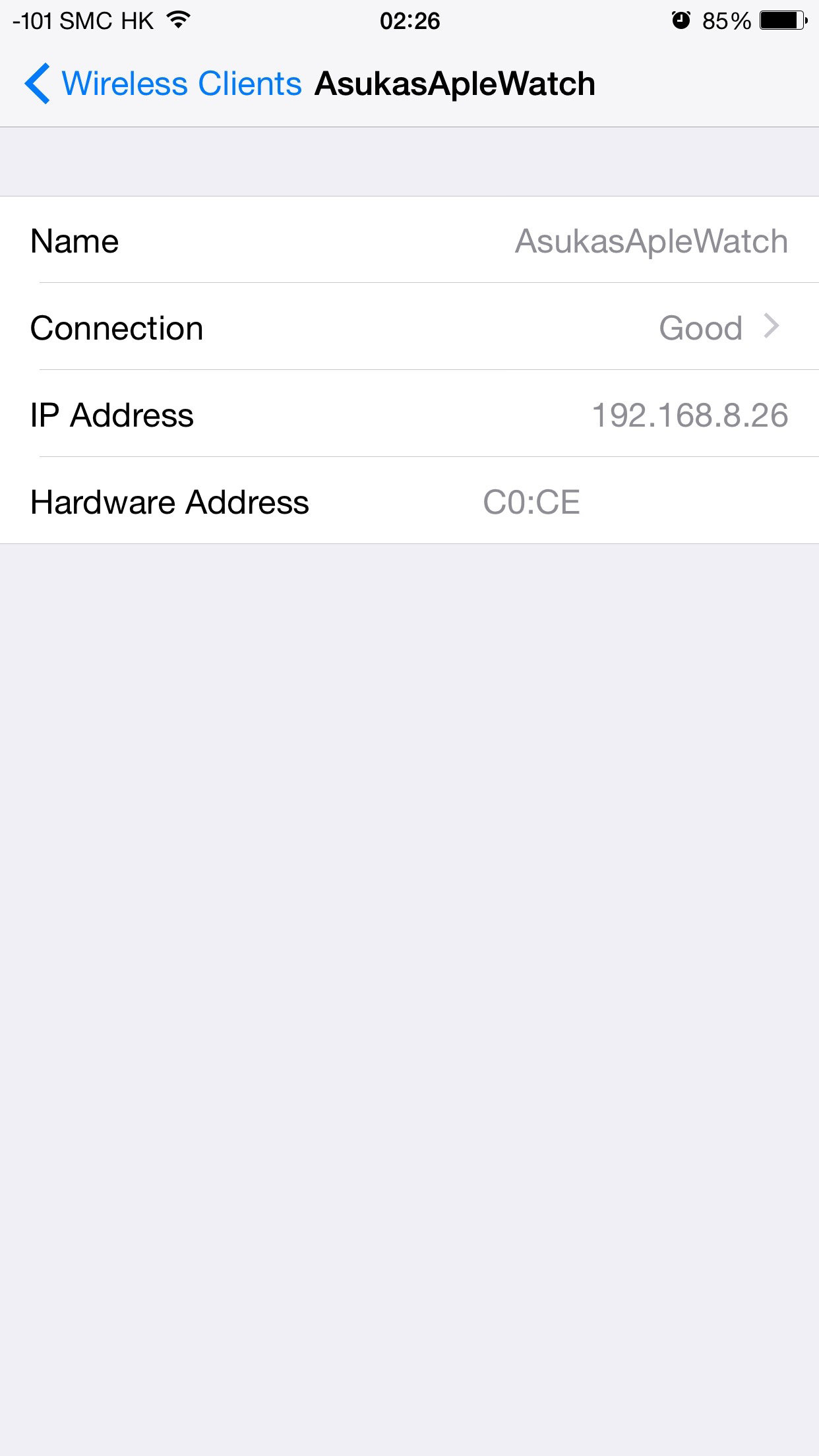

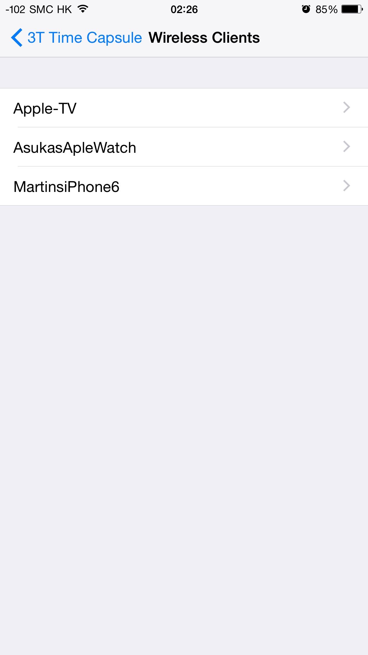

OK, just tested it. The Watch will connect to the Time Capsule / Airport Express, and it will shows up on the client list.

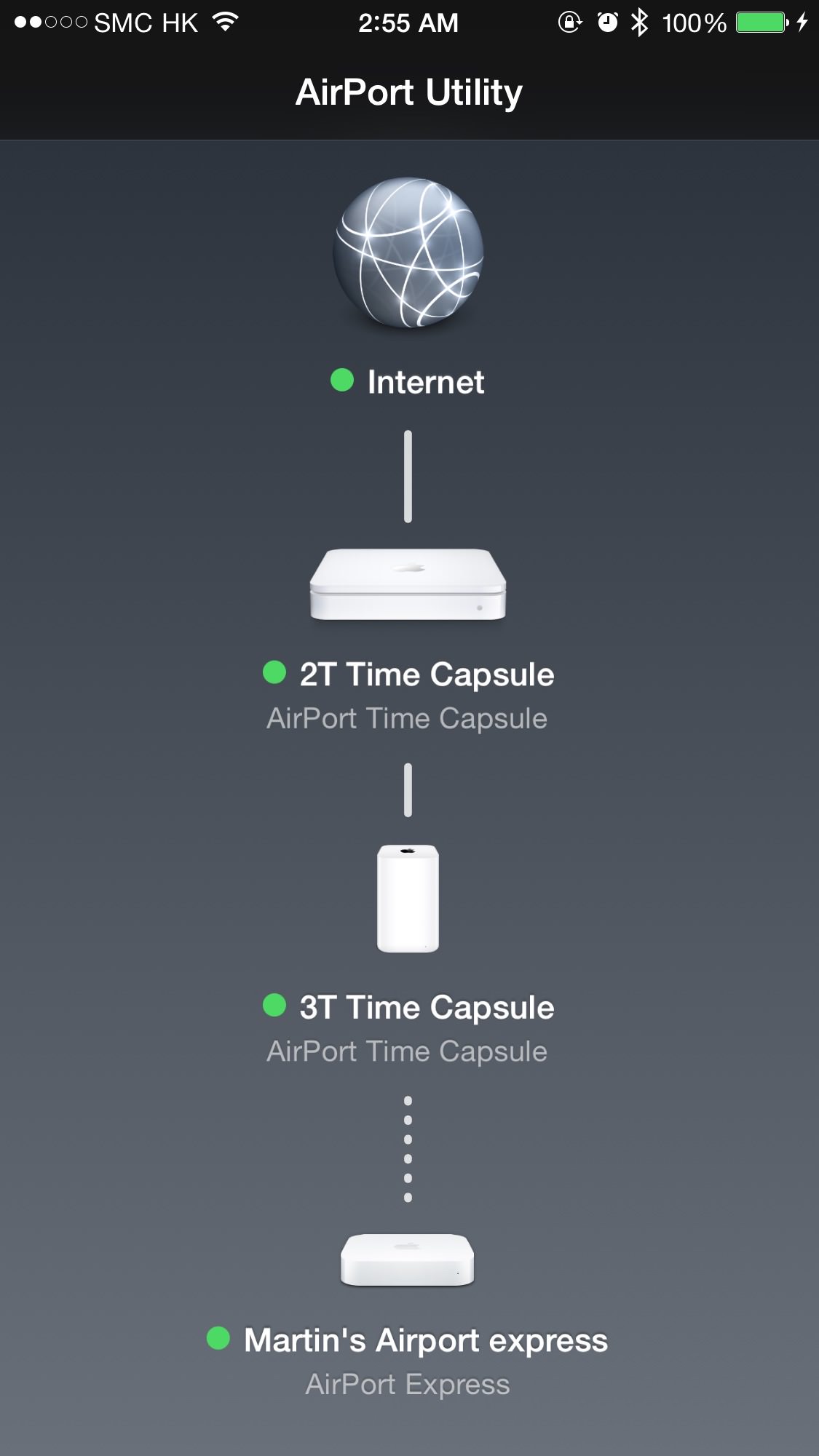

And the watch can connect with the iPhone via the Wi-Fi network (NO direct connection). I test it by leaving my phone on the upper floor and use my watch at the lower floor.
So, my iPhone is connected to the 2T TC (inside a room at upper floor), there is a cable between the 2T TC and 3T TC, and my watch is connected to the 3T TC (lower floor). The watch remain full functions. And during the test. I switch off the iPhone's BT as well.
In fact, I can connect my watch to the AE (setup as a wireless extender), which is even further away from the phone (inside another room in the lower floor). I am actually living at 45/F, all floors and walls are very thick concrete. It's just impossible that the watch still has any direct connection to the phone, but they are still connected, and the watch is fully functional all the time.
