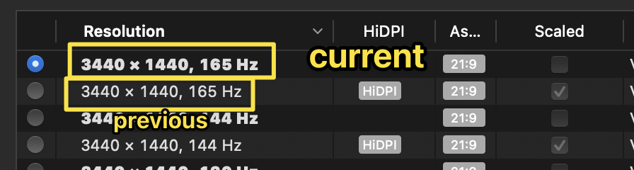

My monitor normally displays 3440 x 1440 at 109ppi
I recently factory restored my M1 MacBook Pro and only after 3 months I noticed that the display settings defaulted to a suboptimal resolution. This caused me to experience eye strain and headaches after prolonged use. After some research, I fixed the issue by changing the scaling in SwitchResX and enabling font smoothing. This made a huge difference. However, I can still feel a more strain when compared to a higher PPI (and native) resolution.
