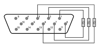

You can always make your own HDMI dummy plug following this guide:
How To Make a VGA Dummy Plug

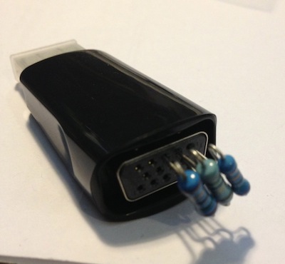

I made one of these myself today using a HDMI > VGA convertor and some 75 ohms resistors. Cheap and easy to do.

You can always make your own HDMI dummy plug following this guide: <snip>
808?, you're a star. I'd found similar info on a Mini Display Port/VGA dongle, but not one for HDMI/VGA. I'll be off down my components store this weekend 🙂

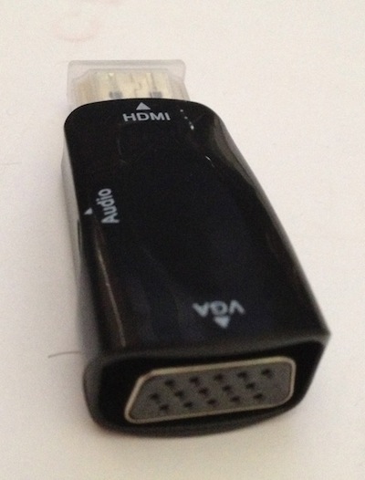

VGA dongle almost working...
Hi folks,
Thought I'd post my experience as it might helps others and I'm still looking for some advice.
OK, so I made up the dongle as described in the images posted by 808? above (by coincidence I even got the same HDMI/VGA converter 🙂). As it turned out I used a stripped-down male VGA connector to solder components to when the Mac's behaviour was erratic, and I wanted to make sure it wasn't caused by loose connections inside the female VGA of the converter.
Results as follows, using Screen Sharing and with System Preferences open to the Displays page:
  • All three links (1-6, 2-7, 3-8) made by 75ohm resistor: Mac toggles between 'VGA display' and 'Unknown display' once every second, switching resolution as it toggles
  • All three links (1-6, 2-7, 3-8) made by direct connection: Mac toggles between 'VGA display' and 'Unknown display' once every second, switching resolution as it toggles
  • Just the first link (1-6) made by direct connection: Mac toggles between 'VGA display' and 'Unknown display' once every couple of minutes, switching resolution as it toggles
As you can imagine, this is driving me nuts.
But, there are three more important bits of information:
  • When the Mac *does* think it has a VGA display using the dongle, Screen Sharing over wireless is remarkably smooth.
  • When the Mac restarts it never recognises the "VGA Display" - only removing and reconnecting the dongle makes it flip from Unknown display (which will be a real pain for 'headless' operation)
  • The Mac stays as 'VGA Display' when there is no Screen Sharing connection (according to the Console log)
Any ideas or advice?
I just pushed my resistors into the holes on the VGA side, I did not use any solder, just the pressure of the bent wires.
Are you sure no bare wires are touching each other?
I was very careful to line up each set of wires so nothing was touching or shorting out.

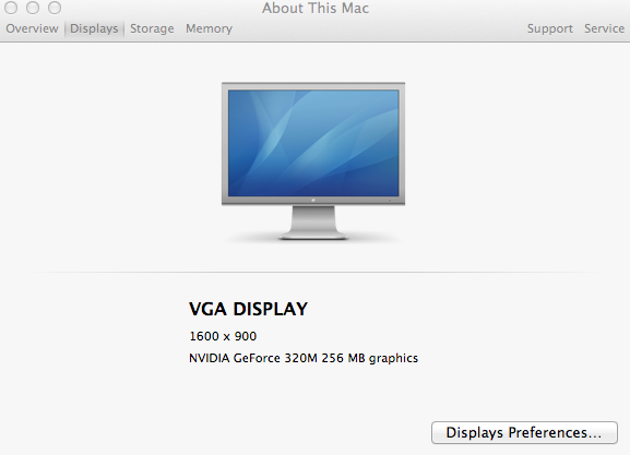

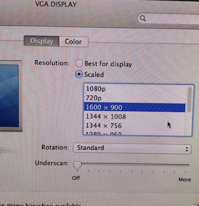

I did shut down and then slide the dongle carefully, then booted up and all was well first time as shown in the photos above.
My display is labeled as a "VGA Display" @ 1600 x 900 seems to be the best fit for my needs.

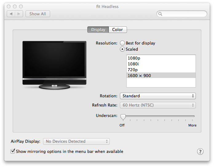

fit-Headless does the job for me
Let us know how you progress with the fit-Headless from CompuLab.

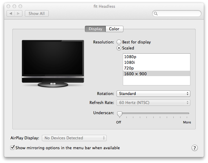

Well, it couldn't work any better - there's clearly some 'intelligence' within the adapter since it provides a device identifier to OS X, as you can see in the attached Display Preferences (it's 'named' in the window's title bar).
The Mac Mini recognises the 'device' on restart, and Screen Sharing is a pleasure to use - very smooth. To be honest I think I'm now getting the benefit 808? described with his home-made VGA/HDMI adapter. The Mini can finally stay headless and get relegated to the garage 🙂

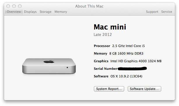

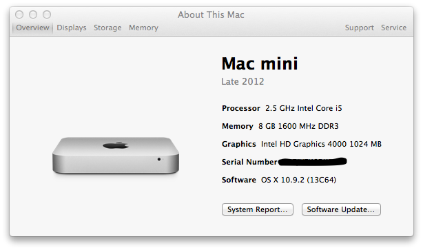

Just in case the behaviour I've experienced and described in this thread is due to the type of graphics adapter in my Mac Mini, I've also posted the (high-level) About This Mac property sheet for my Mini so other readers can see the details.
