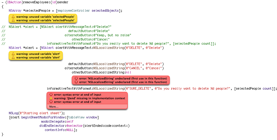

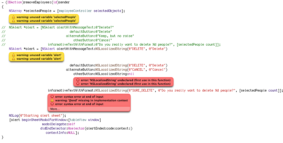

I am working my way through Cocoa Programming for Mac OS X and have run into a major stumbling block. I've attached the screenshot from my program. Basically, I replaced a portion of one method with something almost identical, but the program no longer runs. Take a look at the attachment - can anyone see where I went wrong?
Mahalo in advance for your assistance,
HawaiiMacAddict

First of all, the following line is probably wrong.
Code:
otherButton:NSLocalizedString:nil
I don't know a lot about localized strings, but you're probably going to have to do something like this. This is uncompiled, so it may not be correct either.
Code:
otherButton:NSLocalizedString(nil, nil);
Secondly, you forgot a close parentheses in this line.
Code:
informativeTextWithFormat:NSLocalizedString(@"SURE_DELETE", @"Do you really want to delete %d people?", [selectedPeople count]];
Aloha white89gt,
Thanks for the head's up on the missing paren. As for the first comment, I used nil in the commented out section (what was there previously) and it worked fine. When I completed the localization section, I had to modify the code. Instead of deleting the existing code, I simply commented it out and entered in the new code from the book. I also imported the Foundation class to the MyDocument.h file, but got the errors noted in the attached file.
HawaiiMacAddict
