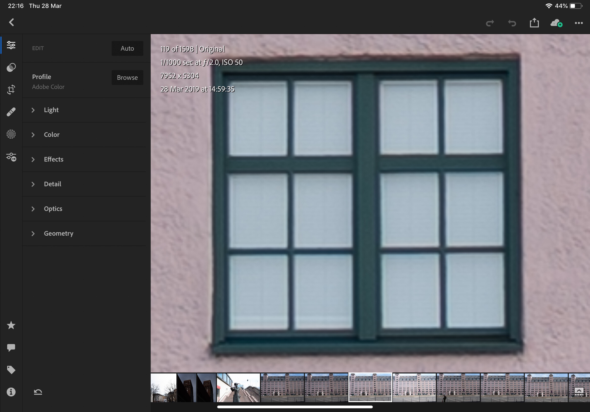

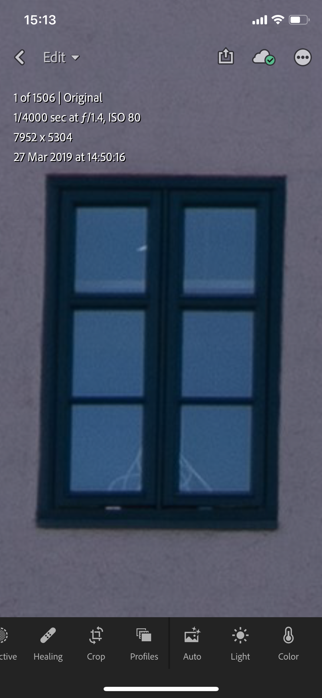

I’m kind of confused...

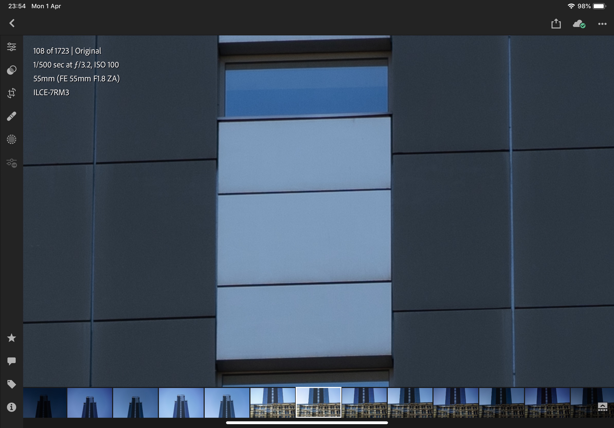

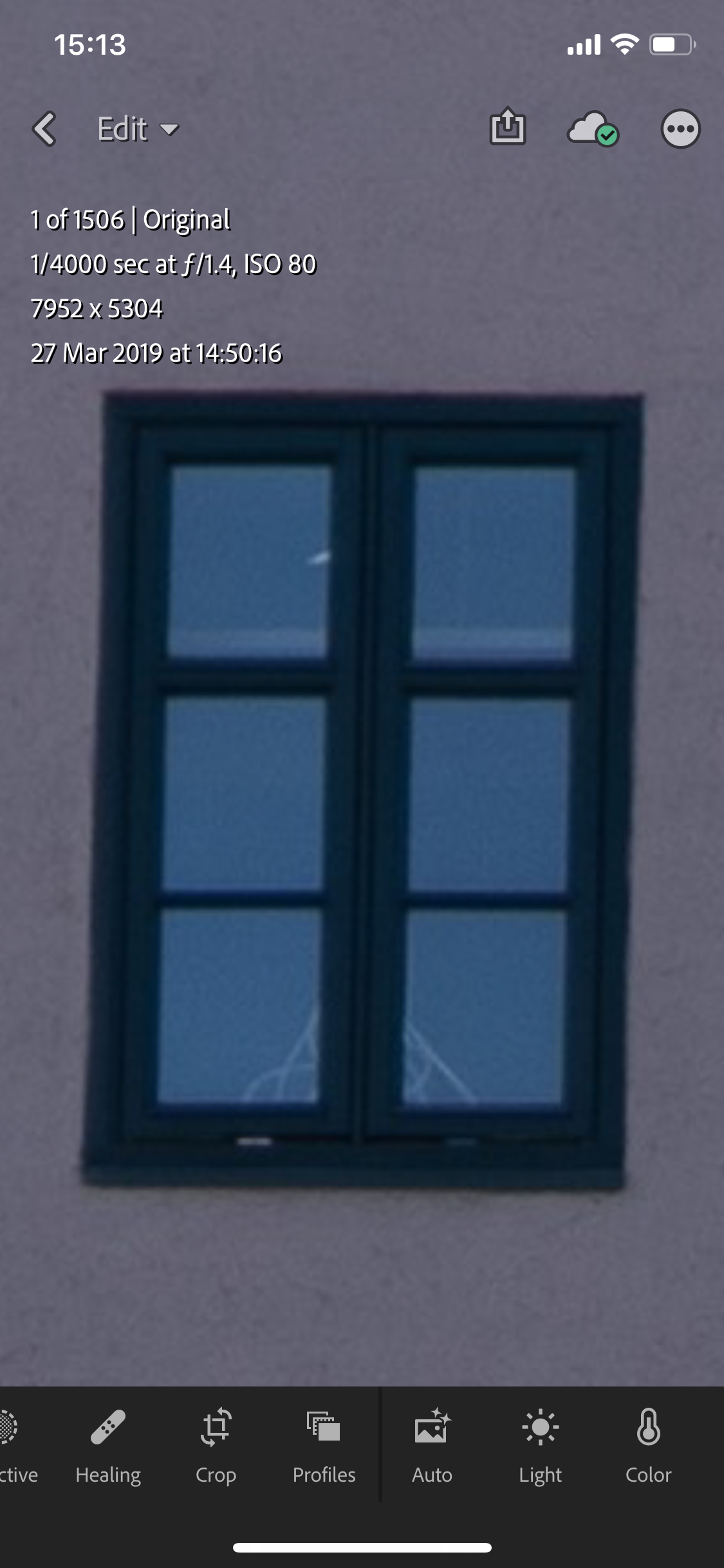

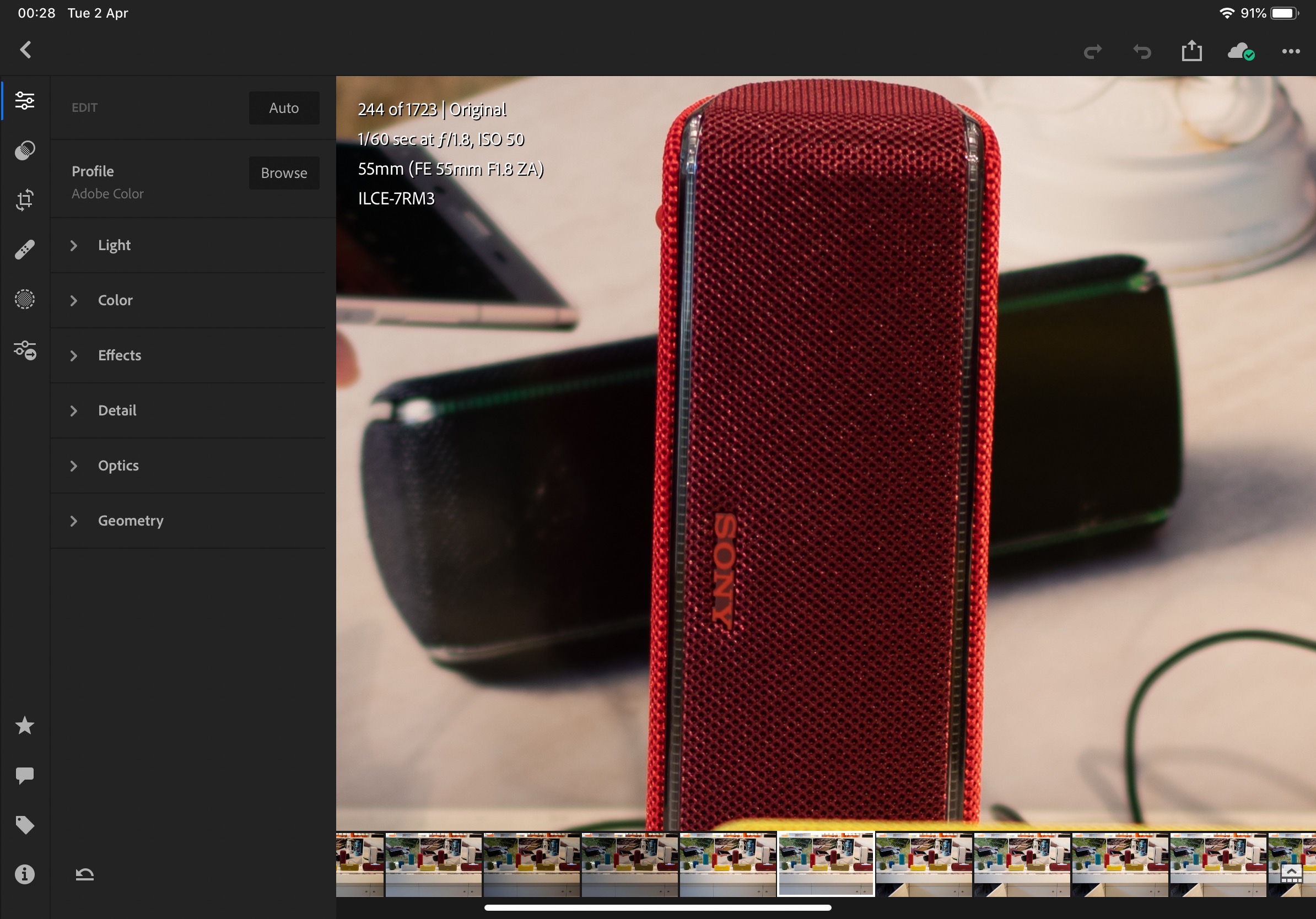

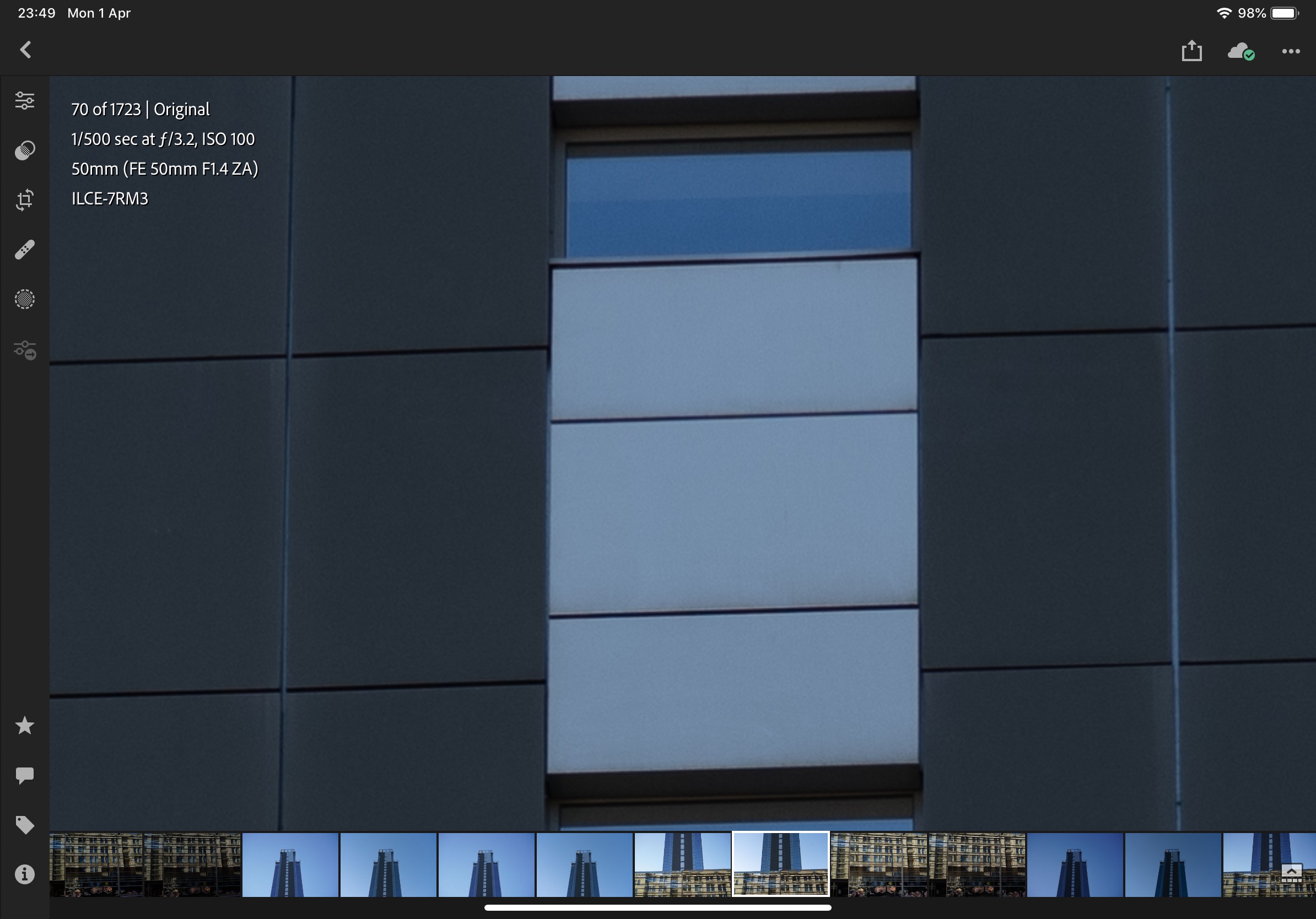

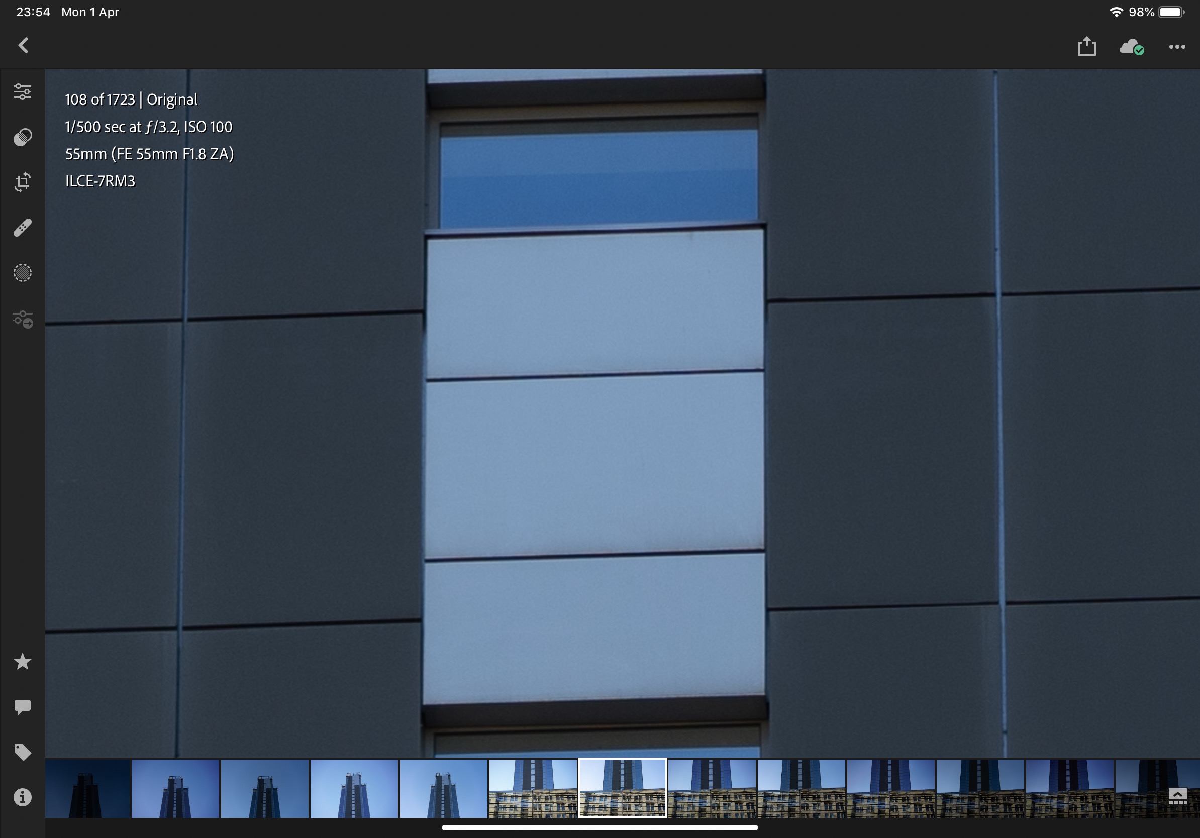

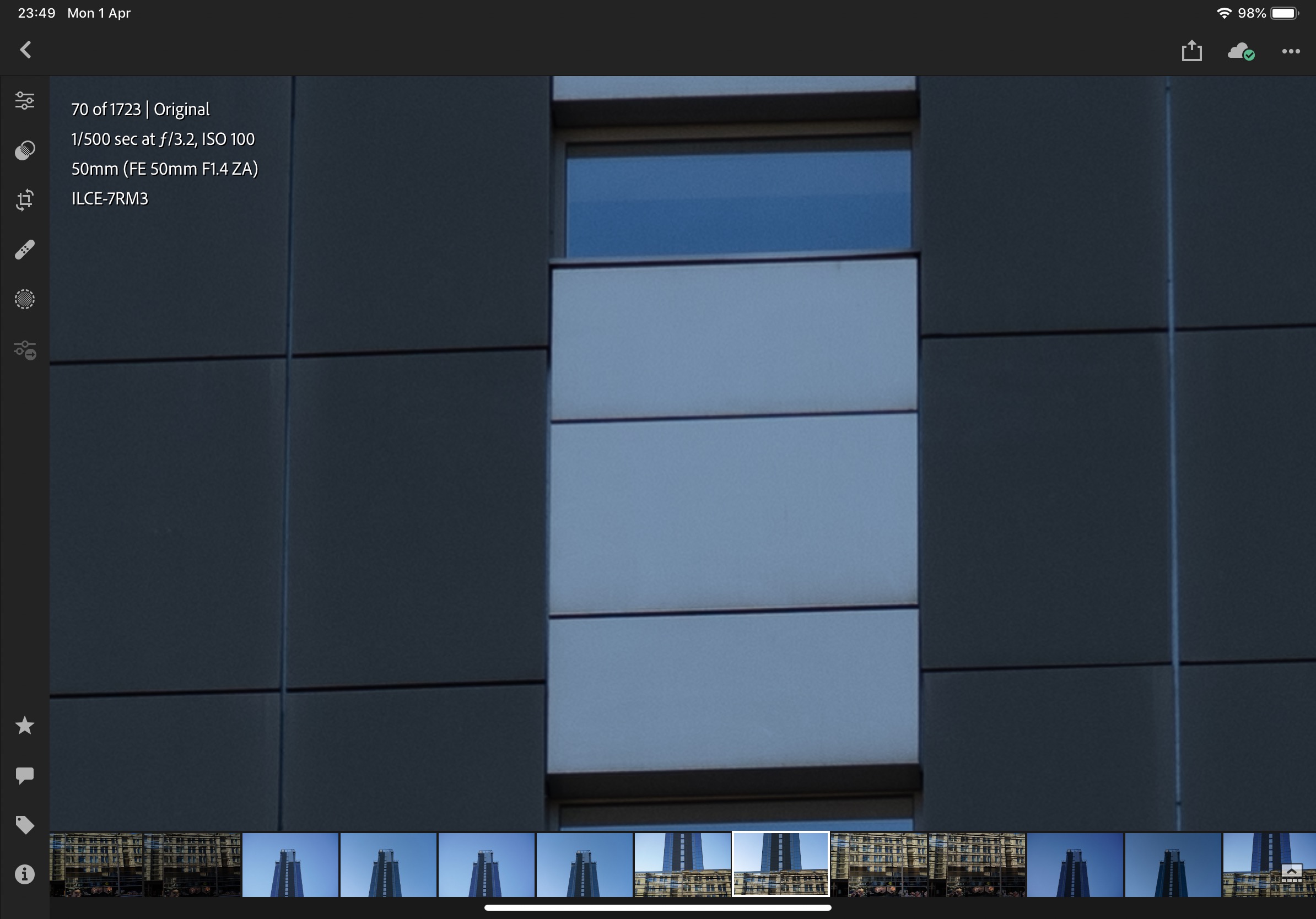

I used to use SEL55F18Z with my A7R3 and I loved it. I could take pictures @ ISO 1000 in dark environments and got vietually no visible noise (see the attached image).

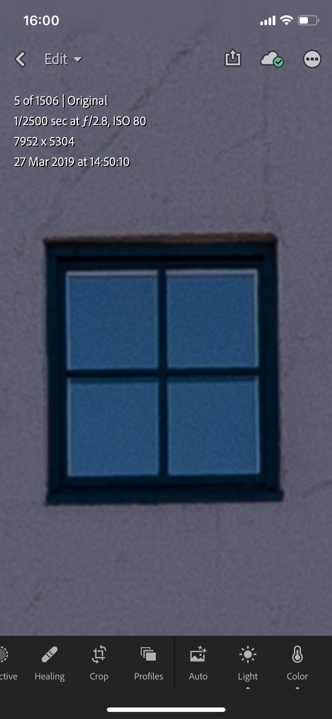

Now I’m testing SEL50F14Z and I cannot get rid of ISO noise even @ ISO 80 in daylight (compressed .ARW) on the same camera, same settings.
What is/could be going on?

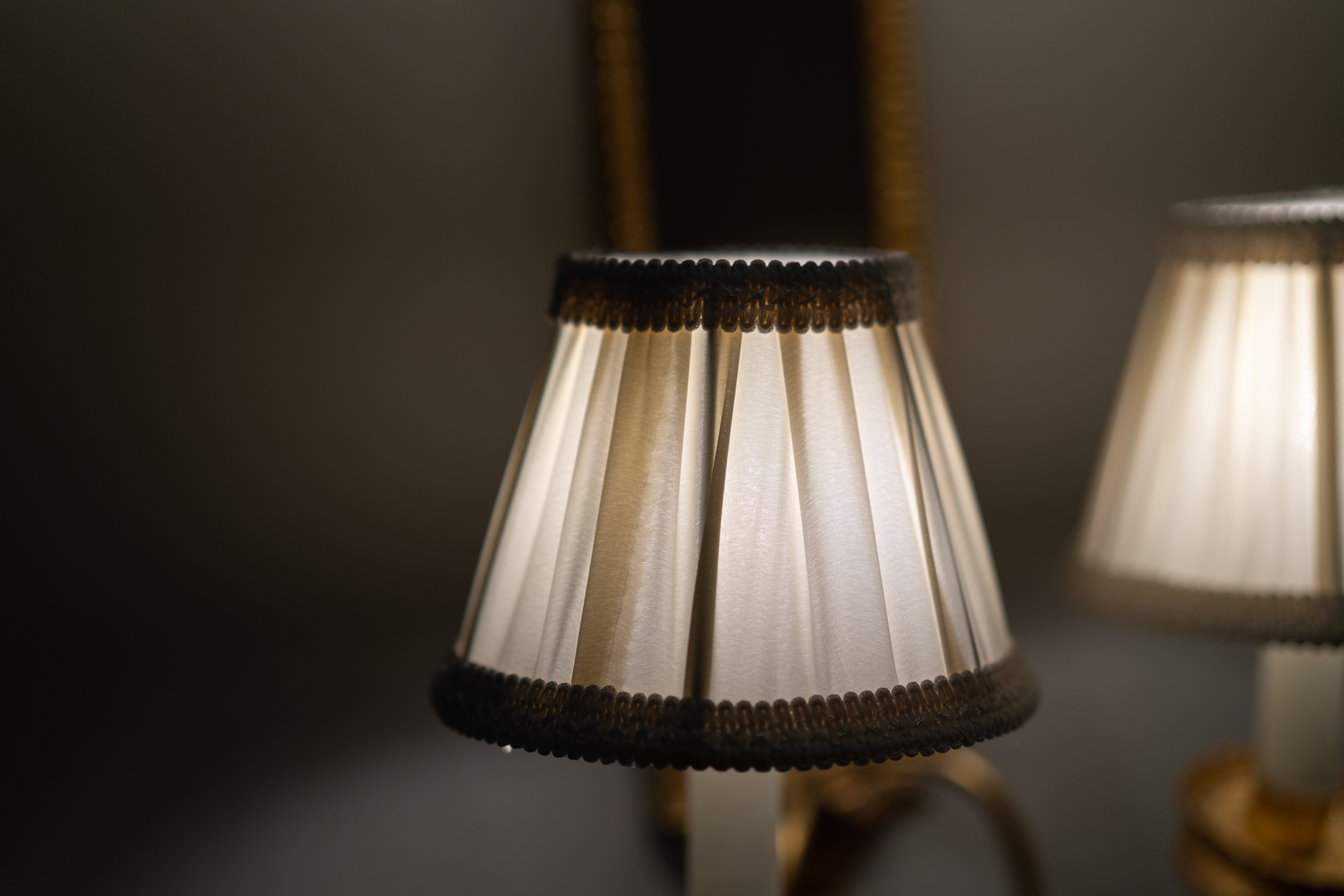

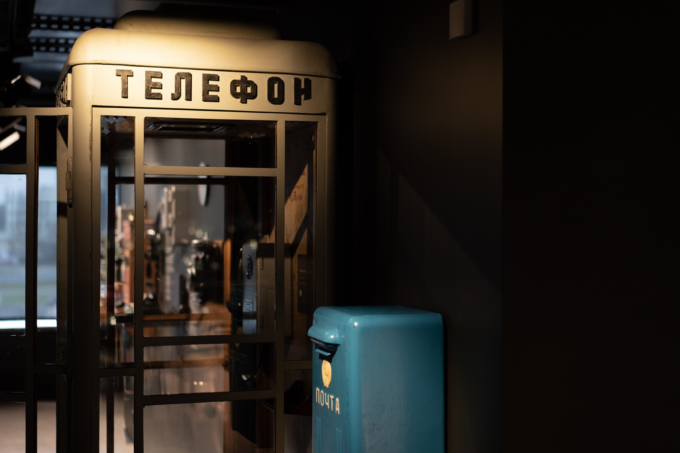

The first image indoors is with 55mm @ ISO 500

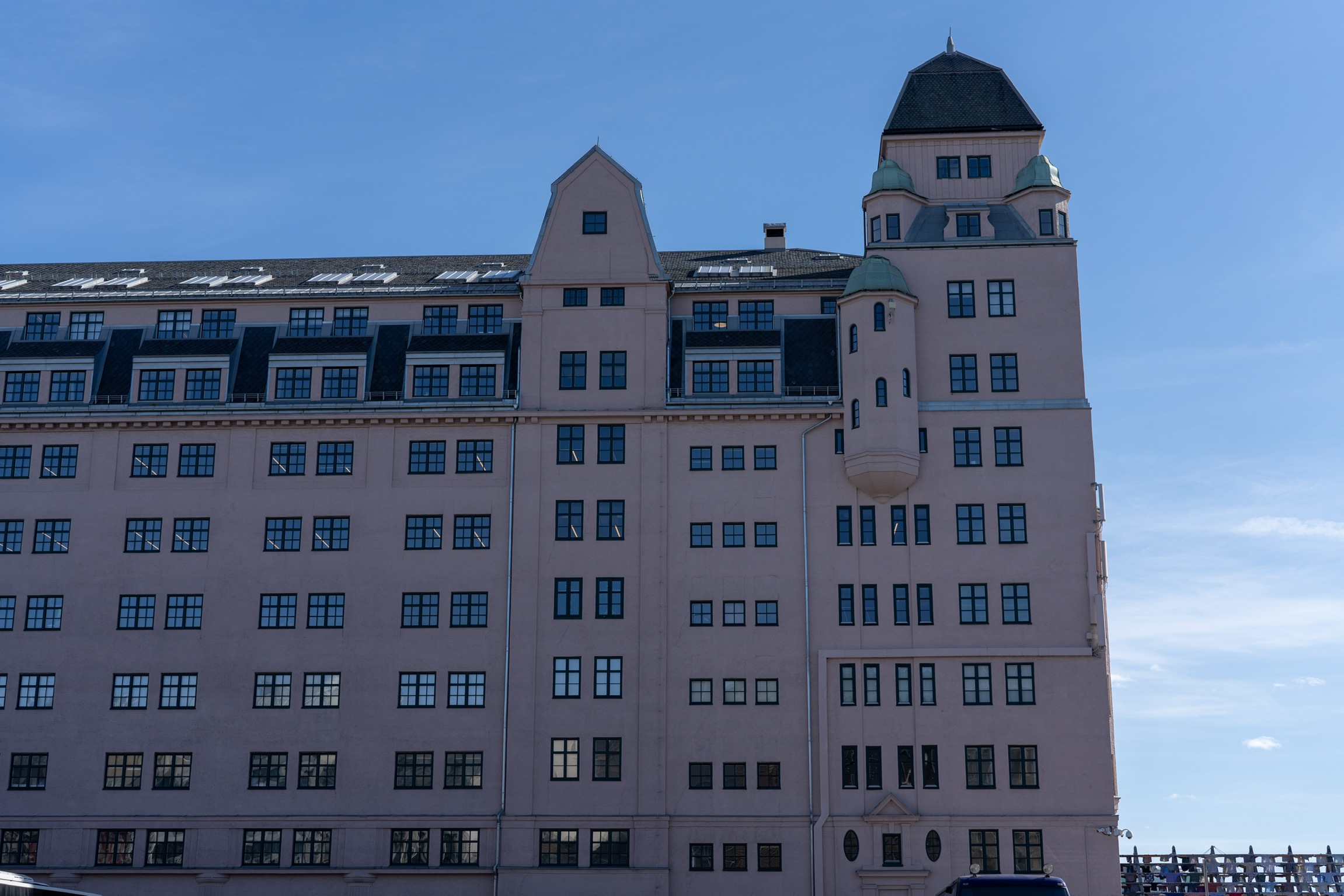

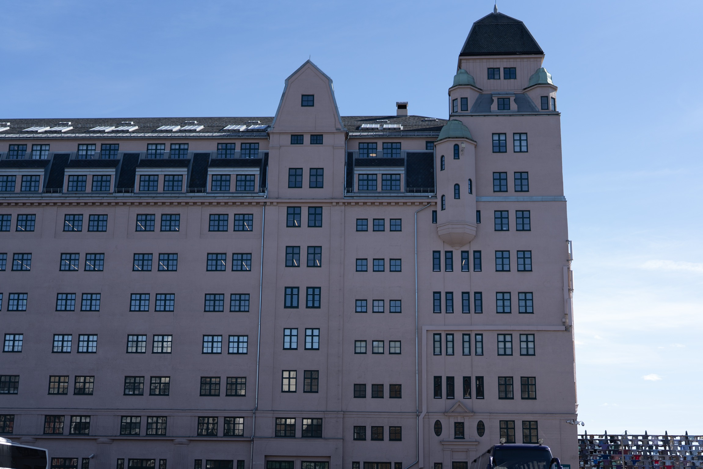

It's hard to say where your screen shot is from since the windows kind of all look the same. But at f/1.4 I'd be inclined to say that the image isn't noisy per se, but that screenshot area is just OOF a bit. I think if you'd shot with a higher ISO and f/stop you'd have more sharpness throughout.
I've also experienced graininess at odd times with very high SSs. I would say the settings are the issue, not the lens.
Well based on the angle of the building it's clear that you were not perfectly square to the building. (No judgment, I shoot like a drunk sailor so much that I moved the Transform panel higher up in LR so I could get to it faster! 😱 😀) But even at 2.8 there is still a fair margin of error for DOF issues based on where your focal point was.
Is there *any* spot in the image that has true sharpness? Also, how many MP is this camera? If a really high MP, are you new to it? Sometimes you need to view at 50-75% to judge sharpness on a high MP camera. I shoot with a D800 and there is an expectation adjustment based on resolution.
The other thing to consider is that with a new lens/body combo they might be mispaired and you might need to microcalibrate the lens to the body.

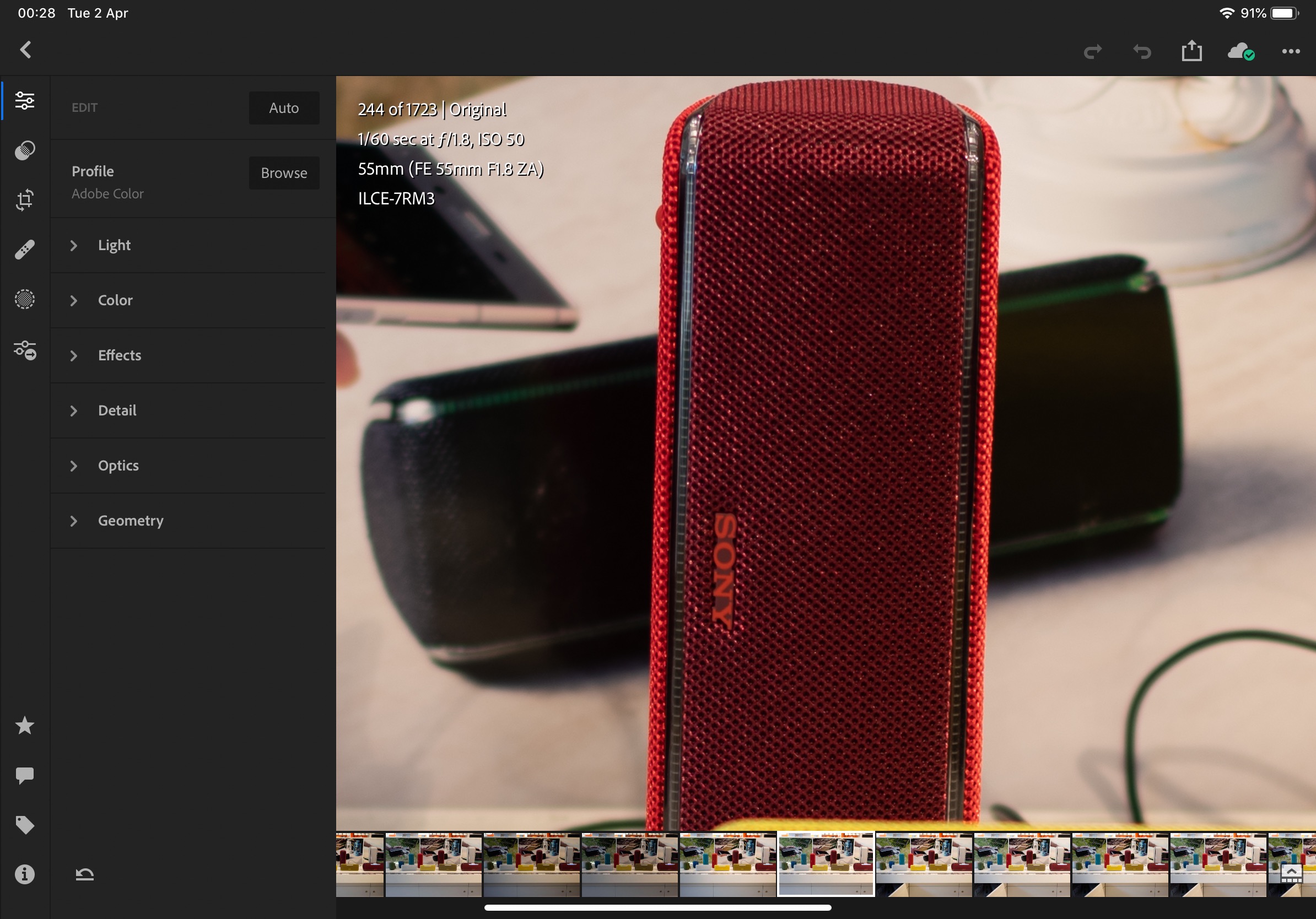

42Mpix. I am used to this camera body. And I was used to a combo with SEL55F18.

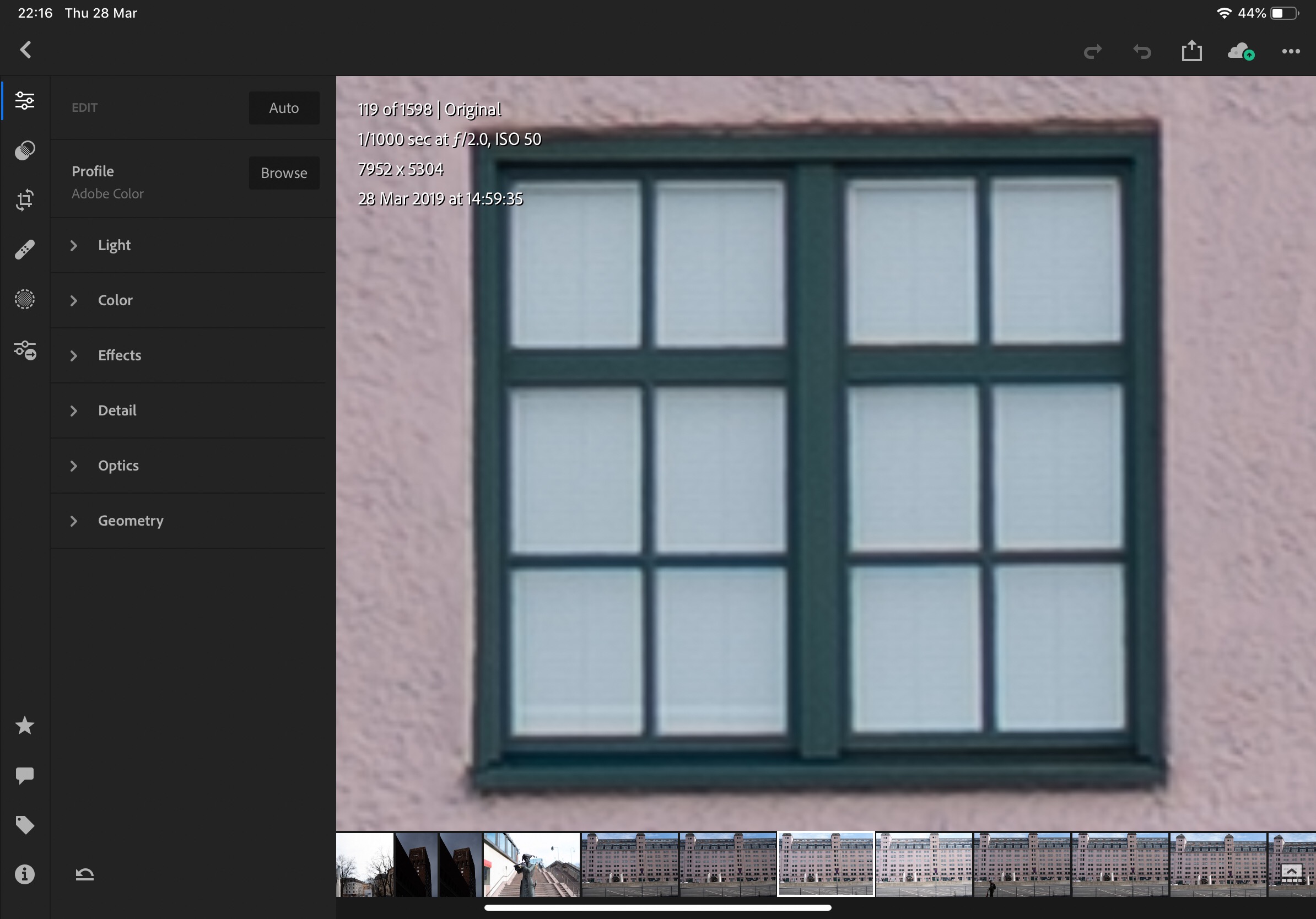

[doublepost=1553700043][/doublepost]I have tested another images with ISO around 250. And focus on a lit round clock. That was night, however. Same grain in the focus area.
To me it looks like a DOF issue which could be either than you need a smaller aperture or that the lens needs to be calibrated.

I don’t think it is. I think it is showing the difference between the Zeiss 55mm which is widely regarded as phenomenal and this one which is a more budget friendly option.
I thought it was softness rather than noise.
Stop it down to F5.6 to F8 and see but the lens wouldn’t cause more noise at a given iso.

Overall image resolution seems not so high if compared to the 55mm, and it’s softer in corners. Seems softer to me in general... Produces orange fringing at some scenes. Maybe I just do not know how to take pictures with it. 🙂

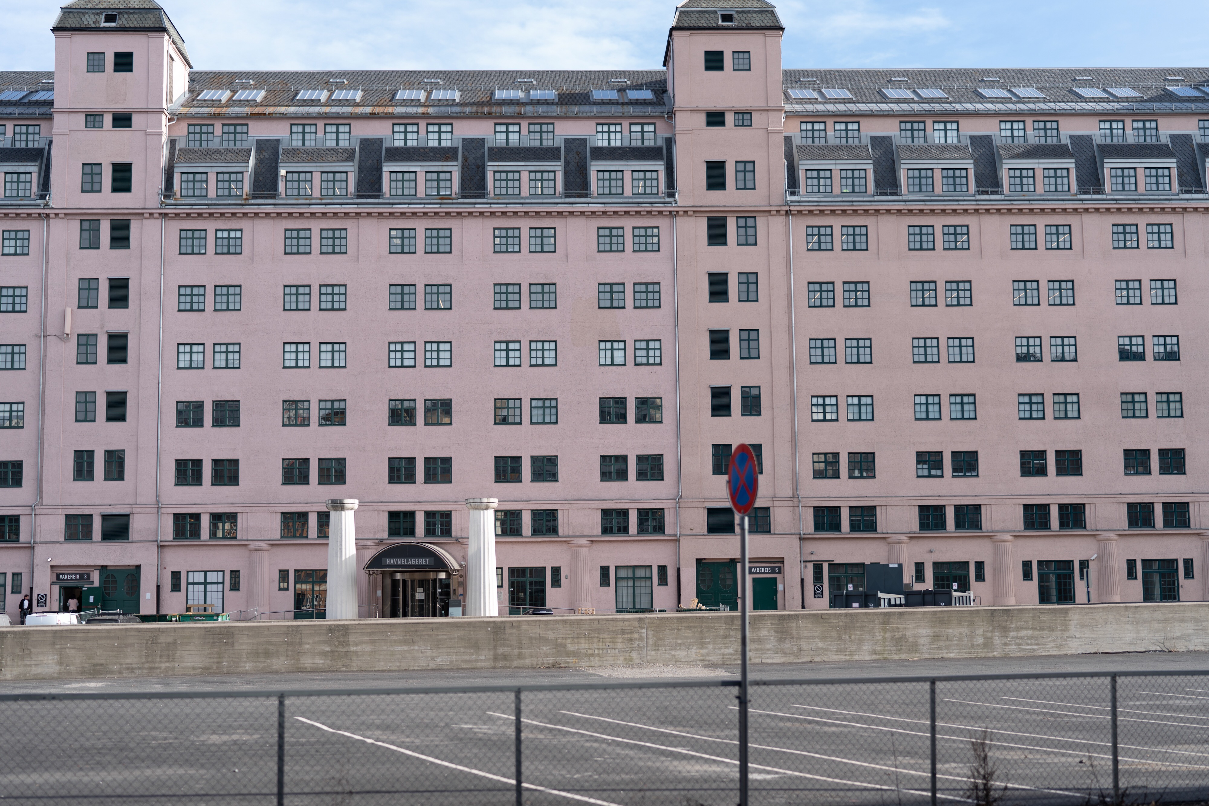

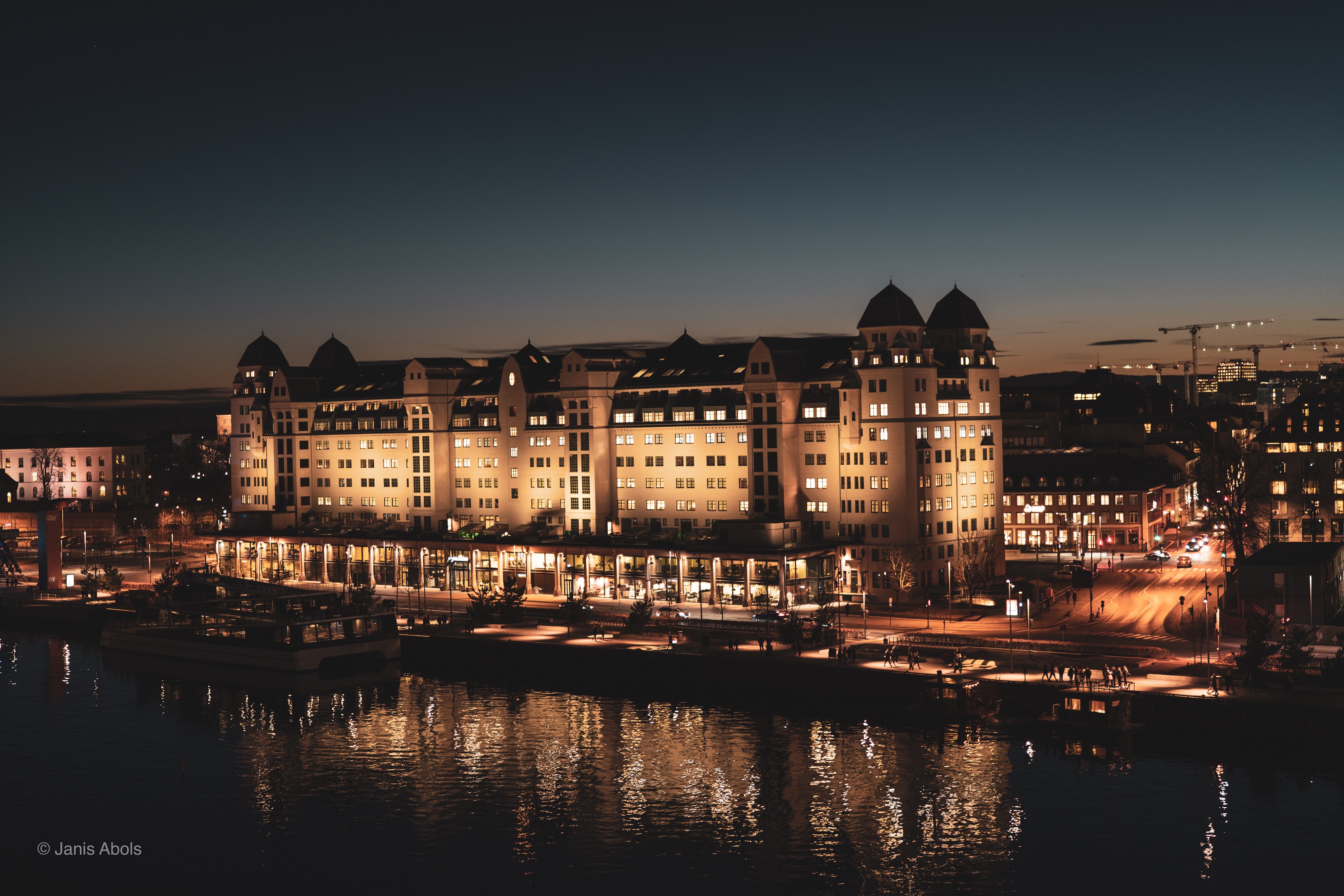

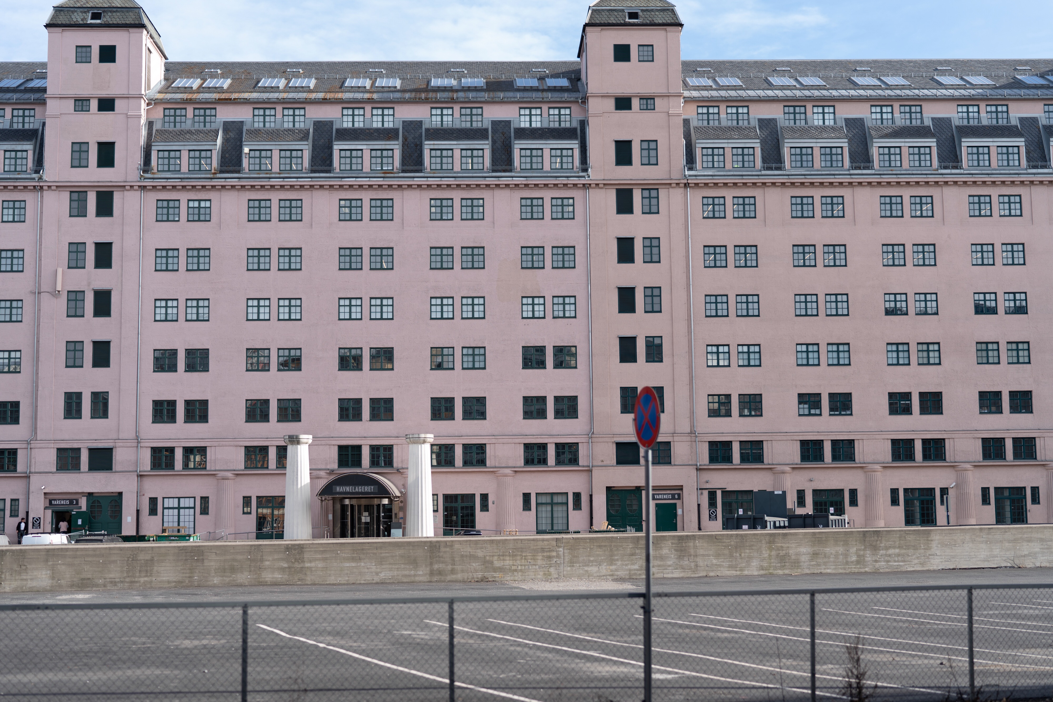

Well ... Here is one from my evening walk. A bit post-processed version. Same building.
I agree with Ken that it looks more like softness vs. noise (which is what I said originally, but nice to have confirmation). But that said, in your original image, the building is in the shadows - the sun is obviously behind the building. And noise typically lives in the shadows. So I'm not inherently surprised that you find it "noisy" in that specific image.
Also, how large do you ever intend to print any of these images? My 36mp D800 can look noisy, but I rarely print anything larger than 12x12 for a wall frame or scrapbook and my images are all perfectly sharp in print. So let's also put things in context. 🙂

I can’t really blame it for being decentred or anyhow deffective. It just seems that lens resolution is not as I would like it to be and is in contrary to what reviewers say.

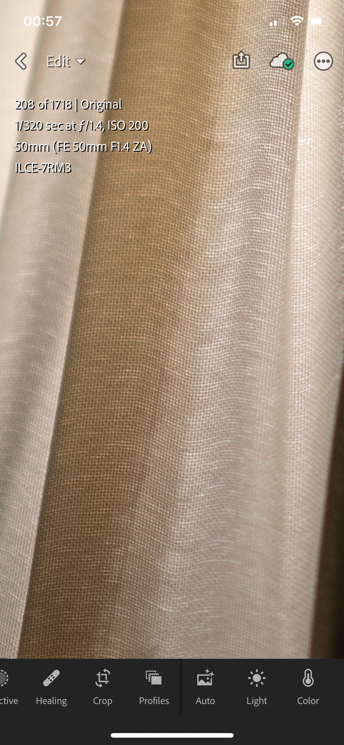

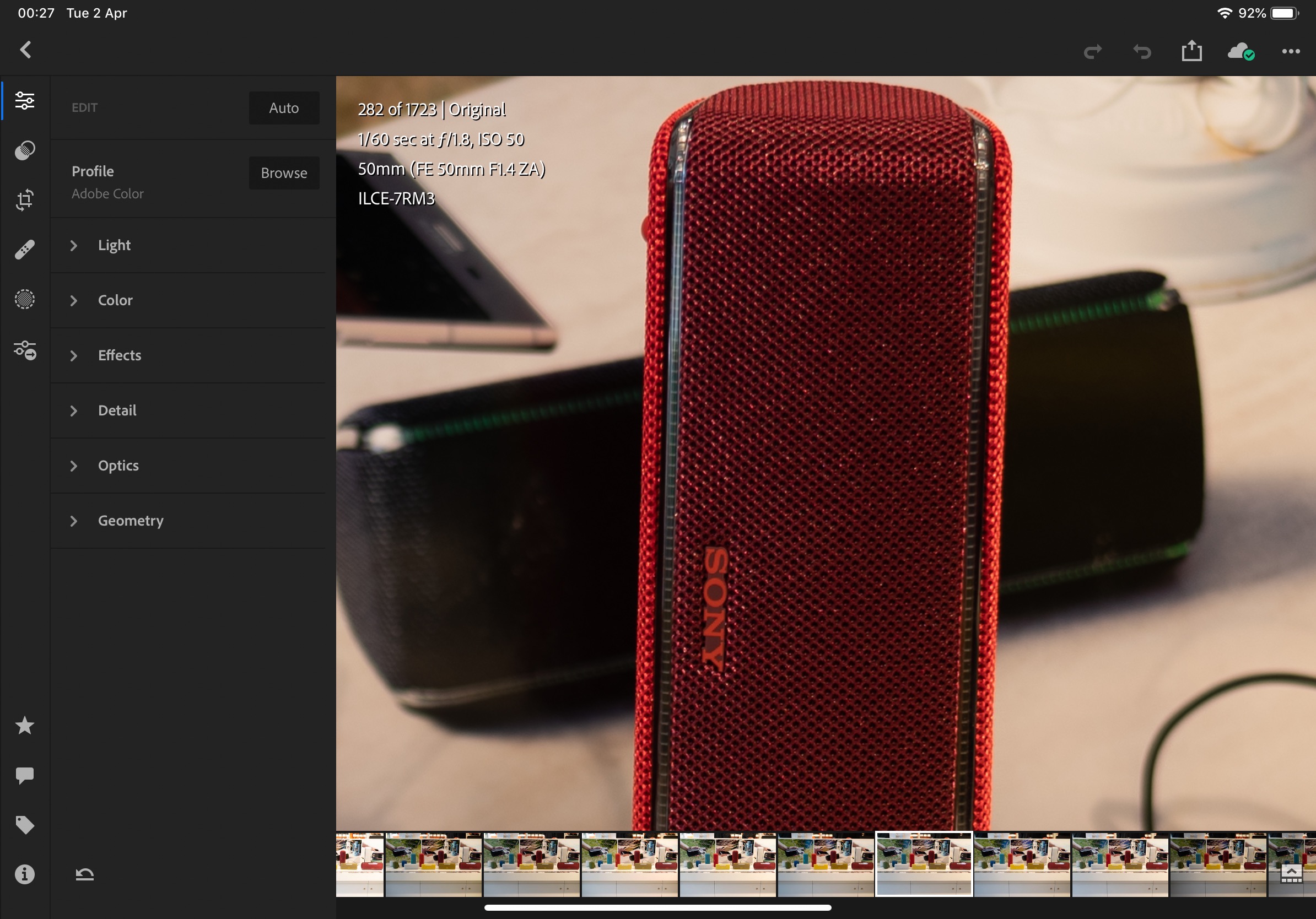

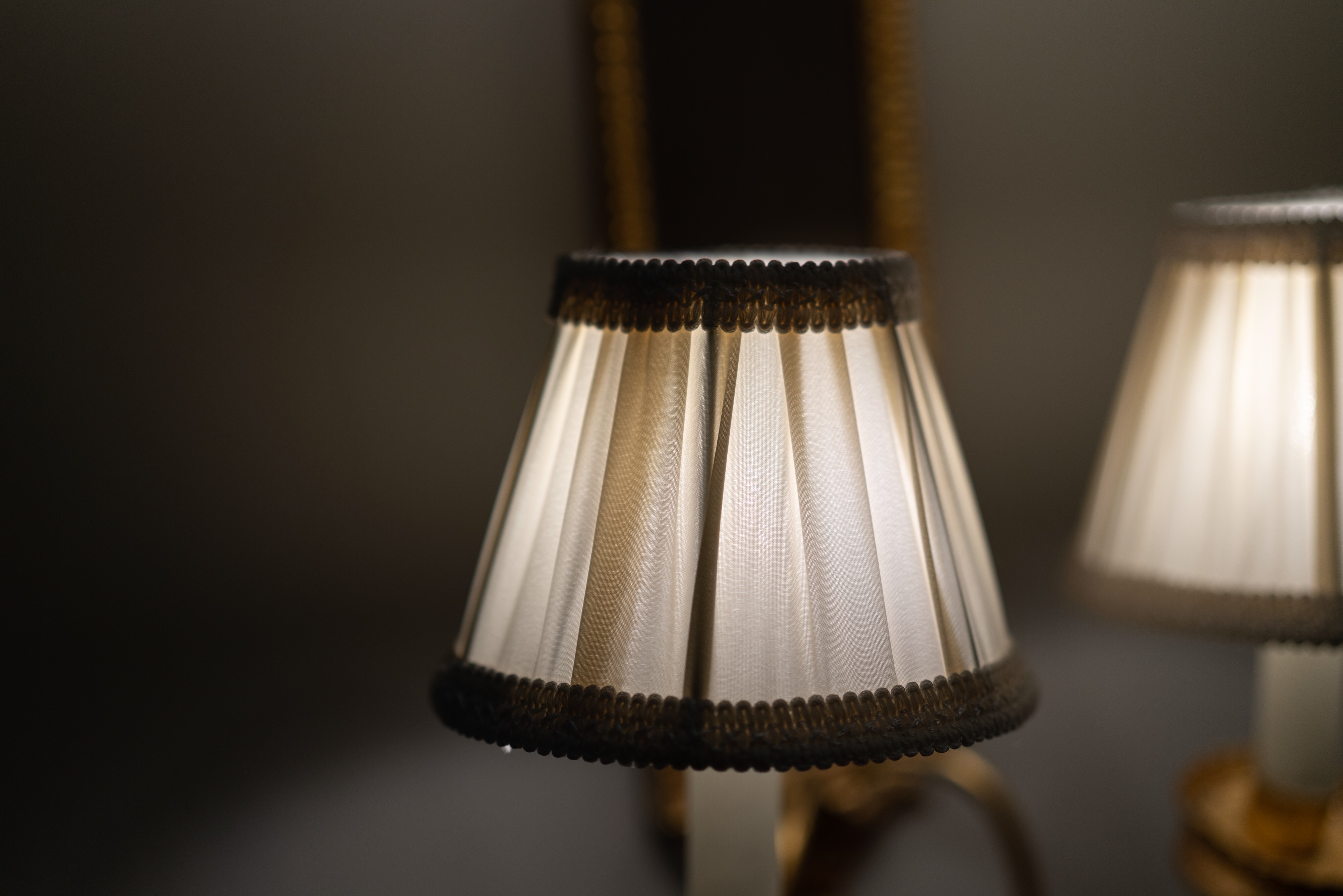

On the other side some close images are sharp and without any noise (see the attached image) OOB.
This lens is also supposed to be a bit different in corner/center sharpness at some wider apertures. 55mm version has better uniformity in center/corner sharpness. Also, light transmission should be lower in comparison to the 55mm (as reviewers say).

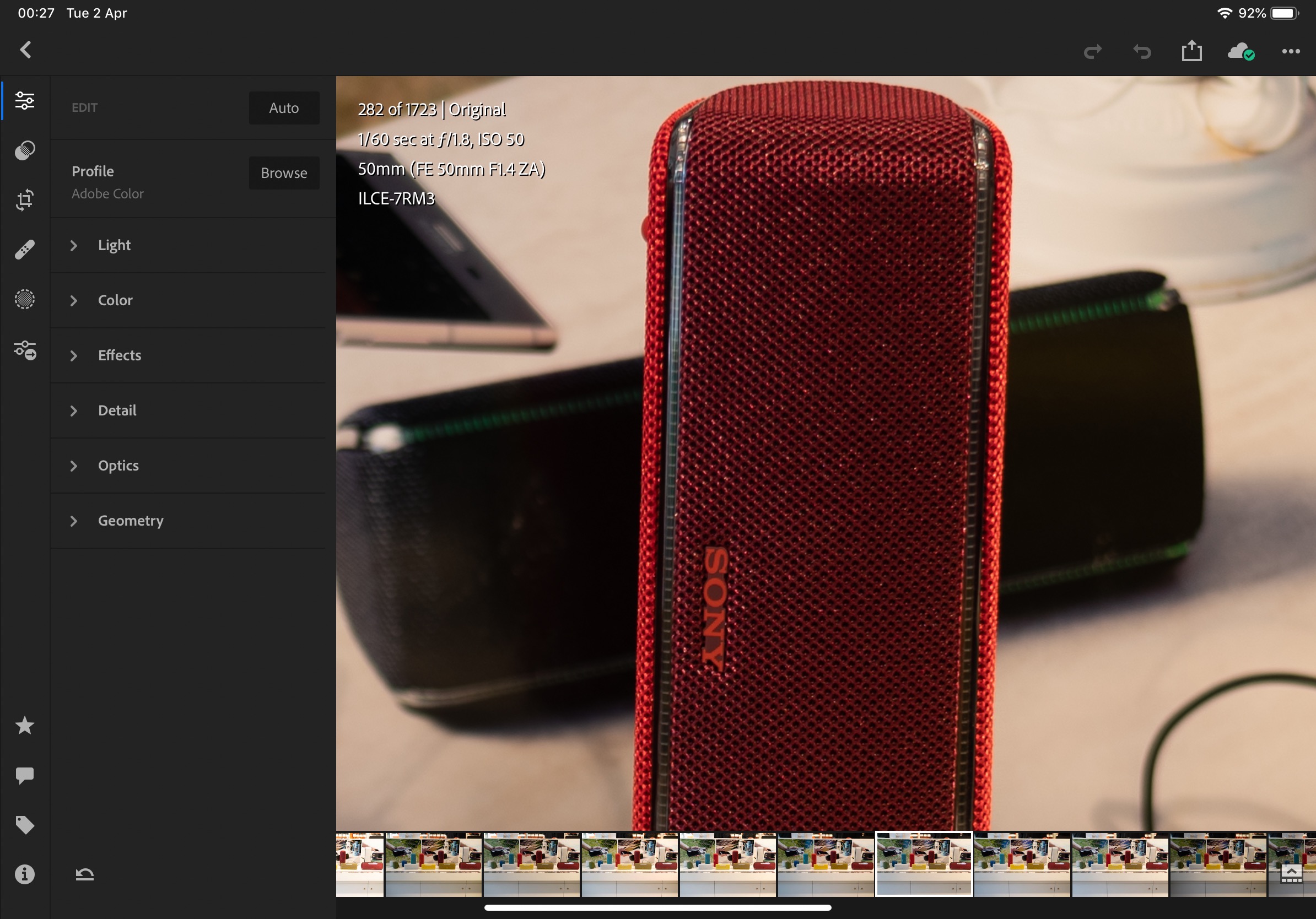

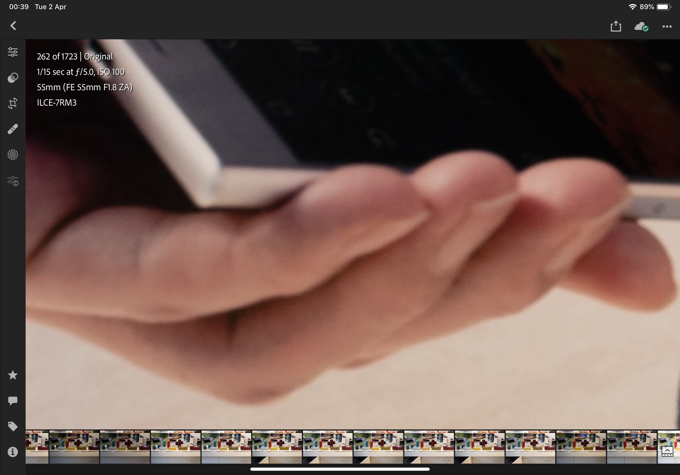

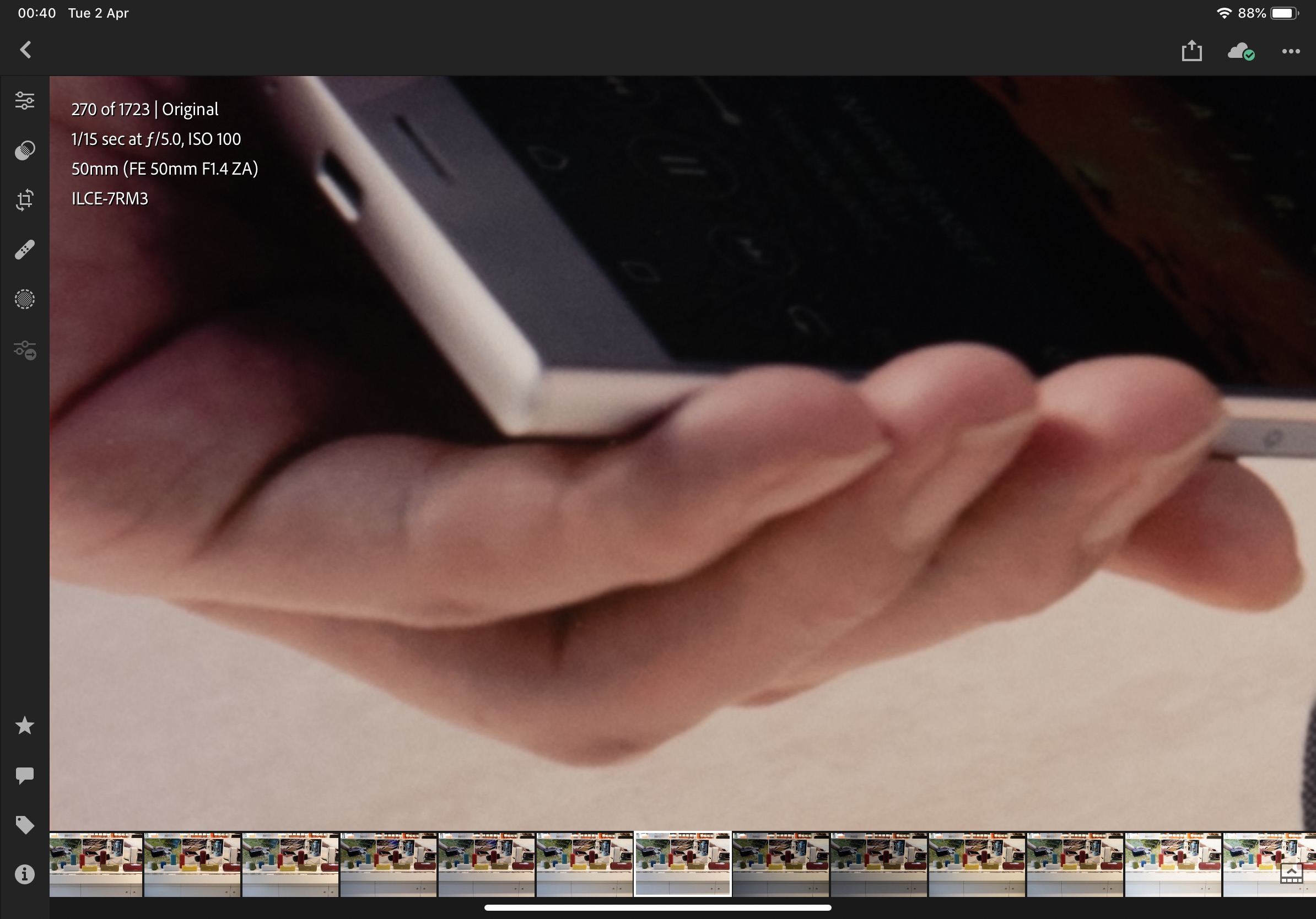

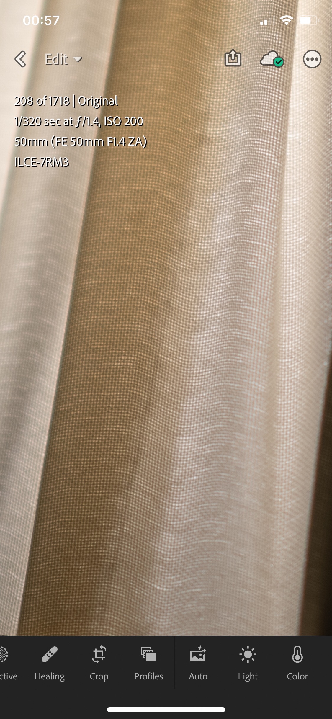

Just for a quick update: I did some tests for the same scene with uncompressed/compressed RAW, auto/manual focus w/focus peaking. Everything looks pretty the same.
Tried to compare to the iPhone version. Well, not really useful results as the phone predictably produced notceably worse results (even in .dng)
Not really sure what happened but I got some sharp images out of this thing today. Even some window/building pictures looked better (see the attached file (resized version) and crop). Well, I had DRO switched off for some time, but that probably should not affect RAW anyway.
[doublepost=1553810032][/doublepost]P.S. The crops are bexind pixel level.
[doublepost=1553810742][/doublepost]This looks pretty sharp to me @ f/1.4 (unedited but converted to .jpeg)

View attachment 829130 View attachment 829129 Not really sure what happened but I got some sharp images out of this thing today. Even some window/building pictures looked better (see the attached file (resized version) and crop). Well, I had DRO switched off for some time, but that probably should not affect RAW anyway.
https://www.dropbox.com/s/je8jjwf3tw253qs/Photo 28-03-2019, 15 11 25.jpg?dl=0

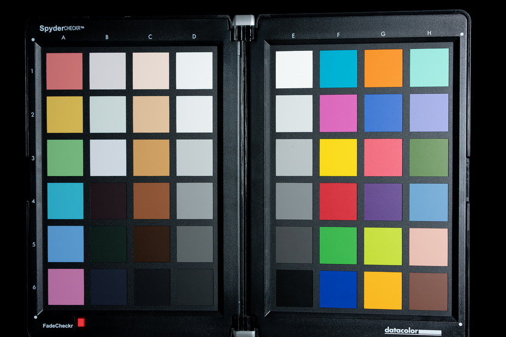

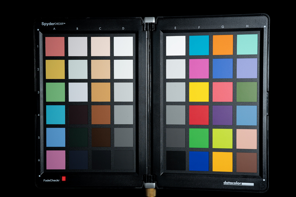

I took some pics of a color calibration chart with a Sony A7RIII and 55mm f/1.8 lens and 50mm f/1.4 lens.
For both: 1/125th sec, f/5.6, ISO 100. Uncompressed RAW. All light came from a strobe and the strobe output was the same between lenses. Taken on a tripod and I did my best to not move the tripod when changing lenses. Used a wired remote to trip the shutter in both cases.
Zeiss 55mm f/1.8 lens
Sony 50mm f/1.4 lens
Of note as it relates to your original post, there isn't excessive noise with either lens and I can't see a difference between them.
For this particular series, the 50mm lens was sharper (the "Spydercheckr" in the upper left for example). However I wouldn't hold this up as proof one way or the other.

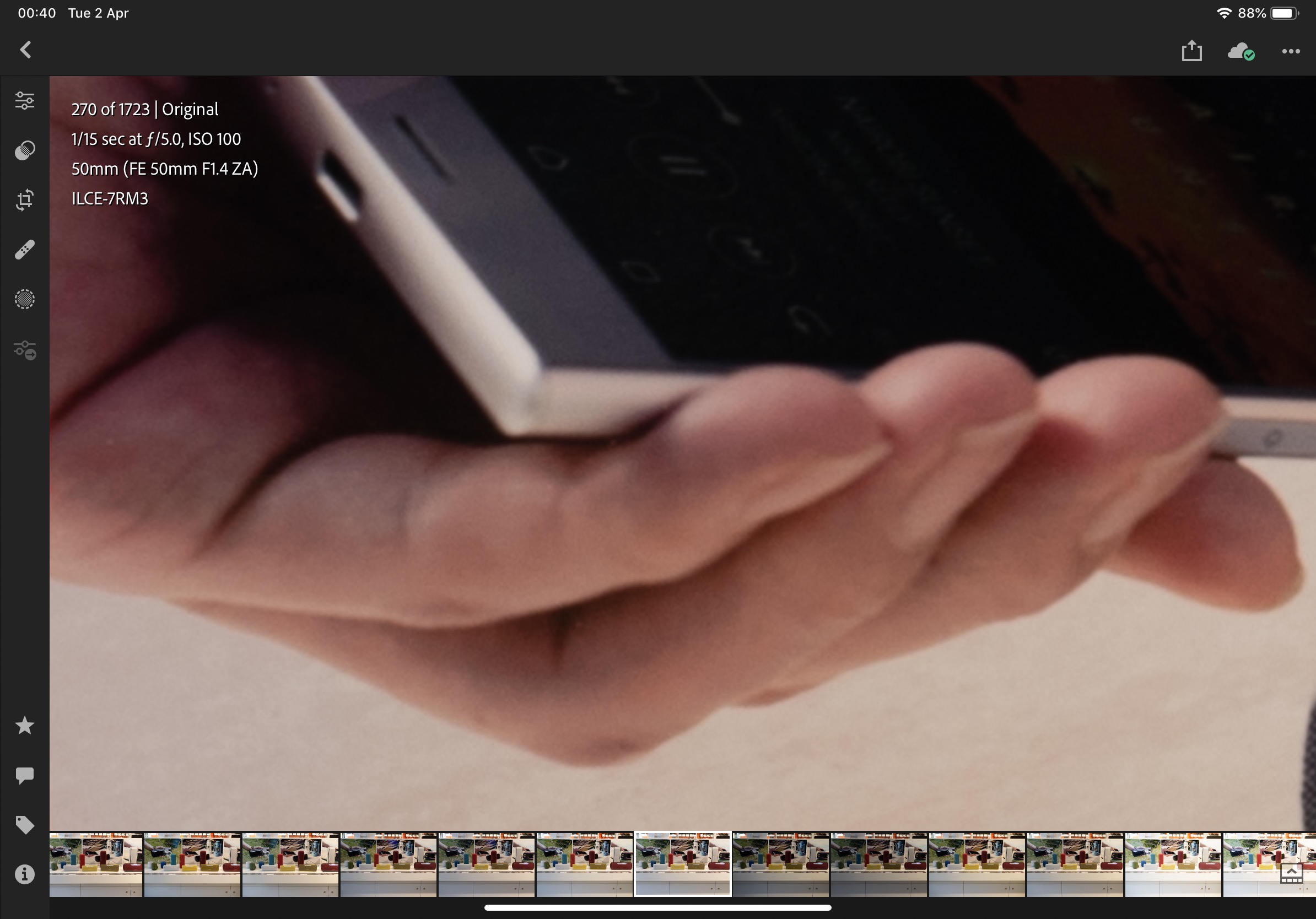

I downloaded the RAW files from you dropbox.
They both look fine. There is no significant noise that I could see in either image at 100%.
Your crops in the post I quoted are at >100%. They are thus not helpful in an evaluative sense. 100% is 100%. Anything > 100% means you are trying to see detail that is beyond what the sensor captured (even in a theoretical sense). Of course there is going to be "noise" in these crops--you are hoping to see detail that is beyond what the sensor captured. It isn't there and can't be there. Because it was beyond the limits of physics (based on the abilities of the sensor and focal length/optical characteristics of the lens used) to capture it. CSI and Law & Order notwithstanding, the highest IQ you can ever hope for in the real world has a hard limit at a 100% crop.
For real world use, both of your RAW images with either of the lenses are perfectly usable. There is no noise in either of them that would be apparent with any reasonable output for the images.
You are pixel peeping. The "flaws" you are seeing are not ones that will be evident with output appropriate to the focal length of the lenses you are using. You have an awesome camera. You have an awesome lens (either one).
I think that some of the flaws you are seeing aren't lens-dependent but are instead related to light and/or technique. Digital sensors have a problem with underexposed areas. It's a problem related to signal-to-noise ratio. The lower the light in an important area of an image, the more noise there is there compared to actual signal. Exposing to the right on the camera histogram for the important areas increases the ratio of "important" or "significant" data that is captured compared to the unimportant "noise".
Sometimes you can adjust settings related to exposure at the time of capture to fix this (more open aperture, longer exposure (sometimes requiring a tripod), higher ISO (accepting the loss in image quality which can result)). Sometimes you just need better/more light (perhaps using a speedlight or a strobe). You actually noticed this in one of your earlier posts--the images looked better with the 50mm lens in better/stronger light.
There *is* a difference in light transmittance between the two lenses with the 50mm transmitting less light at a given aperture than the 55mm. But I don't think it's significant enough to explain the differences you were reporting.
Thank’s again!
You’re right! - ‘Case closed’ 🙂
