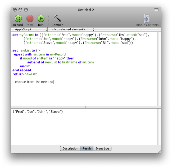

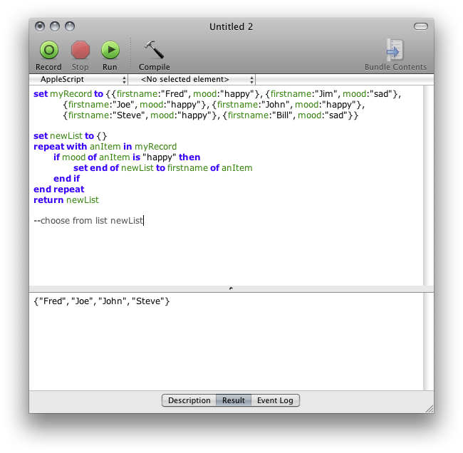

Hi. This is an example of the problem I am trying to solve. I have a set of records with two fields such as {{name:"fred",mood:"happy"},{name:"jim",mood:"sad"},{name:"Joe",mood:"happy"}} what i need to do is create a "choose from list" dialog box that takes it list of options from this record list for all records where mood = happy. then I would know who has the mood of happy and could then change it to something else. i hope this makes sense. thanks

Try this :
Code:
set myRecord to {{firstname:"Fred", mood:"happy"}, {firstname:"Jim", mood:"sad"}, {firstname:"Joe", mood:"happy"}, {firstname:"John", mood:"happy"}, {firstname:"Steve", mood:"happy"}, {firstname:"Bill", mood:"sad"}}
set newList to {}
repeat with anItem in myRecord
	if mood of anItem is "happy" then
		set end of newList to firstname of anItem
	end if
end repeat
return newList
--choose from list newList
