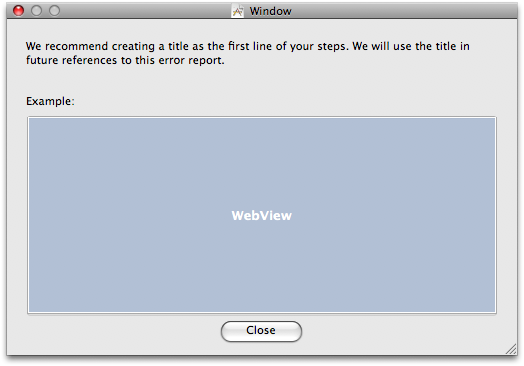

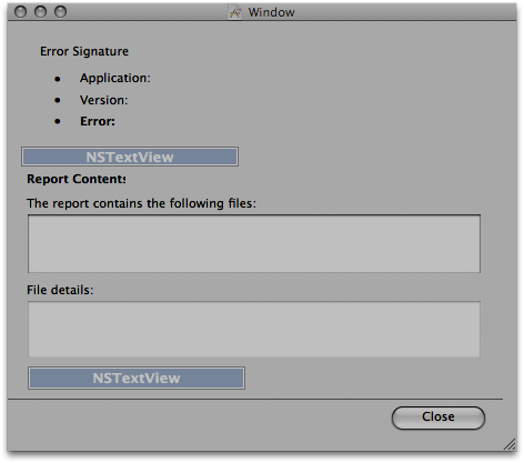

Screenshots are attached. DetailsController is the one that does not close. Example description closes.
Sorry, I meant the main nib window, where all the top-level objects are (Files Owner, windows, controllers, etc.). Sometimes weird bugs happen when multiple instances of a controller are created in a nib, so I just want to see if that could be the problem here.
Posting a solution on this thread since one was not forthcoming; make sure that in your custom NSWindowController subclass, you have connected the "window" property to the actual window in Interface builder.
The easiest way to do this in the most typical case, where the NSWindowController subclass is also "Files Owner" of the window's xib file, is to control-drag from "File's Owner" in Interface Builder onto the window, and then in the popup menu choose "Window" as the outlet.
