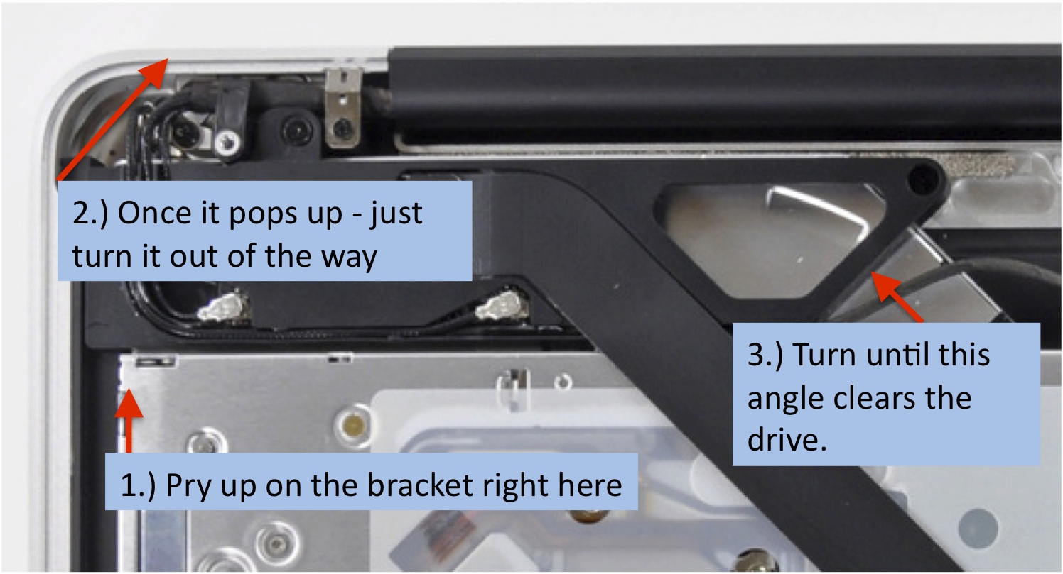

Hey OP, that screw on the optical bay bracket seems to be a very common screw to strip when doing a mod. Theres a post about it somewhere on this form, but it turns out, you may not need to remove the screw at all. Try and see if you can just rotate the bracket far enough to switch out the drives.
Edit:
I don't know why people keep suggesting he try and get this screw out... mine was put in by Chinese He-Man and adamentium blue threadlock
The goal is to remove the optical drive, not the screw and that can be accomplished quite easily by just turning the bracket...

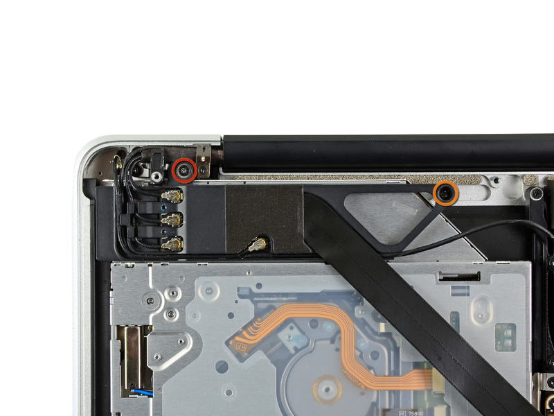

So, no jewelry/watch repair hominid will touch this MBP, so I have to do it myself. Yes, I, the one who screwed it up in the first place.
So, I'll get that screw extractor kit someone posted in this thread and proceed with great caution.
One question first: How do I identify, then procure a replacement screw in advance of taking the original out (and ruining it in the extraction process)?
Here's the screw of which I speak (circled in orange, not red):
yILuc15KUC2TLdLi.large
and mine is a 15" late 2011 MBP.
Edit:
Woah, let me try this first before going in all kamikaze style. Thanks

My son stripped the same screw on his 2010 MBP. My husband used the extractors referenced earlier to get it out. I tried to get it out but I wasn't strong enough. My son was able to flex that section up and not have to remove it. If you take out the red screw on it is fairly easy to flex that section up and pivot it around on that screw just be careful with the antenna connections.
