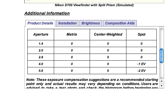

this is from Katz Eye's page:

Short answer on the whole metering question with a Katz Eye: if you're fine leaving highlight tone priority on all the time and don't use spot-metering much, then it's a non-issue. Partial, Matrix, and Average all work fine (I almost always use Matrix, & switch to Partial when I only want to meter on the subjet).
The split-prism & microprism confuse the spot sensor a bit, but I hardly ever use it & certainly haven't tested it extensively. The spot mode I found really useful (for landscapes) was the multi-spot on my beloved T90, but the 40D's single-spot was not one of the reasons I upgraded from the 10D.
