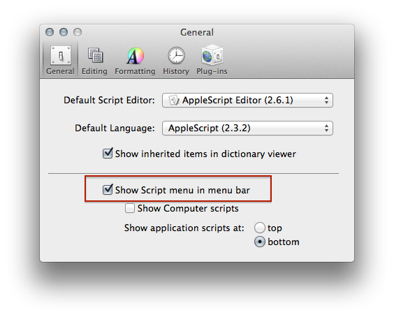

Great. Glad to hear it worked. When you enable the Show Script menu in menu bar option from the ScriptEditor Preferences window, you can save it in your Mail Scripts Folder so it's available from the Script Menu in Mail.
