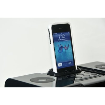

iPhone + Case universal dock adapter
I tired the dock extender and ended up switching to the LYCO Adapter (http://www.synthecept.com). It is a redesigned iphone universal dock adapter that allows me to dock my iPhone without removing the case. I have been using it for a few months and love it, check out the picture of my setup.
