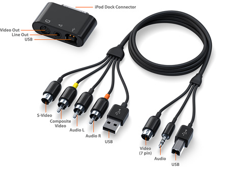

I picked up the SendStation PocketDock, which allows for 2 things… First, it's a very small dock connector. Almost the eat same size as the previous dock cables before the iPhone came out, so it's a little longer then the new cable plugs.
On the bottom, two ports are included, one is a mini USB, and the other is an Audio Out. The Mini USB will allow you to charge AND transfer data. Plugging the unit into the iPhone brings up the "Not compatible with iPhone" screen, but it does work with my iPhone 3GS.
The Griffin AutoPilot has a feature where you can set the output level, and I was afraid the SendStation might not be loud enough with no level option. It is softer then the high setting on the Autopilot, but it still works very well. Once you turn the volume up on the stereo in the car, it's more then loud.
Using headphones with the audio out is a different situation. Since using the dock connector, the volume slider disappears on the screen, so there's no way to control the volume. It's always the same level, unless your headphones have a volume pot to adjust it. I picked up a small volume pot from my local Radio Shack for about $3.00. I still like my headphones louder, so this may not be something I use like this.
The unit comes with 2 cables, one is a standard 1/8" to 1/8" (or headphone to headphone) cable for using the AUX port on the car stereo, and the other is a 1/8" to RCA Left and Right stereo cable. Both cables are decent length and have a built on velcro cable tie on them.

the reason why you lose volume control is you are bypassing the iphone internal amp...im a headphone geek and i do this with my ipod and a small battery powered amp.
You NOT supposed to use headphones in the bottem, its a Line out...hook it up to amp or a pair of powered speakers.
