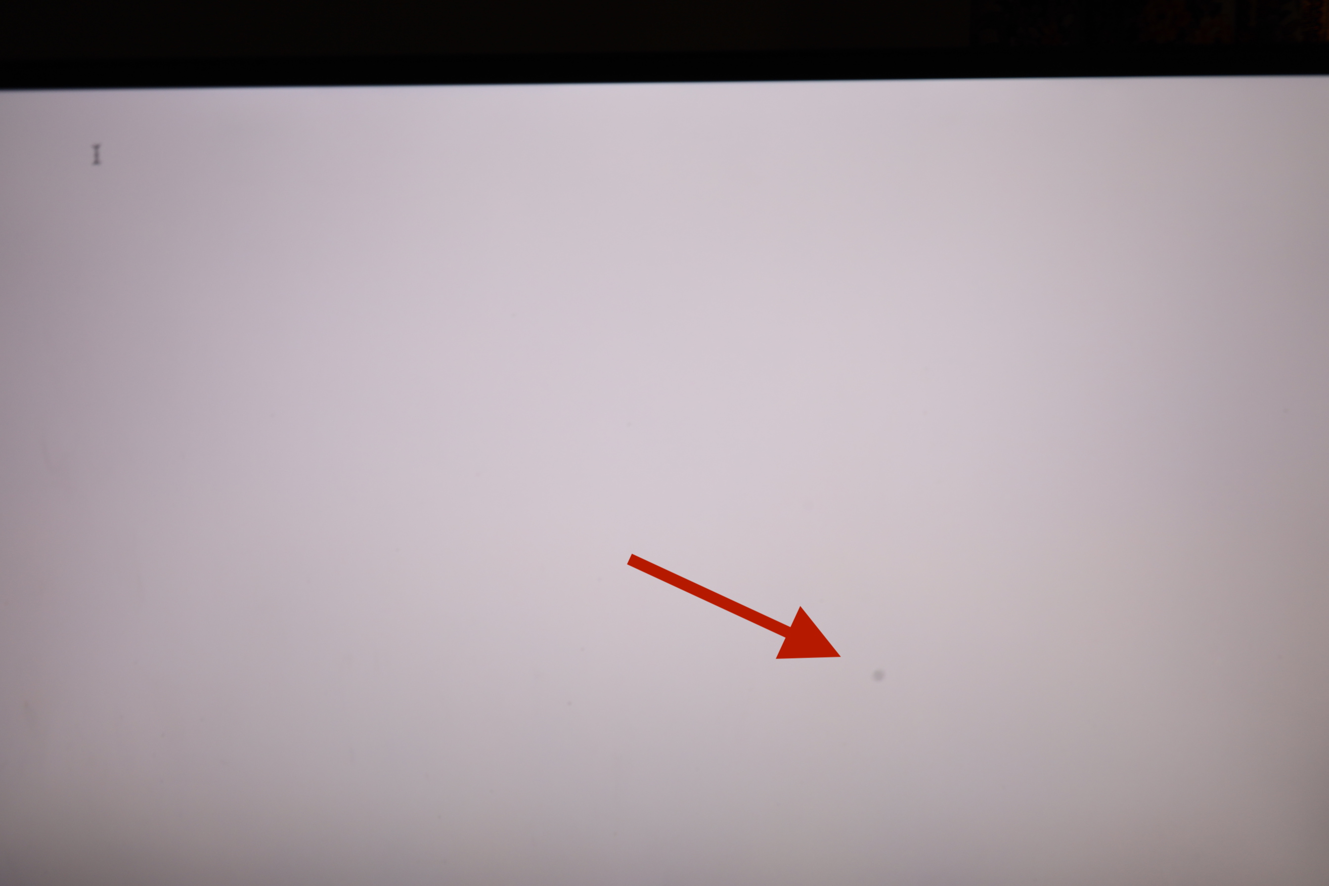

I've got either an area of dust or something else on the sensor of my Canon EOS R:
The camera is still under warranty and I'm wondering whether I should send it to Canon for a cleaning, or try to clean the sensor myself.
I've never tried that before with a digital camera.
Can anyone recommend what I should look for in a cleaning kit?
Any other advice?
It well may need to be cleaned professionally but your camera ought to have a self cleaning option in the menu. I find it helps if you do it with the camera facing down so the dirt falls away from the inside.
The easiest thing to do is to get one of those rocket blowers - a little nozzle with a bulb attached that you squeeze to shoot air - and puff at your sensor, holding the camera such that the sensor is not angled up, and doing it in an environment that isn't too dusty. There are rocket blowers with fancy filters and all sorts of things that you can get, but I don't know that it's ever been proven that they provide benefit over the standard, cheap rocket blower.
Usually, forcefully puffing air at the sensor is enough to dislodge specks of dust and other debris. As long as you're not shakey, the nozzle of the blower won't touch the sensor so you're not at risk of ruining anything. This is the cheapest and lowest-risk thing you can do, and it's usually all you need to do.
Wet cleaning is the bigger deal. It's more likely to fix your problem than the rocket blower, but it does involve coming into contact with the glass filter that resides over the top of the sensor. That scares a lot of people off. I admit I haven't done it, partly because I haven't needed to but also partly because I'd be afraid of ruining something.
My advice? Get a rocket blower, if you don't already have one, and give it a few puffs. If the dust hasn't cleared after that effort, consider either wet cleaning or if you're worried about ruining something, professional cleaning.
I’d suggest a staged approach.
Use the built-in cleaning function a couple of times and recheck for the dust.
If still present, use a rocket blower as suggested above. Put the camera into manual cleaning mode and turn it upside down whilst puffing the affected part of the sensor (remember the position on the sensor is reversed wrt the image). Do this in a dust-free location - I tend to do it above a kitchen countertop that has been wet-wiped. Check again.
Only if it still persists go for the wet sensor wipe method.
Hope this helps.

A followup:
After getting the cleaning kit as I mentioned in reply 5 above, I first tried the "blower bulb".
A few blasts of air dislodged the dust (as revealed in followup test pics of a white screen).
So... didn't need to actually "wipe the sensor" after all.
Thanks to all who replied above.
