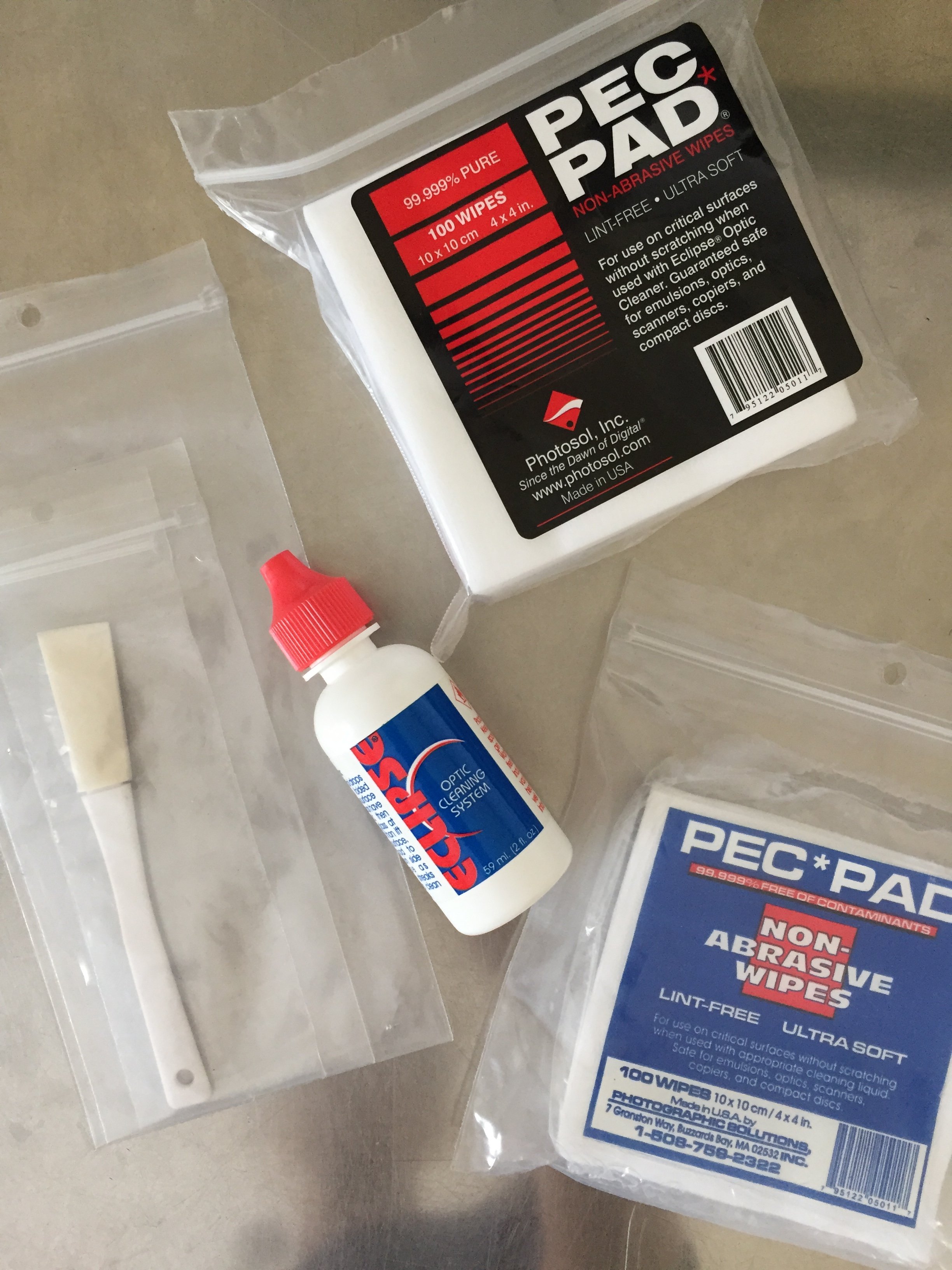

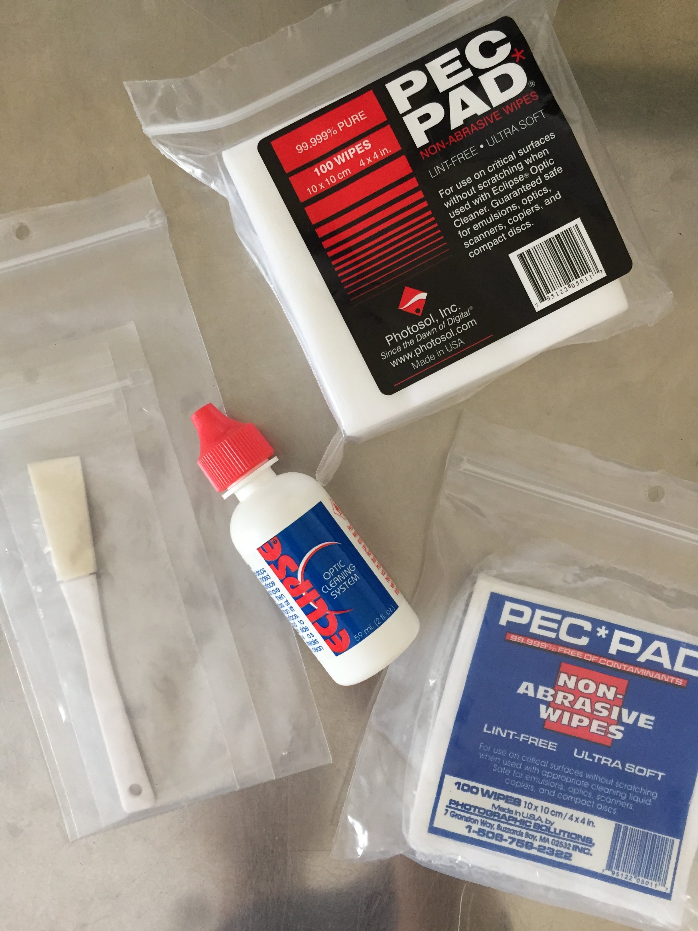

Cleaning a sensor can be a stressful task but it can be done at home with practice. I've been cleaning mine since owning the original 1D and I'd suggest looking at YouTube videos for tips. I've always used Eclipse fluid and Pec Pads without an issue. There are times when it only takes a few pads and then there are times when a dozen is necessary. Perhaps I've gotten better at avoiding contaminates but both my 5DIV's haven't needed cleaning yet but surely they will eventually.
My procedure is to run a fresh battery, connect via Capture One so I can shoot an image and inspect for debris and spots. Then, I will clean the sensor and repeat until I'm satisfied. Do your research, put together your supplies and don't be careless. Afterward, you will take pride in doing it yourself and think about how much you saved both in time and money. Hell, I only recently purchased my second pack of pads after about fifteen years and I still have about 1/4 of the original pack left and 1/3 of the liquid.

Be brave. A bottle of Eclipse fluid and a sensor swab and you are fine. Just remember dont reuse the swabs (some people say you can but personally I am scared to risk it). Couple drops of fluid on the swab, don't drown it. Don't tickle the sensor, don't scrub it. Nice positive motion once in one direction, flip the swab, once in the other direction. Bin the swab. Repeat as necessary. Use the right swab for the sensor size (just makes it easier)i.e. full frame on a full frame sensor, cropped on a cropped sensor and try not to pick up any gunk off the shutter mech. Sounds harder than it actually is. If you have a light tent - from product photography, do it in that to minimise airborne dust settling. It is daunting at first but you get confident after a few times.
Don't use:
1. One of those gel sticks -they can cause the sensor stack to de-laminate
2. A cheap butterfly brush - dust magnets in a bad way
3. A can of compressed air as the propellant leaves residue and the pressure of the air can cause damage
