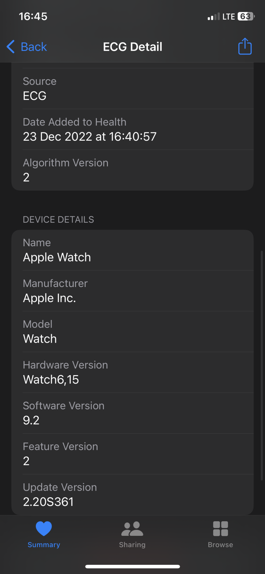

I think there might be change in versions when look on EKG graph - here from AW8:
Could you or someone else using previous AW tell difference?
Thanks, I had no idea this info even existed. Mine says Watch 4, Software version 9.2, Feature version 2 and Update version 2.20S361
Looks like no difference, at least in these numbers, from the series 4 to the series 6.

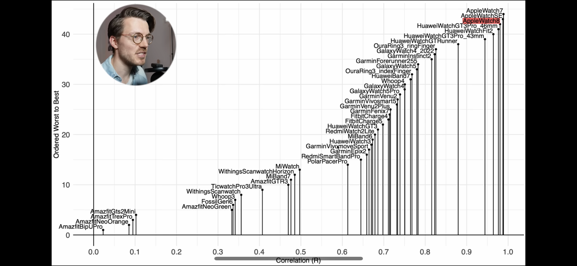

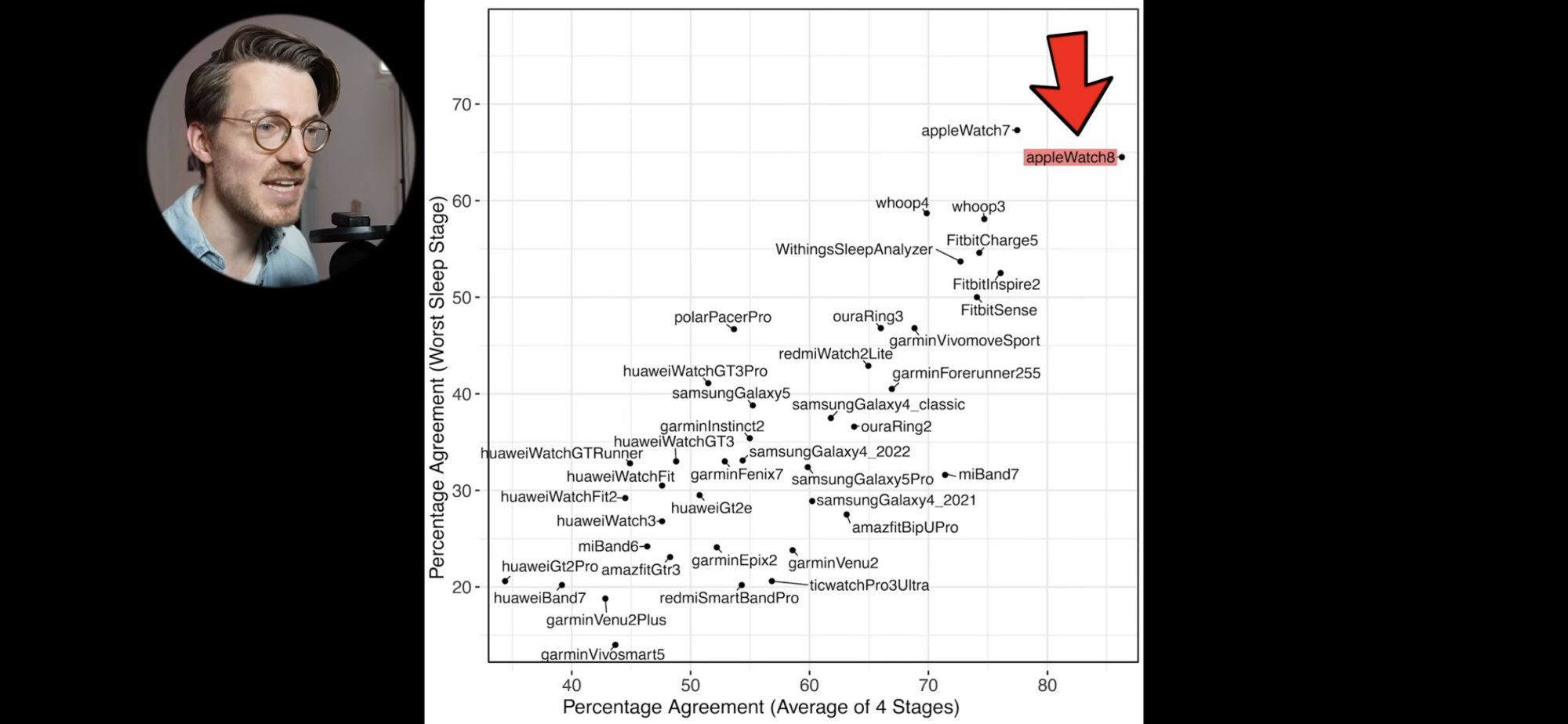

So, sleeping detection is improved in S8 vs S7 and previous.

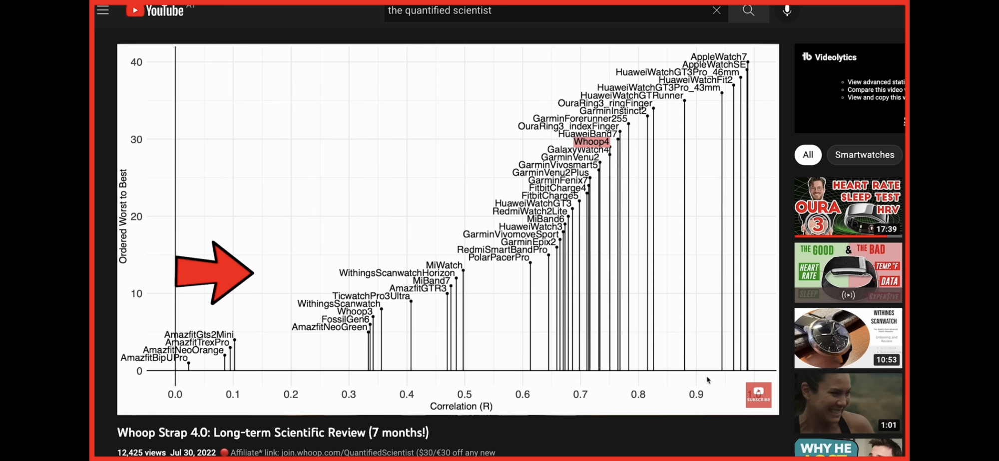

About heart rate during sports, for instance there is cycling - it’s a bit worse on S8 than S7 but way better than previous.
About SpO2 (Edit: S8 is not here, but it’s close or better than S7)
At least based on same tests of one YouTube I admire :p
All about S8:
