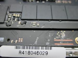

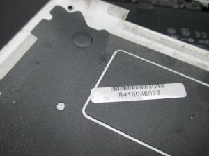

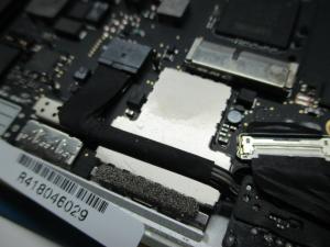

background: MacBook Pro serviced one time, shortly after purchase. Died randomly with plenty of charge last week, I took it in. The agent ran tests, everything was clear and functional. They shipped it off.
Now being told that there’s “water damage” that’s clearly something that’s not water and very dried on. The pictures show very little, but the one that does show it depicts something that’s essentially splashed onto the components, something that I couldn’t do if I tried. What should I do? The repair cost is $750, and the only problem was to do with power. Everything else was working. So far, Apple said I either need to pay or take it back. What would you do?

It looks to me like the internal components were exposed to liquid a long time ago, the liquid dried, and left behind residue.
Based on my personal experience, liquid exposure can take a long time to manifest itself.

I've seen cases where the liquid seeps in through the rear vent and initially does no harm. It's the residue left behind that slowly corrodes the internal components after the liquid had evaporated.
I have purchased and fixed several MacBook airs that have been exposed to liquids, allowed to dry, and used on a regular basis buy the owmer. One day, sometimes months later, the machine doesn't turn on and the owner sells it for parts. I buy them, thoroughly clean the boards with pure isopropyl alcohol, and they will sometimes work again. Other times, I have to replace the trackpad or keyboard.

This one just doesn’t make sense that way. It’s not like there was liquid on the keyboard that got thru. This is near the hinge, and on the side that would be upside down the the computer is sitting on a table. If it were to have happened by me, it would be on the underside of the metal case. This looks like it happened while the lower case was off.
I understand what you are saying and all I can do is comment on the pictures I see. I don't see anything to indicate that liquid was or wasn't splashed onto the board by the repair shop.
