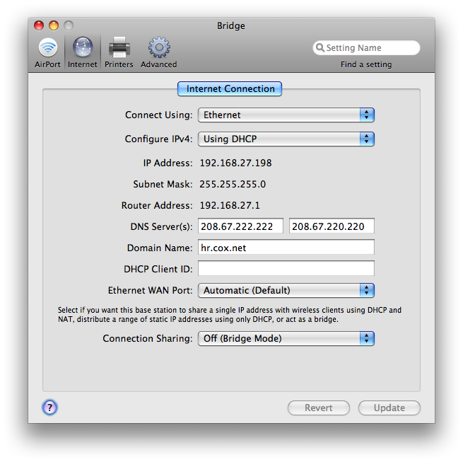

If you want it to act like one big network (meaning regardless off which access point you connect to, you can see devices on the other access point), do what TEG said, and then set the Express to Bridge mode.
