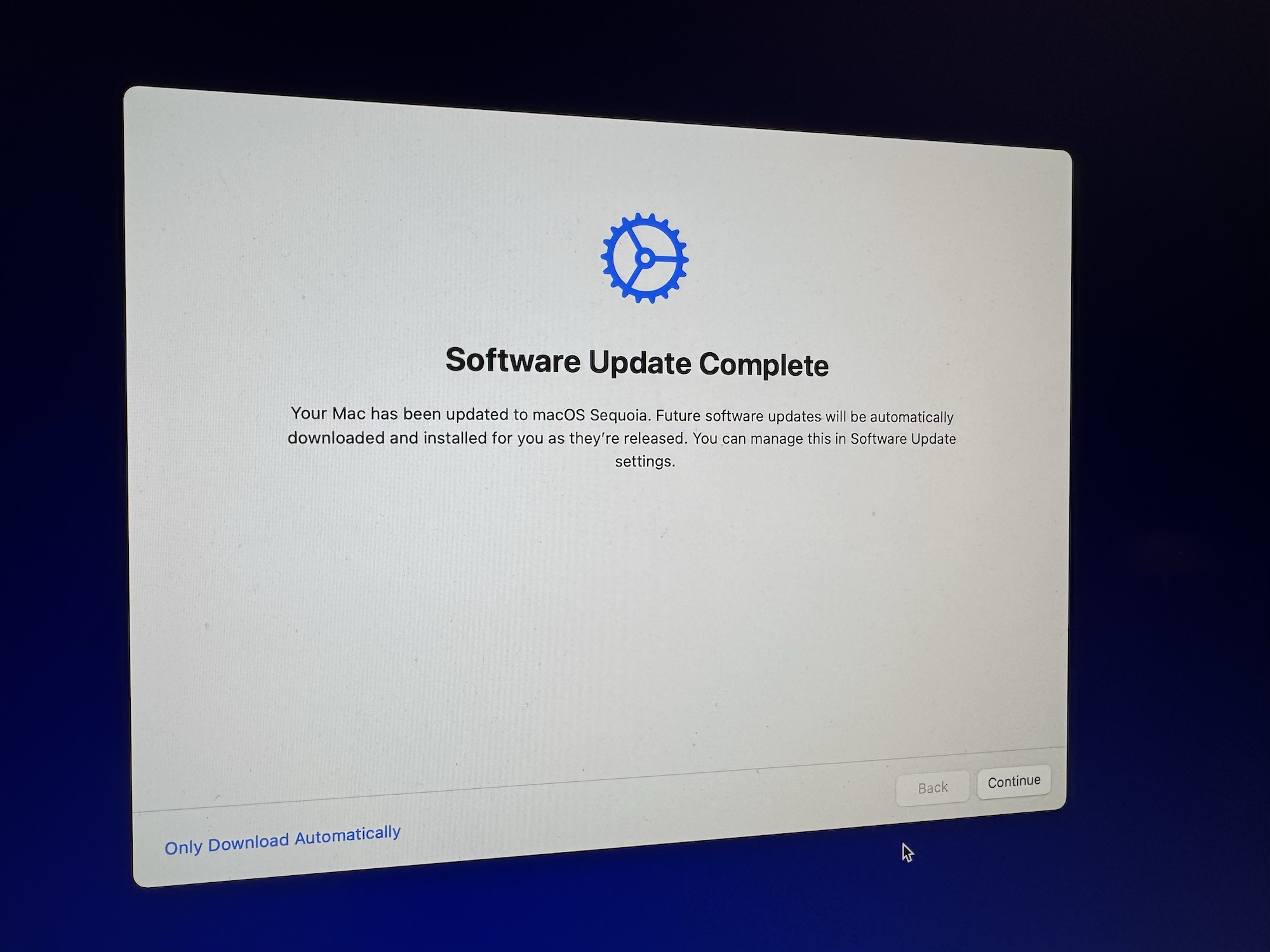

If, like me, you like to control when your software updates install (vs. having them happen automatically, watch out for this:
The text reads "Your Mac has been updated to macOS Sequoia. Future software updates will be automatically downloaded and installed for you as they're released. You can manage this in Software Update settings."
In other words, if you click Continue, it enables automatic software updates. Only Download Automatically is the non-default option, de-emphasized on the bottom left corner.

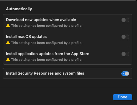

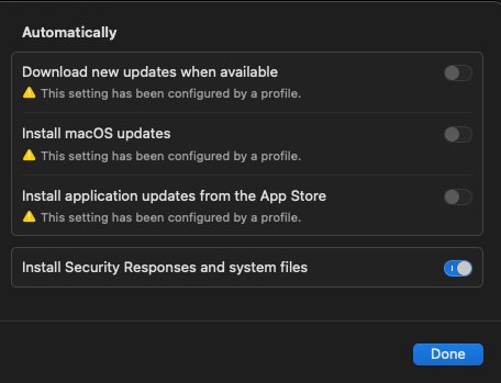

Doesn't happen if you restrict Software Update with a configuration profile
AutomaticDownload - false
AutomaticallyInstallMacOSUpdates - false
https://developer.apple.com/documentation/devicemanagement/softwareupdate
Apple Configurator https://apps.apple.com/app/id1037126344
iMazing Profile Editor https://apps.apple.com/app/id1487860882
iMazing - Create or edit Configuration Profiles for iOS, macOS, tvOS, or watchOS
https://imazing.com/guides/how-to-create-or-edit-apple-configuration-profiles
I have disabled “Install app updates from the App Store” as well.
It shows you a Software Update Complete and tells you this and gives you a link to turn it off.
I manually test in case a new update breaks my production software so I will always turn this off.
Right, just pointing out that if you have updates set to manually install, it's easy to click through this dialog box and inadvertantly change your setting.
