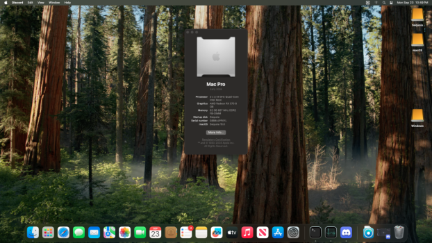

I was able to boot with both cpus by adopting some OCLP/Hackintosh MAGIC! By using Penryn SSDT-EC-DESKTOP.aml from Dortania's prebuilt SSDTs, spoofing to a 2019 iMac 19,1 (although I'm not sure that makes a difference. I will try spoofing other models) and adding HID ACPI patch to config.plist!
Add the following patch in ACPI/Patch section. (I used OpenCore Configurator to do this.)
Name: UNCO_HID to XHID
Find: 554E43 30085F48 4944
Replace: 554E43 30085848 4944
YES TO FINALLY BOOTING Sequoia on the macPRO 3,1 with DUAL CPUS!

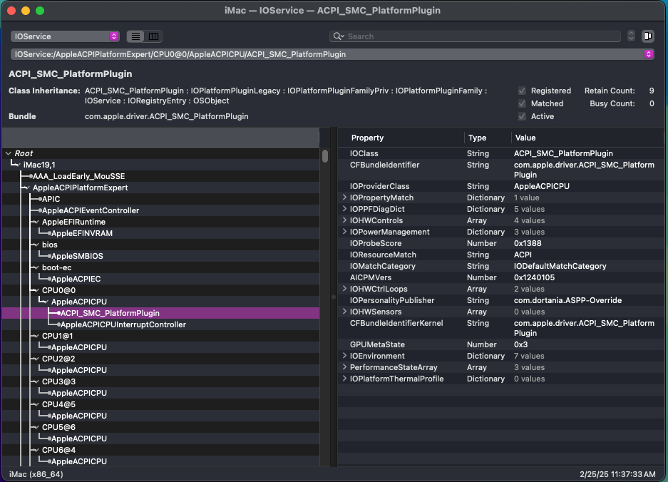

So it appears I need to do more SSDT tweaking. CPU Power Management isn't working :(
Edit: Works fine...

Well my solution is less than stable. I’m getting random no boot events. Zapping pram, SMC doesn’t seem to help. I thought, perhaps my EFI was corrupted so I moved it to another drive. Same results. Even with zero config changes, a working system will randomly not boot, then somehow boot at other times. This leads me to believe it is an nvram issue, corruption. Another user was able to implement my method and successfully booted with two cpus but the same thing happened to his 3,1 so not an isolated issue! Here’s a pic of the ACPIPlatform kp error. The cpu core in question seems to jumps around too. From 4-7 I’ve seen. Any guidance, suggestions are appreciated.
I’m finding a 3x pram reset will almost always let me boot again with all eight cores, leading me to believe it is an nvram issue.

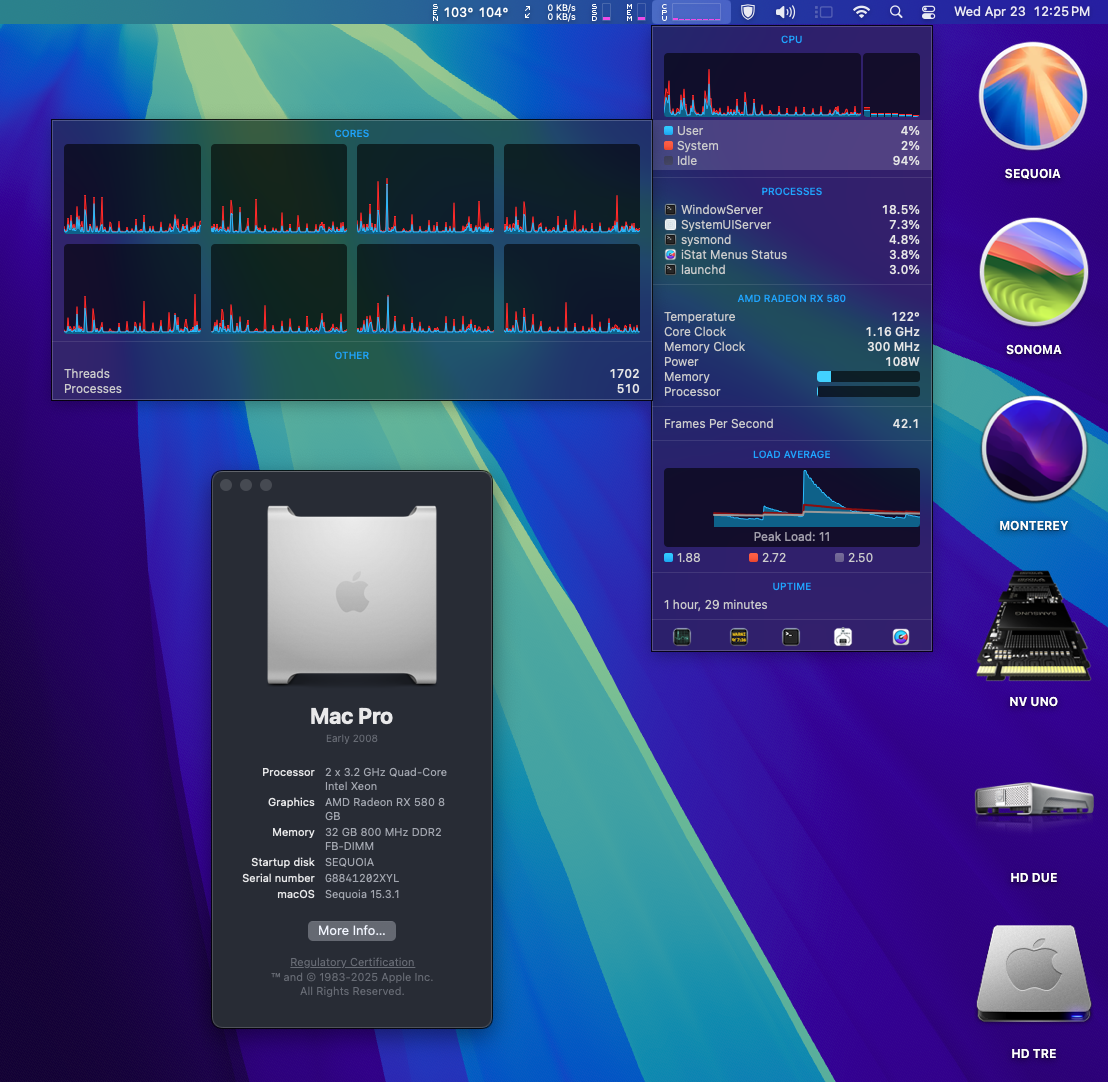

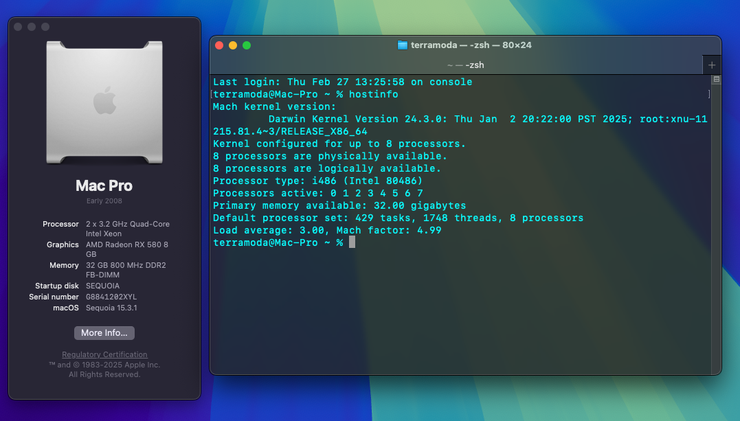

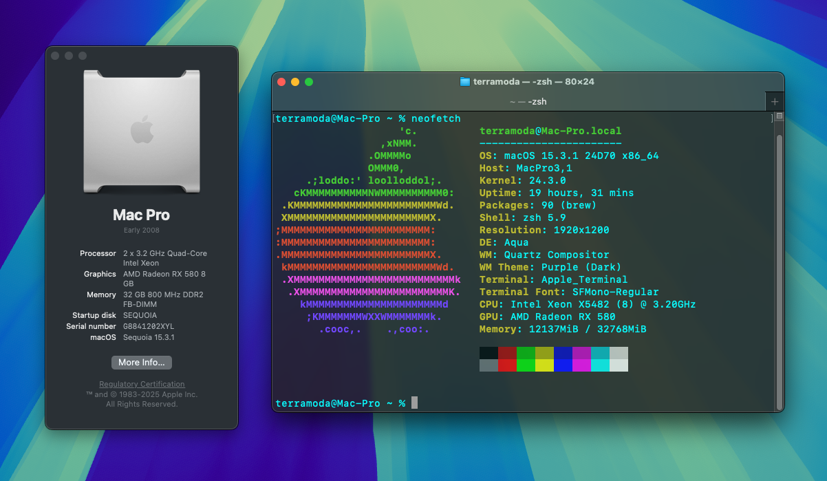

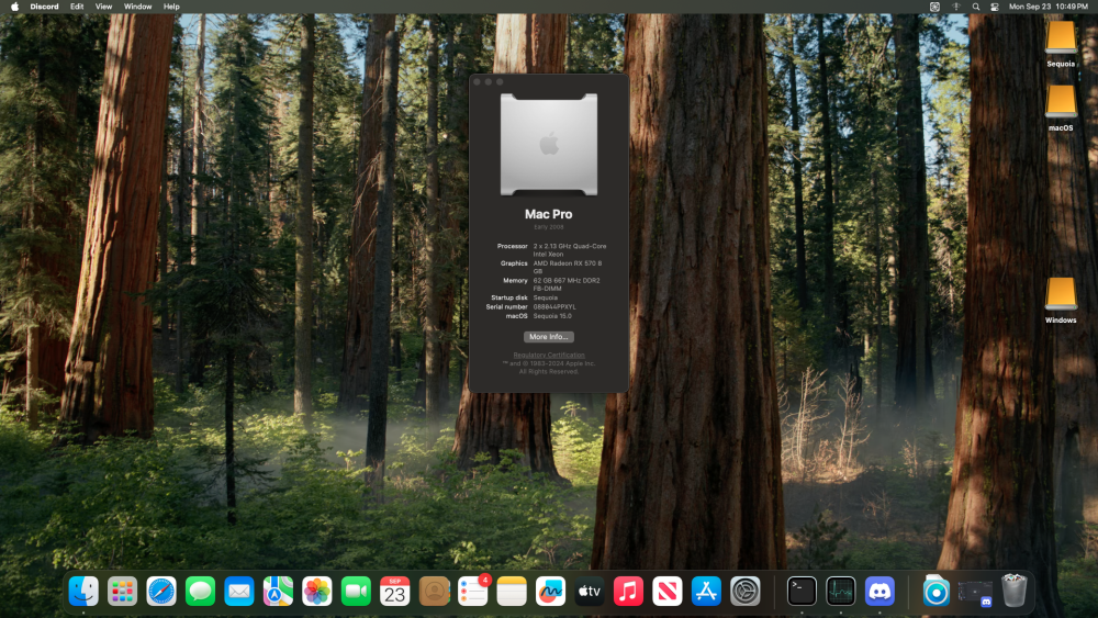

UPDATE!: I have a new and improved method how to enabled dual cpus in Sequoia on the 3,1!
Disregard previous method! This works much better.
Simply mount your working OCLP EFI, open config.plist, remove ‘cpus=4’ bootarg and add ‘acpi=2’ bootarg. Save config! Reboot! Much more success rate (still not 100%) and power mgmt seems to work better too.
No SSDT.aml, Patches. Just simple bootarg change on vanilla OCLP config!
If it does not boot, zap pram or use RESET NVRAM TOOL.
Reactions: JohnD and TheStork
I created a fork of Dortania’s OCLP GitHub where I’ve made this change in the hopes of them being pushed to Dortania’s ‘main’ repo after more testing. Jazzzny and Neon are aware of this project and hopefully will get it implemented. Feel free to check it out here:
Basically, the 3,1 Workaround now adds ‘acpi=2’ bootarg, enabling both cpus instead of ‘cpus=4’ bootarg, disabling one cpu. Any feedback, contributions are welcome!

Boot Sequoia on a macPRO 3,1 with BOTH CPUS! NEW WAY!
I’ve got a new bare SSD on the way and will do a clean Sequoia install, using your OCLP fork. Will report back.
My 3,1 - Dual quad core CPU, 12GB RAM, NVIDIA GTX 650 ti (or RX460…available).
If you use my fork, bear in mind, you’ll need Python 3 and Command Line Tools installed. Running root patches from source will fail unless you install the debug version of privileged helper tool. (Same with running Dortania from code.)
Cd into OpenCore-Legacy-Patcher/ci_tooling/privileged_helper_tool and type ‘make debug’ in terminal.
Then type ‘sudo ./install.sh’
This will install PH tool debug version.
Or, you can use Dortania’s latest nightly build and just change the cpus=4 bootarg to acpi=2.
Reactions: OldMacPro2
