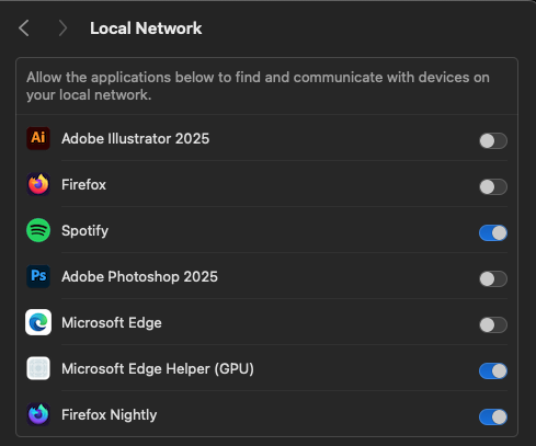

After a lot of chasing, we found that turning on these settings for our browsers solved our LAN resolution issues.

I just started having this issue with my Chrome browser. What is interesting, is it only seems to affect local webpages on the same subnet. I have some other web pages on a separate routable vlan that I can still get too. I can turn off/on the local network privacy setting, but that doesn't fix the problem. If i quit and reopen chrome, everything works again. This only seems to have started impacting me after updating to 15.3, and is still around in 15.3.1. When I got my Mini M4 a month ago, it was on 15.0 (or 15.1), and never had the issue.
For me, using Firefox, this issue has been fixed for a while now (I'm on the dev beta track).
To fix it at the time (until I installed the next beta), I'd go into Privacy & Security, Local Network and toggle access OFF for Firefox and then back on again.
