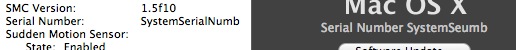

I just got my MBP back from a Logic Board replacement (bad video card - thread here) and the serial number is not showing up in About This Mac or in System Profiler (see attachment).
Should I be concerned or is the # stored on the Logic Board and wasn't/couldn't be updated on the new one?

It never shows up when the logic board is replaced. It's normal, so nothing to worry about.

It does seem very common for the SN not to be set after a logic board replacement, though it /can/ be set.. I've seen the service disc that does it.

Well, perhaps so, but they have not done so on any of the numerous logic boards I have had exhanged, and Apple themselves told me that they never do.
I actually took my machine to Apple after I replaced the logicboard myself and told them the serial number wasn't showing up. The guy at the genius part put in the CD and put the serial number back on the machine for me. I was very surprised that he did it, given that I did the repair myself. The moral of the story is, yes, some will do it.

A friend had his Main Logic Board (MLB) replaced by one of the retail stores - they forgot to re-serialize the new MLB (apparently they come blank until the Genius sets it.)
Often they forget, but its policy to set it.
They should also have a little sticker showing the new MAC address for any built-in ethernet ports.
