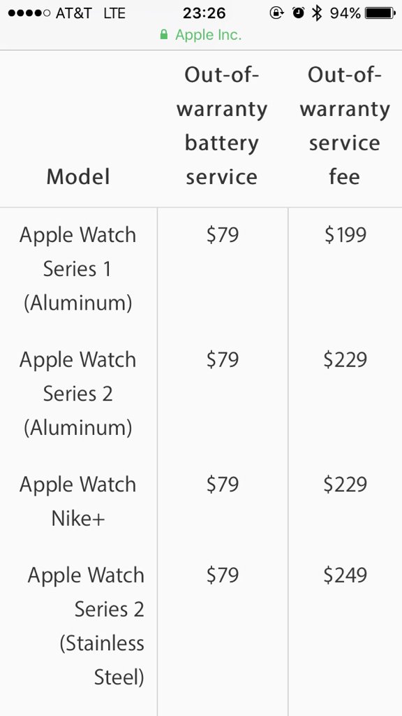

But the Series Zero watch is already 2 years old its hard for me to spend $$$ to replace the battery when I could get a new one
$50-70 is cheaper than a whole new watch. Dunno what kind of math you use, but cheaper = cheaper in every part of the world.
Apple askes more then that for a battery replacement but I understand what you are saying.
Yeah, you're right; it's $79, not $50-ish like I said. About the same as a proper battery replacement plus waterproof check on a nice watch at a reputable shop.
