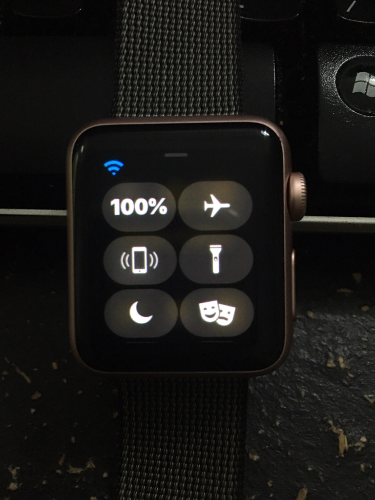

    My series 0 on WatchOS 4 connects to wifi with no problem when I turn off Bluetooth at home.
    [​IMG]
