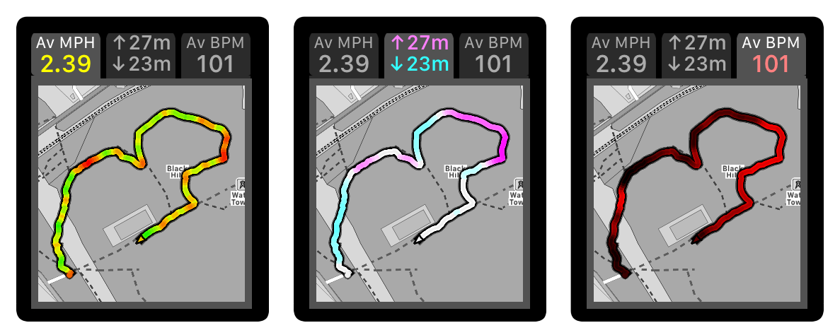

It also shows a breadcrumb trail that changes colour according to the signal strength, so it gives a very clear indication of how the GPS is performing.

The Apple trail is coloured by speed: green is fast, yellow is medium, red is slow.
WorkOutDoors allows you to see a similar trail on the watch at any time during a workout (rather than just afterwards).
You can choose from speed (using the same green, yellow and red), elevation (using pink for uphill, light blue for downhill) or heartrate (using dark red for low and bright red for high). On these screenshots you can see how my heart rate went up and my speed went down as I walked up the bright pink hill in the top left.

This looks interesting. I'll check it out. Out of curiosity, is this what the colored trail from the Apple Workout app means as well? If so then that's pretty telling about that run.
The color trail seen in the Workout app indicates your speed. The faster you move, the more green the trail is. The slower you move, the more red.
