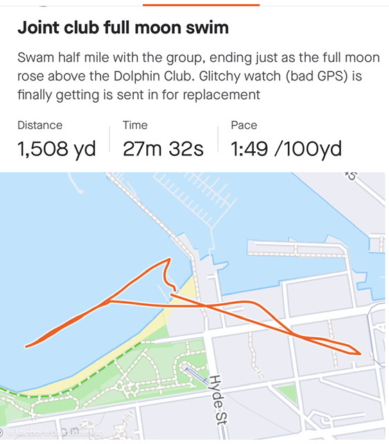

FWIW, I returned a S7 that was making horrendous tracks and WAY inaccurate distances while swimming (MySwimPro uploaded to Strava). One time it showed that I swam 3000 yards when it was really about 760 yards. The replacement watch has been perfect with zero issues.

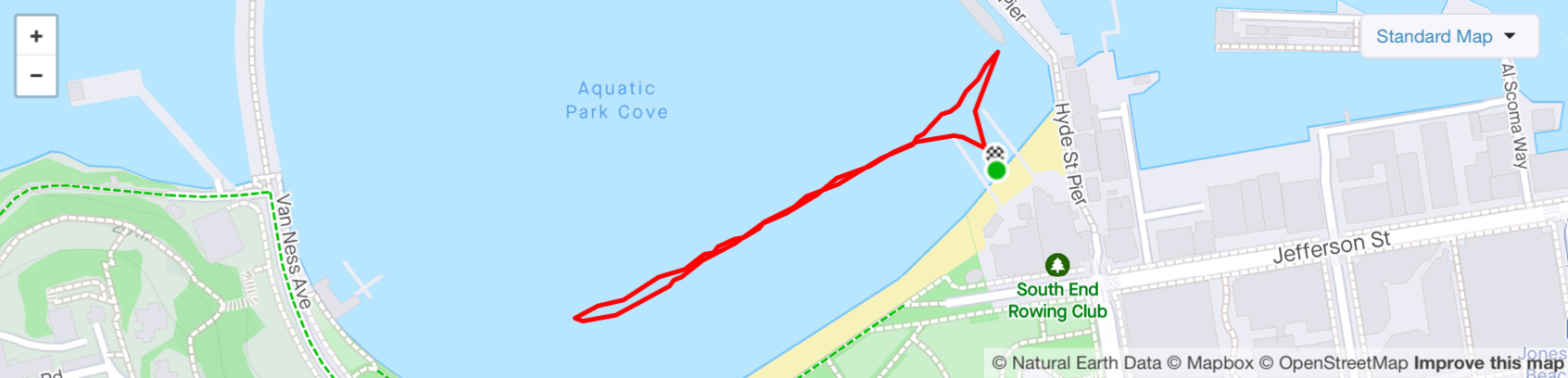

MySwimPro (aka Apple Watch App of The Year 2016 and 2020) uses GPS when open water swimming. Here’s a screenshot from Strava mobile app of my usual 1/2 mile swim along the buoy line:
(Defective watch with bad GPS)
Same swim with replacement watch:
Another thing I noticed is that the GPS signal strength indicator would bounce all over the place on the defective watch while on the beach with no obstructions, whereas now it quickly goes to green and stays there.
