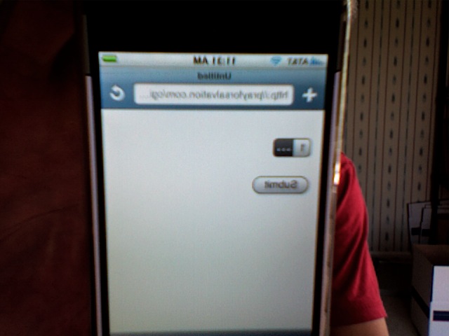

I guess I mis-spoke slightly, what happens is that by default, the first value is ALWAYS checked. You can actually remove the check and submit the form.
So submit the form with items checked that aren't the first one, then submit again when the form comes back without doing anything to the drop down box.
This is still a very bad bug. If you have a MULTIPLE select on a form and you don't want anything selected but don't go to that drop down box to unselect the first item, then you will inadvertently submit the first item.
