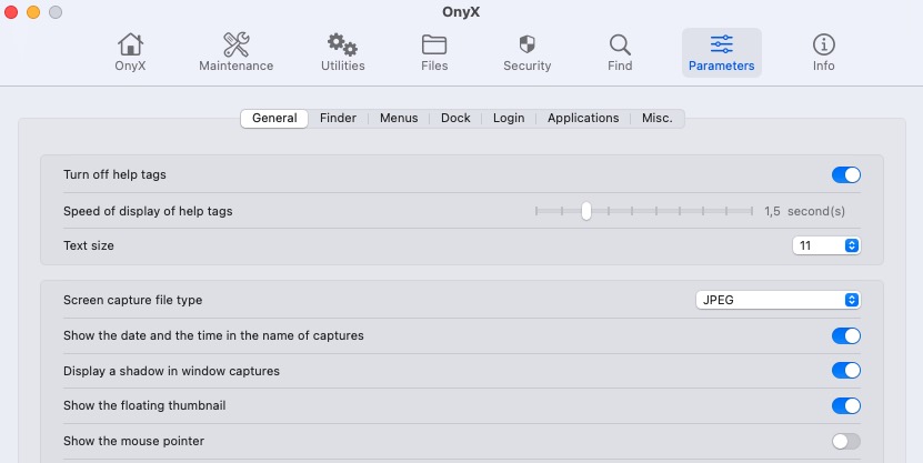

Please explain. I see no options for screenshots "app" to make it use .jpg as default using point and click on the GUI interface. Are you pointing at a solution of manually editing some file somewhere using maybe Terminal?
I use Onyx to change the screenshot file type to jpeg
