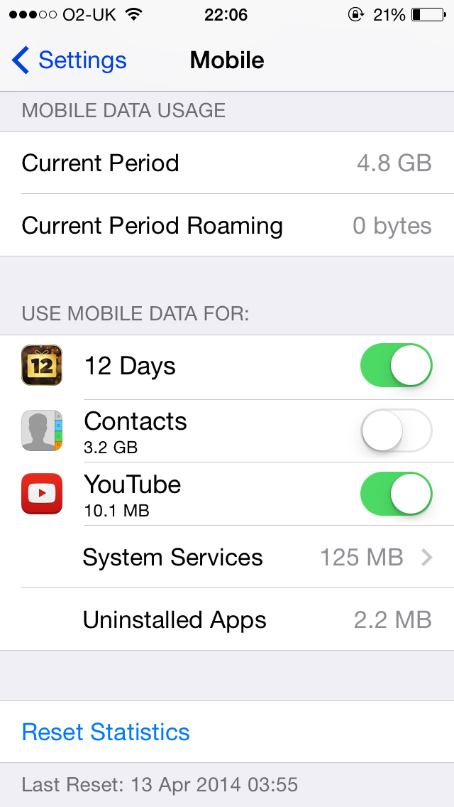

Hi everyone,
Over the past month; I've been wondering why my iPhone battery and data usage has been constantly running out.
On April the 13th I had to up my allowance with my carrier from 4 GB to 8 GB per month, purely because it was always being used.

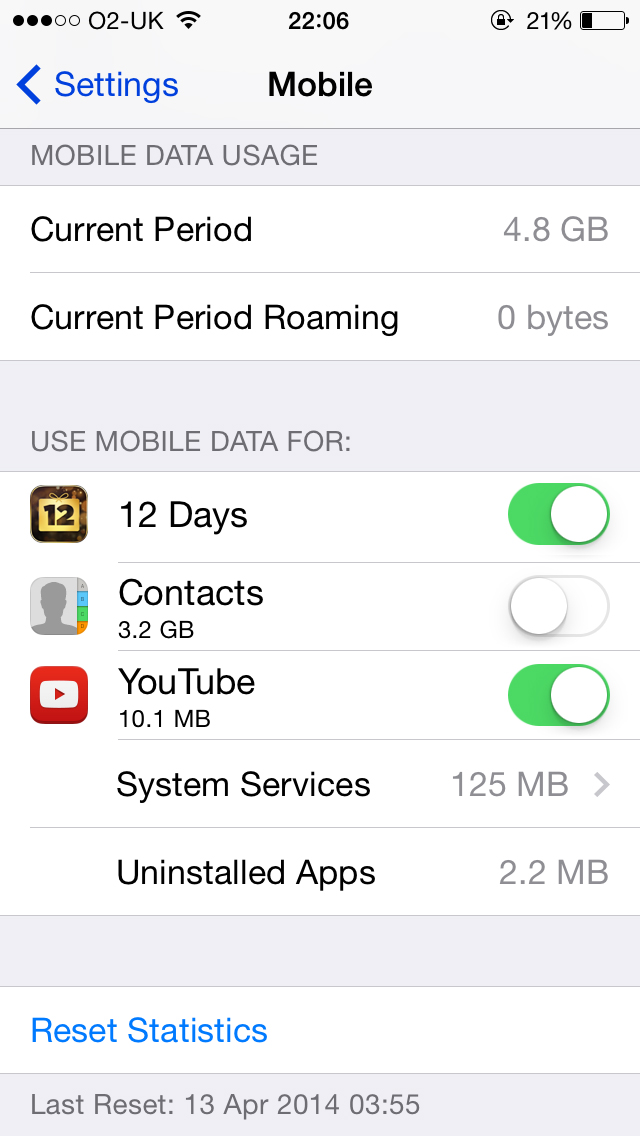

At the same time, I reset my Mobile Usage statistics; and what I've found is staggering.
[I've cropped/photoshopped 3 print screens in one from the Mobile Usage screen. Just so I can fit in the Mobile Usage area, the data the Contacts app is using and when I last reset it] So obviously, I've now turned Mobile Data for Contacts off.

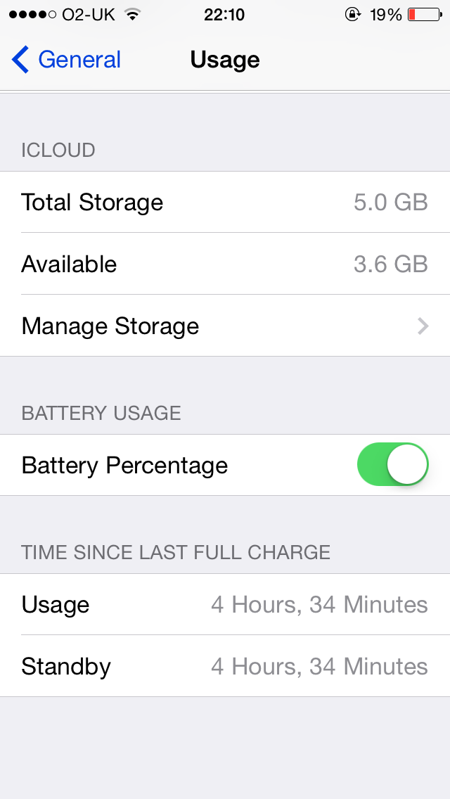

- See, I know something is wrong here because in the other print screen, Usage and Standby are the same.. when in fact, I’ve been asleep for the last hour!! haha! Phone has been locked, and just on my desk!
Anyone else getting this? iPhone 5s, never been on beta software, running GM 7.1.1, and I even did a full factory restore around 2 weeks ago too.

Sounds like it's trying to infinitely sync a contact with iCloud, due to something in the contacts database being amiss/corrupted.
The best way to easily resolve this is deleting all contacts from the device and letting them be pulled back down from iCloud, so that the state of the contacts database on the phone matches iCloud's state.
1. make sure your contacts in iCloud look OK by logging into icloud.com and checking the Contacts area. If there's no obvious problem (like half of them being missing), you're good to go.
2. on the device go to Settings -> iCloud, then turn off Contacts.
It'll ask if you want to keep the contacts currently on your phone, or delete them. Choose the option to delete them (your contacts will still be in iCloud).
3. restart your phone (in a perfect world it shouldn't be necessary, but best to do it anyway, just in case there's some background process involved with sync that's still running and the source of the problem). Once it's restarted, go back into Settings -> iCloud and turn Contacts back on. It'll then ask you to confirm that you want to merge the contacts from iCloud with your phone. Select Merge and away you go!
Hopefully this will solve the problem. If it doesn't, and you have more than one device, I'd do the same thing on all devices. (i.e. turn off contacts on all of them, so that no device is currently syncing with the iCloud contacts, then turn iCloud contacts sync back on)
This process is how I fixed a similar issue I was having with Reminders. Best of luck!
