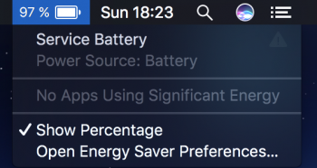

Now today I started using it on battery power again after charging it fully over night, and noticed the same quick drain. I decided to click the battery icon (see attachment) and it said "Service battery"!

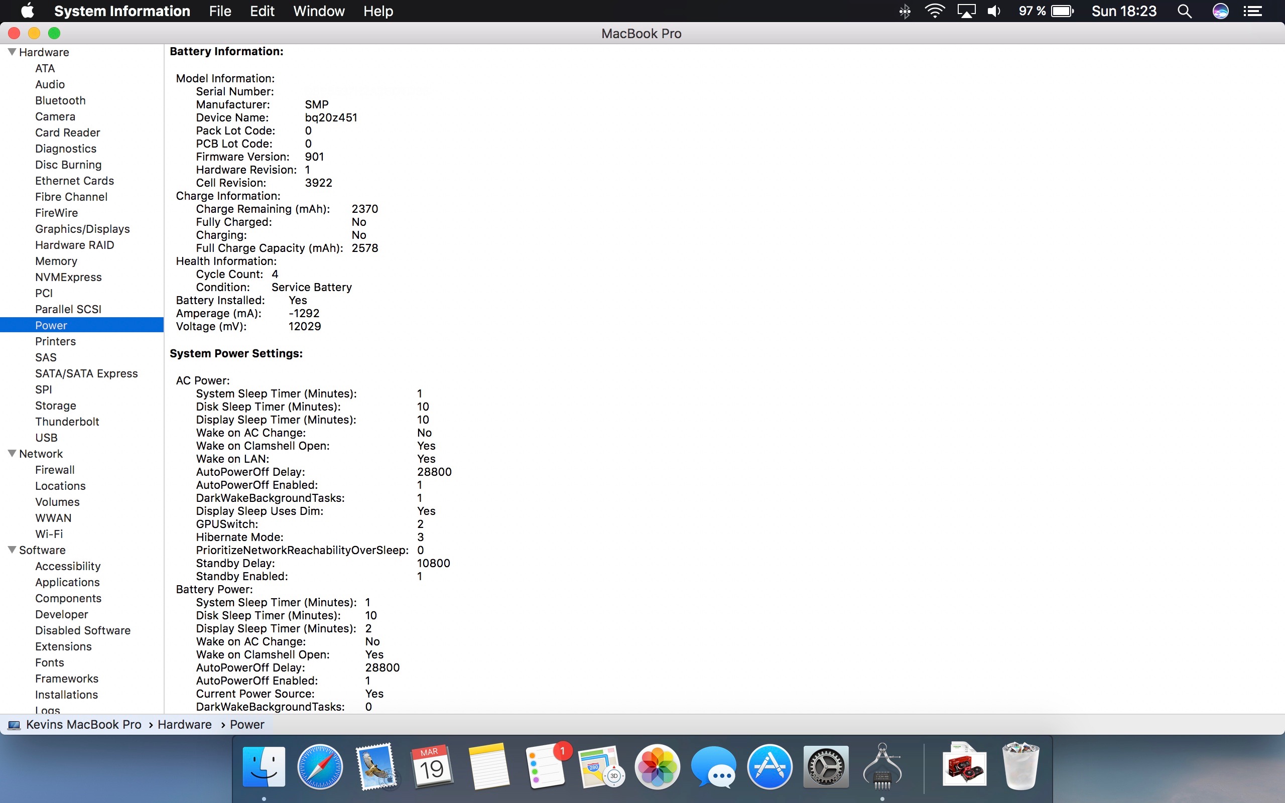

System Report gives the same status.

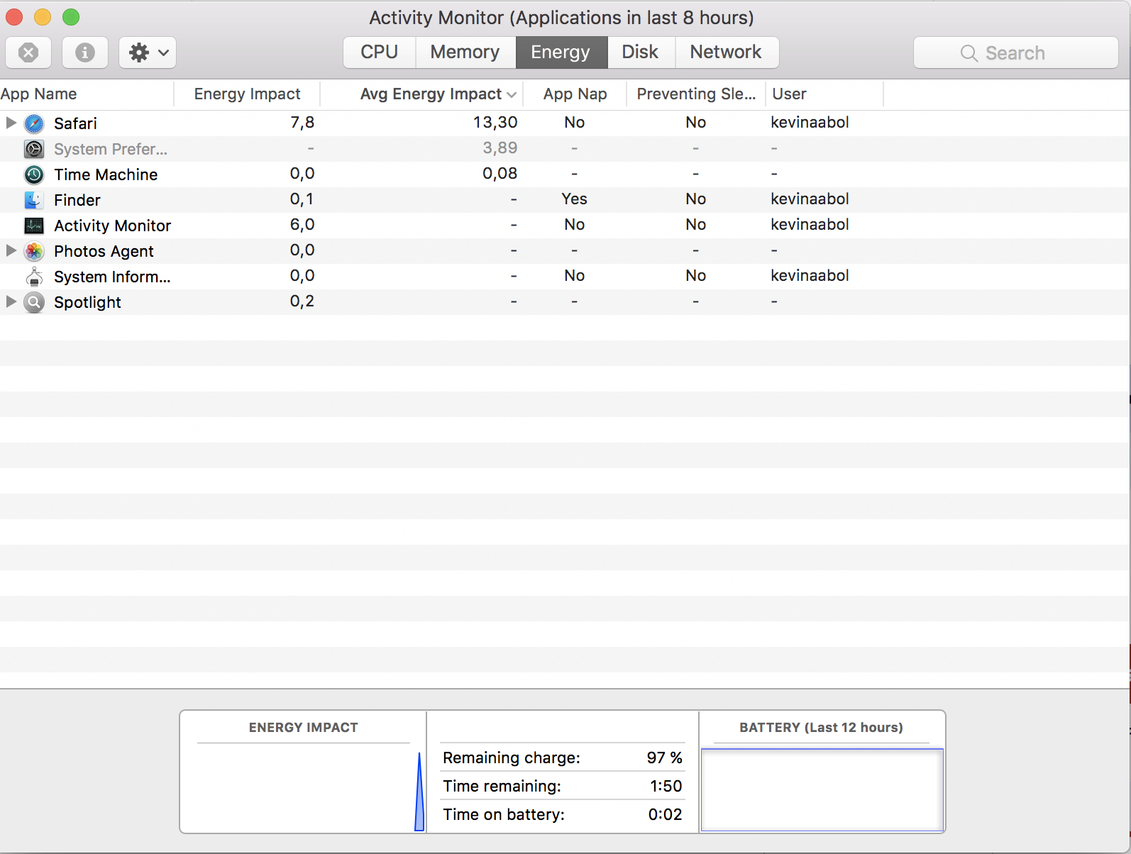

Activity Monitor currently quotes me 1hr50m remaining after 2 minutes on battery.

The full charge capacity shown is way below what it should be (over 4300 mAH), so something is definitely wrong. Resetting SMC would be the logical thing, and you already tried that, so I'd call Apple or go to the Apple Store.

A bit strange that it didn't notify me in any way though. I had to manually click the battery icon to see the "Service Battery" message.

It now states that the battery condition is normal, but "Full Charge Capacity (mAh)" is still 2578 mAh, or 60% of "New capacity (4315 mAh)" according to Battery monitor. 2578 mAh is reported both by MacOS "System Report" and Battery Monitor.
