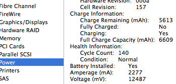

I did not think the battery usage or warnings were tied to the cache. What does the power section of system profiler show?
Charge Information:
Charge Remaining (mAh): 3329
Fully Charged: No
Charging: No
Full Charge Capacity (mAh): 4046
Health Information:
Cycle Count: 365
Condition: Service Battery
Battery Installed: Yes
Amperage (mA): -1183
Voltage (mV): 11630
Coconut battery:
Current Capacity: 4046 mAh
Design Capacity: 5450
74% capacity
Age: 23 months
Battery load cycles: 365
Battery temp: 30.8 C
Battery Power Usage: 13.9 watt
Charge Information:
Fully Charged: No
Charging: No
Health Information:
Cycle Count: 365
Voltage (mV): 11630
Coconut battery:
74% capacity
Age: 23 months
Since it says Service Battery, I think you need the battery serviced.
I am out of warranty :O! I have had no problems and this has popped up for like 4 months and has gone away on restart or using Onyx (whatever it does it clears it).
I think I should try calibrating it today to see if that fixes it. I mean I have only used 365 load cycles and you are suppose to get 1000 right?
I'm not sure. That is what my point was, a condition such as battery capacity or conditions are not kept in a cache. A cache is a temporary location and can be cleared without issues. I don't understand what Onyx is clearing when it does what it does. Either way the system is reporting a bad battery. The Apple store can tell you if you bring your system in if it needs a new battery.

It should but all batteries are different and you have to consider how you've used your battery. Right now I have the same warning. Some days it'll jump back to 89 percent and the warning will go away but will jump back down to 60 percent and even 29 percent. I think if you get the warning, the battery is defected. If you're out of warranty, you'll have to purchase a new one.
