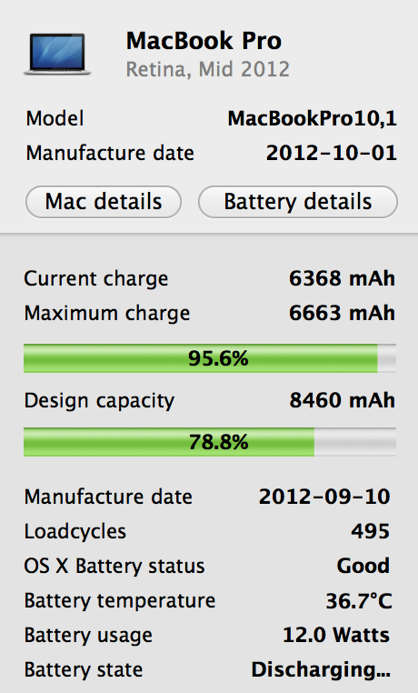

Simply not true.
My battery is reporting it's in good condition at 79%. I'll report back when it hits 75%.
