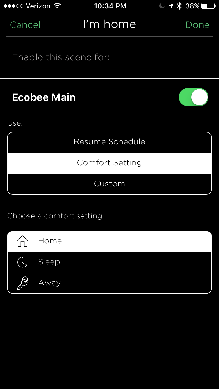

Just got an ecobee and managed to figure this out. I knew it could be done since you can tell Siri to set it to home or away. You can't do it through eve or home app, but you actually do it through ecobee app with scenes:
Account - Manage HomeKit - Scenes - <Pick a Scene> - Turn on ecobee - Set desired settings.
For instance to set yourself home, set:
Use - comfort setting - Home for the "I'm home" scene. Then you can just tap that scene in the home app or control panel.
Note: This will add it to your existing parameters for the scene. Also, it won't show up in eve but will in Home, but the values are incorrect. You can just ignore them. For me it was turned off and 45° for sleep, home, and away, but the scenes worked correctly.
Then you can set up a geofence in home or eve that sets "I'm home" scene once you are home.

Funny enough, ecobee' support wasn't able to tell me this. Thank you.
The problem with attaching Ecobee scenes to settings like this is that they also put the thermostat into "hold" mode. So if I say "Good night" then it stays in night mode until the next time I manually change it or change it with Siri. I'd use this functionality if you it would change the mode until the next scheduled change, but as it is, it's worse than just using the timed modes + motion detection, IMO.
