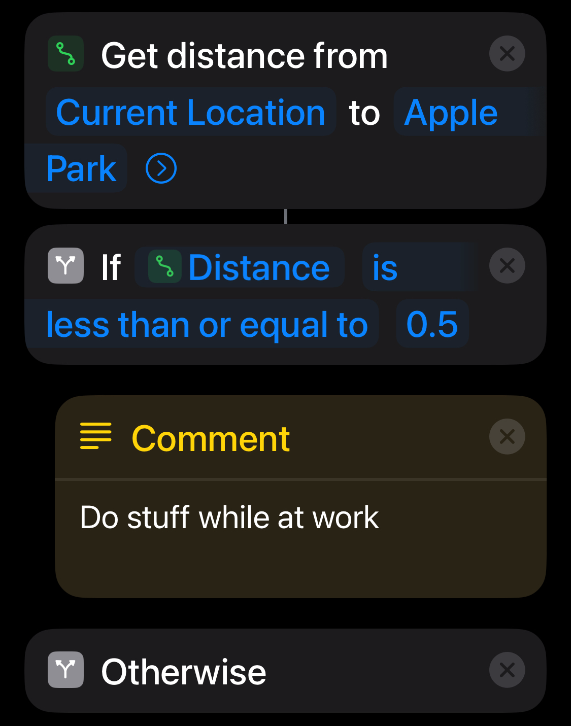

a) can add to the Automation/Shortcut a "Get distance from" Action. Params are Current Location and the address of "leaving from". Then an "if": if calculated distance is less then [1/4 mi | 1/2 mi | other] then show webpage.

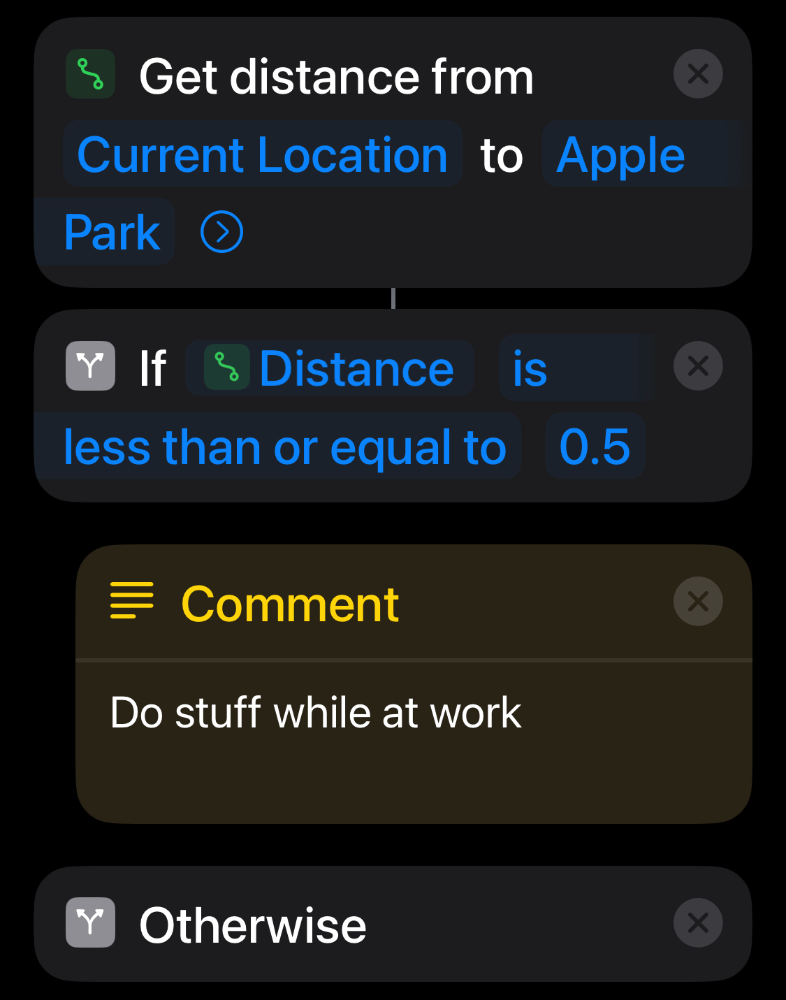

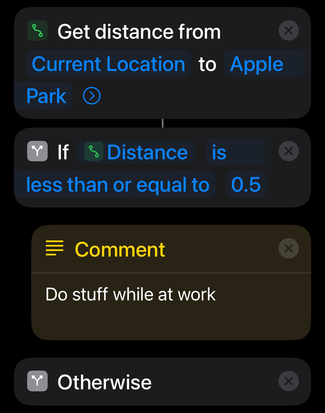

add A. Thanks for help. I am quite ashamed but I can not figure it that distance thing to work. I can not link next action to work. It should be simple but I am often lost in Shortcuts.
Pretty easy. If one works at Apple HQ, setting up a geo-fence (in miles) would look like below.
Automation: When: 5:00pm, M-F. Do: New Blank Automation
Then add following to blank automation.
