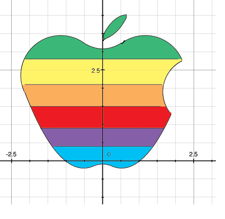

So, I'm doing a project using Grapher (link to description).
I'm being stupidly complicated (hopefully so that I get a 100!) and I'm making an Apple and probably a Steve Jobs or Alan Greenspan.
Soooo, I'm making it, bla bla bla, and I CAN'T FIGURE OUT HOW TO SET THE RANGE OF AN EQUATION! It's killing me! Am I going to get the insane pleasure of.. HAND GRAPHING? (oh, the horror!)
Soo.. long post short: how do I set range? not being able to is making me feel really dumb.. like I need to go back to .. basic 2nd grade math or something.
Thanks!

It took me a while to find it, but you can limit the domain or range of an equation by using an equation in the format:
y = condition ? expression
For example, to draw y=x with the domain (-2, 2), the equation would be:
y = x>-2 & x<2 ? x
Or to draw y=x^2 - 1 with the range (0,5) the equation would be:
y = y>0 & y<5 ? x^2-1

I just started finishing up my project, and GREAT GOOGLY MOOGLY I WANT TO THANK YOU AGAIN! YOU ROCK. I'M TYPING IN ALL CAPS FOR YOU.
If I have enough time/it looks good enough, I'll post a screenshot of it when I'm done.

holy googly, writing out "insanely great" will take a while...
oh well. I need to over-achieve. I want a 4.0! (only .08 more points.. come on, KT!)
**I colored it in graphic converter, I don't think Grapher does coloring like that.
