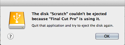

Hmm . . . but this still won't let me eject the external since FCP is still using it? I attached a screenshot of the error message. So I guess I do have to fully close the program then reboot if I move? Sorry - I know this is such noob talk. 😱
Yes, save your project and fully close FCP before ejecting the drive. Hiding any program in OS X will only do just that: hide it. But the program is still "open" and running.
If you force eject while FCP is open, your media references will break (go offline) and you'll have to reconnect them again. If you reopen FCP after quitting and the drive(s) that the last open project(s) were using are no longer present (mounted), you'll get offline media warnings.
BTW, you shouldn't have to reboot if you want to reopen FCP to work again. You would just want to make sure that any external drives that your last open project was referencing are connected and mounted PRIOR to reopening FCP and everything should remain connected just fine. Make sense?
