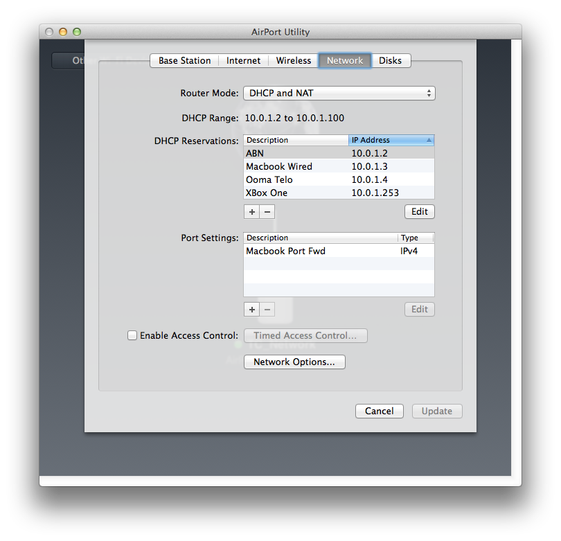

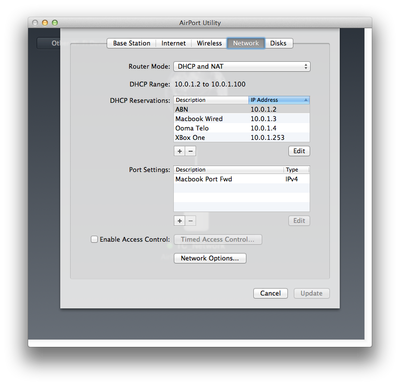

So I have an AirPort Extreme and was wondering if anyone could tell me how to set static IP addresses for connected devices within Airport Utility, as I'm not the greatest when it comes to dealing with routers. 😕 I have a bunch of HomeKit accessories - IDevices switches and Philips Hue Bulbs - and I've been having some issues with these devices not being found from time to time, mostly when I'm away from home, even though I have an always-on Apple TV 4 acting as the hub. I read somewhere that setting static IP addresses for these devices could help but for the life of me I can't figure out how to do that on the AirPort Extreme. I'm sure I'm probably missing something pretty obvious.
So, of someone could point me in the right direction, I'd be really grateful!

You want to continue using DHCP for everything, but you also want to set up some DHCP reservations for the devices that must have "static IP" addresses.
That means that whenever the AirPort Extreme sees a particular MAC address trying to connect (say, the MAC address for the Hue hub) it will always give it the same IP address (and just as importantly, it will never give that particular IP address to any other device)
You need to go to this screen in Airport Utility and add the devices under DHCP Reservations. You will need the MAC address of each device to do that.
