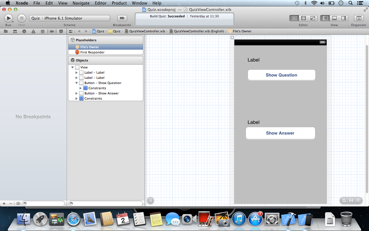

Thanks - I have fixed the anomaly in the methods capitalisation. I attach a screenshot showing the connections inspector - for the view. I am not sure what it should be :

Okay - so view is not there as suspected.
Do this:
Under Placeholder from the left of your screen..
Click on file owner - then control-drag to your grey background in your view - (Anywhere as long as it's not on a view object like a button or label or something)
You will see a blue line when doing this. When you let go a black box will pop up. Click "view"
This should connect your view to the file owner.
Run the app - it should be working now?

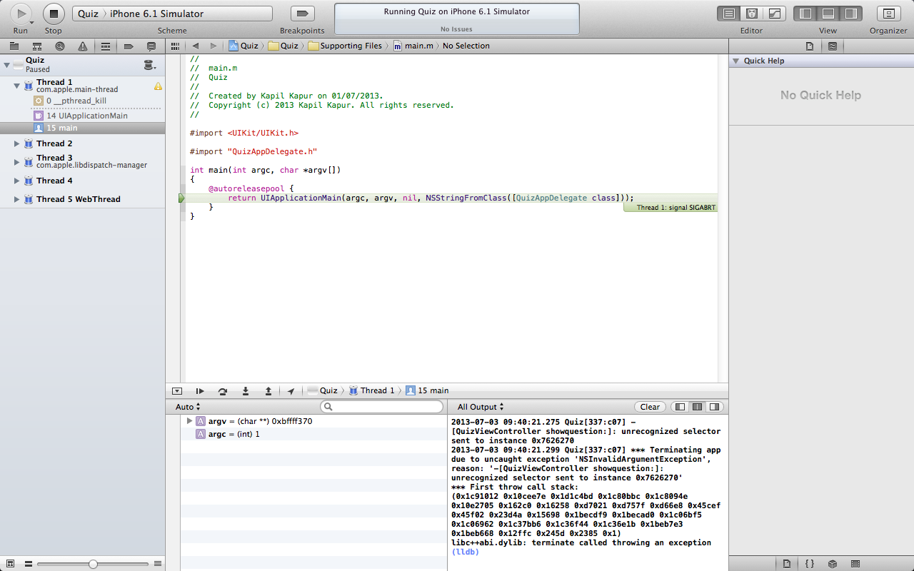

cool - it ran and then when I pressed "Show Question" - it crashed !!! I attach a screenshot

actually ignore that last post. seems to have resolved itself in that it no longer crashes. however pressing the "Show Question" button results in the app closing down with nothing happening !!
Did you read the error message if your second to last post?
It says "Unrecognised selector sent to an instance.."
Looking a few lines up you will see it mentions "showquestion" (This should say" showQuestion)
Did you clear the incomplete warning from earlier?
Both the header and implementation file method's should match exactly.
thanks again
The issue was in the connections - both the sent events referred to Showquestion and Showanswer rather than the ShowQuestion and ShowAnswer methods !!!
