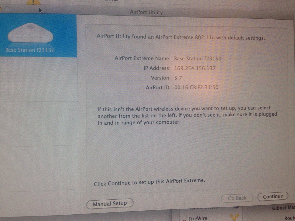

Just picked it up today for $5 but am wracking my brain as to how to use it as a bridge for some of my power pcs. The wifi network here is running from a netgear router which supports g and n as well. Any help would be appreciated.

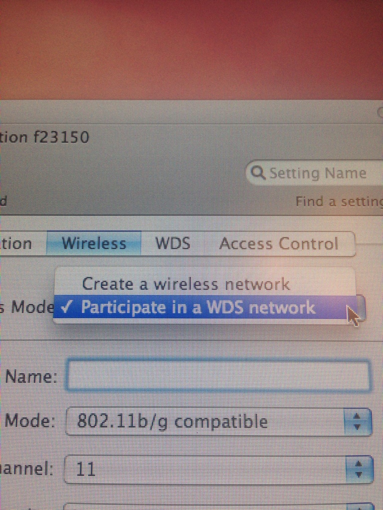

Are you talking about having the Netgear connect to the AirPort by Ethernet or have the AirPort wirelessly connect to the Netgear and then use the Ethernet ports on the AirPort? I do not believe the AirPort of that vintage will work with the "Extend" function but may work in WDS.
I'm trying to do it wirelessly and then connect it by ethernet to older power pc macs.
Have the Extreme join the network. You may not see that option by default in the list of wireless modes. To get that mode, press the option key and click the drop down menu, you'll then see the join a network mode.
When I click on wireless modes I get 2 options
Participate in a wds network or create a wireless network. If I try and save in that mode it says
Wds requires multiple apple wifi stations
Which I do not have
No difference
I've done it a few times I'll try again
I am not sure if an AirPort of this vintage will support it then. My Express supports it but I am not sure if Ethernet clients can connect through it as it is simply a printer adapter in my case.
Can't seem to find any solutions anywhere. Too bad as this would have helped my setup.
802.11n Express can as I use one occasionally as a 'wireless dongle' but the earlier 802.11g Express cannot. However, IIRR the Express can only extend from an AEBS. I tried it with a Netgear router and it wasn't having any of it. As far I can gather, each manufacturer tends to employ its own protocol for wireless extension of signals and that tends to limit interoperability of brands.
