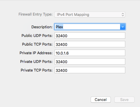

I managed to get this working quite easily, now using an Airport Extreme. On Airport Utility, just go on 'Network', click + and use settings like these.
Thank you for responding. 🙂 See, I did exactly that (IP was different, but same idea) and that turned up a double-NAT situation that didn't work. After google-ing around for a while, it *seemed* like the solution was to disable bridge-mode on the modem itself, which I did, and then the whole network fell apart and I had nothing-no plex, no WiFi, no internet of any kind.

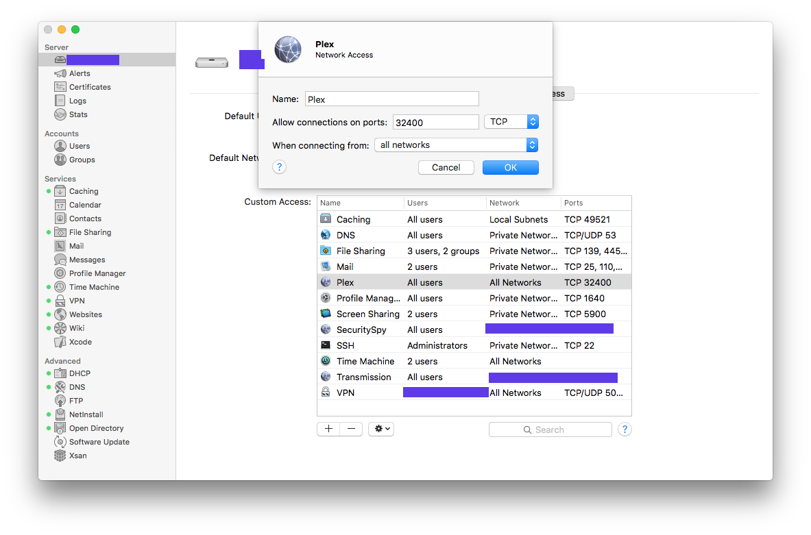

If you are running OS X Server, make sure that you have also enabled Plex in the server firewall (see screenshot). I was having similar problems to you (able to access Plex on LAN, but not remotely), though I did not have any trouble configuring port forwarding through AirPort utility or through the OS X Server interface, so wasn't seeing the double NAT error that you've encountered. Which services are you running on your server?
Thanks so much for your time and advice. I am not running OS X Server at all, simply a straight up version of El Capitain. I didn't see the need to do so, as my needs are very limited. I wanted to use the computer as an HTPC (which is accomplished brilliantly through a combination of iTunes, Plex, Shomi [Rogers Canada's answer to Netflix] and YouTube). I also use it to house files that I access on the go through Back To My Mac. It also does some light file handling using Hazel. That's about it. I didn't think I needed a server if that's all it was doing. So sadly, the instructions above don't apply to me. 🙁
