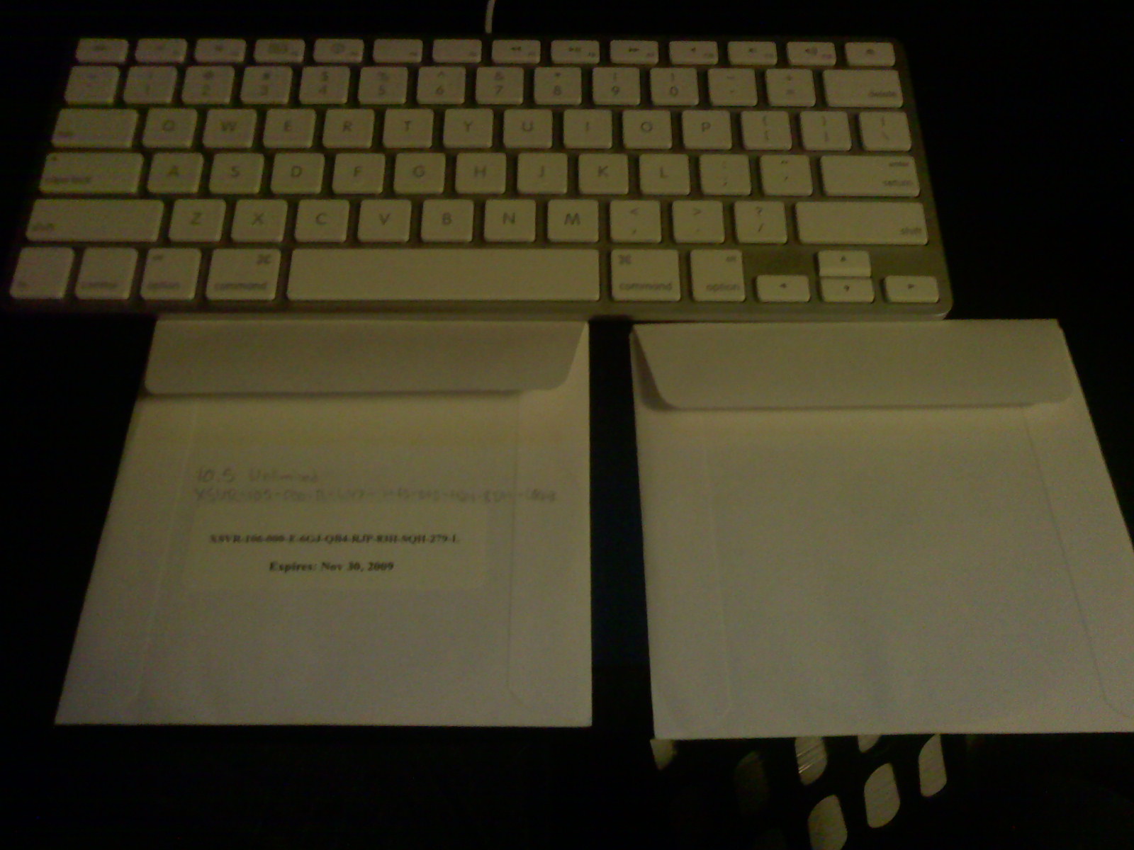

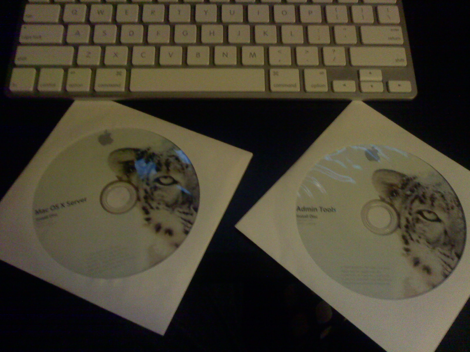

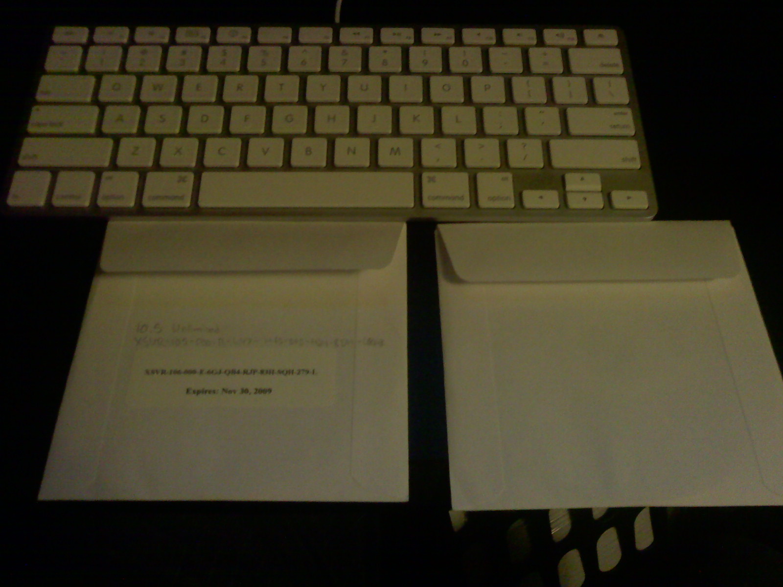

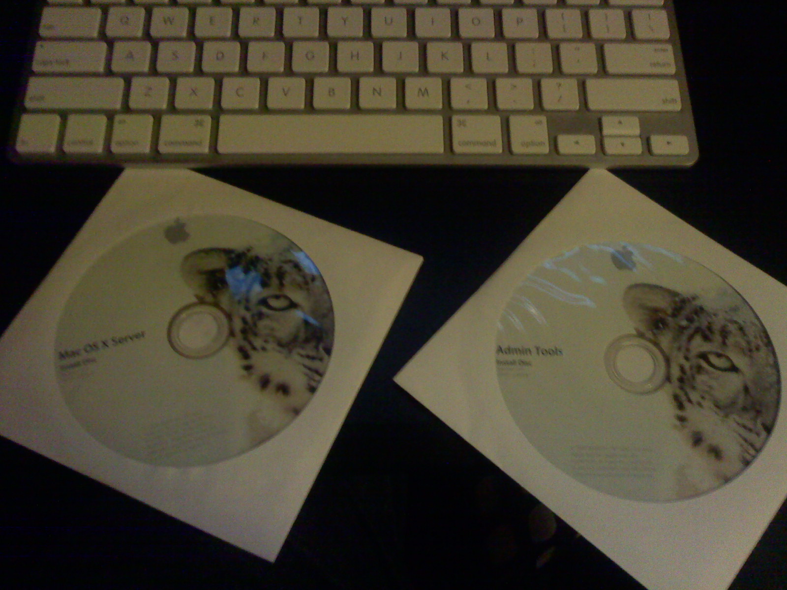

I'm sure it can be done with some freeware stuff. I know there are some MAMP packages out there to use on client OSX (standard) that can be used to do web and mysql, so I'm sure there would be stuff to do POP/IMAP and SMTP. Also, if you have an Intel machine, I'd go to Apple's OS X Server page and request a trial of OS X Server 10.6. Says you have to be a business, but they dont check any of that. They'll send you a copy of OS X Server and Admin Tools and a 30day serial. I did this (ironically I know have a legit business 😛) and have the disks. Pics below (and the serial on the disk has already expired so there)
