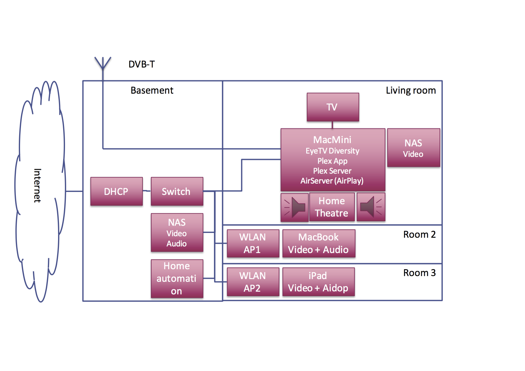

I hope you don't mind if I borrow this thread and ask my question here. It is related to Plex and Apple TV 4 too.
My current home theatre setup looks like this. I would like to make it more future proof and make it so usable that absolutely anyone in the family can use it. What are your recommendations, what would be the best way to develop the architecture?
The architecture of the current system is a result of evolution. Because of this, it is not perfect.
As you can see in the illustration, I have a MacMini sitting in the living room next to the TV. The Mini is getting old which makes it a point of failure.
Another thing which I don't like is that the Mini and the extensively scripted Remote Buddy + Logitech Harmony system are responsible of too many functions. I have noticed that the system's performance is not optimal in all scenarios, and the usability and user experience are not ideal if EyeTV is recording a TV show and someone opens Plex App in his room.
I could live with this, but we are a family...
I have thought about moving services from the living room to the basement. I have fast cabling in the house.

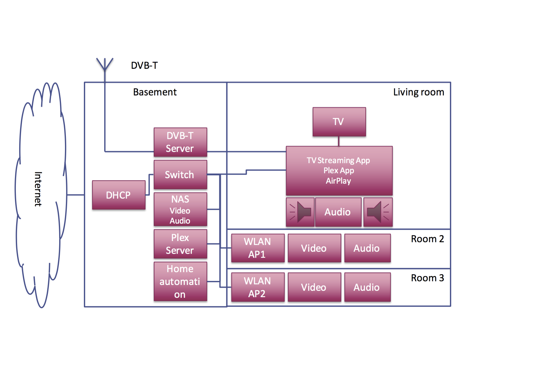

I have been thinking that the design could look something like this. What do you think?
The new system must be:
* Easy to maintain.
* User friendly (my family uses Mac/ iPad/ iPhone).
* Compatible with other devices (the Macs, and iProducts)
It would be nice, if:
* Energy consumption would not be high.
* Physical size would be reasonable.
I have planned following systems, but none of them seems to be good. Do you agree?
Plan A
Lowering the MacMini's workload by moving Plex Server from the MacMini to the NAS. It would have been interesting to see if this works, but I decided that this is probably not a good idea.
I started to hesitate because the NAS HW is not very powerful, I have important data on the NAS, and at the moment my NAS is realiable and stable. (The older I get the more I like "realiable and stable".) I don't want to crash it and make it unreliable by installing a "hack" that can be downloaded from a random source in the Internet.
Plan B
Building a Raspberry Pi Plex Server. RasPlex looks interesting and I could have moved my the home automation functions to the Pi too. I was also dreaming of replacing the current MacMini with a new Apple TV 4.
The pros of the Raspberry would have been low energy consumption and compact size.
I was also thinking that ATV could be more reliable and stable than a MacMini with applications and scripts (current or new).
But then I noticed that Raspberry Pi has only 100M port. I am not sure how this will work if there are several simultaneous users. Secondly I found myself thinking that there can be compatibility issues between RasPlex releases and official Plex App releases.
Thirdly, in this "Plan B", I would not have had a Live TV or PVR. EyeTV Netstream could have been an interesting technical solution (a bit expensive in my opinion). I could have placed in the basement and the antenna cables are anyway routed via the room in the the basement. But as far as I see, EyeTV does not support DVB-T in their new products? The Netstream is supports Satellite and Cable, but not T. The only product with DVB-T on the Elgato EyeTV web site is the Diversity, which I am using already in my current Minin.
Plan C
Moving the old Mini to the basement. Uninstalling anything else but Plex Server. Buying a new(er) MacMini to the living room and redesigning the RemoteBuddy scripts using all my software development process knowledge.
When the old Mini does nothing but Plex Server, it will not be a catastrophe when it dies someday.
But will this be easier to maintain and significantly more user friendly than the current system..?
All ideas are welcomed!
* Easy to maintain.
Plan A
Plan B
Plan C

It is a mid-2007 Core 2 Duo with 4GB RAM and 500GB local HDD (and external 1TB HDD).
One of the reasons why I have started to think that it could be a good time to make changes to the system is that I can't (officially) update the mid-2007 to the newest OS X. And because of this, AirPlay (I am using AirServer) does not work anymore with the newest iOS devices.
...is your network all wired? Do you have WiFi anywhere on the network? What sort of network switch are you using in terms of speed, gigabit?...
I have WiFi access points in my network (in the picture WLAN AP1 and WLAN AP2), but the relevant connections between the Plex Server and NAS (blue lines in the picture) are gigabit-compatible cables and the switch and Ethernet interfaces are gigabit too.

I see that you have your Mac Mini running the Plex Server and ATV4 running the Plex Client? I like this setup because it looks nice and simple.
Copying this setup would probably bring me pretty close to my "Plan C". I could move the Mac Mini to the basement and buy an ATV4 and plug it to my Yamaha A/V receiver (in the picture Home Theatre). But I think I would lose the PVR... I would need a PVR that works with DVB-T.
Do you have any PVR in your system? Or do you have a PVR in your Samsung TV? If you use the TV's recorder, can you move the export the shows that you have recorded from the TV to your Plex Server?
I am still trying to figure out, what would be the best design. I am starting to lean towards making the Mini just a Plex Server and getting an Apple TV 4. But this does not give me live TV or the ability to record TV shows.
I am currently using EyeTV Diversity, but that is DVB-T only (digital TV standard here in Europe, not HD, will end in 2017). I would like the new system to be HD ready.
Elgato EyeTV Netstream looked interesting but it does not support DVB-T2 (HD digital TV standard here in Europe).
Hauppauge Broadway has "Triple HD support (DVB-T, DVB-T2, DVB-C TV formats for Europe)", which makes it interesting too.
But if my primary UI is Apple TV, I guess these live TV streamers/ network recorders will not work with the ATV4? I guess that would require an Apple TV app?
Any thoughts, what would be the best way to get live TV and PVR functionality?
