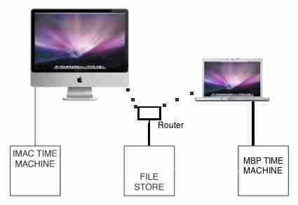

Hi, I have worked out a setup for my two macs so they both have backups and external file storage (see diagram). I have decided that I will need to set up some kind of network between the two macs but I am not really sure what to do. 😕
I have two questions regarding setting up the network connection:
1. I believe it is possible to set up a network between the two macs using just a firewire cable. How do I go about setting this up and is there any draw backs / things I should be aware of?
2. Someone suggested setting up a Gigabit ethernet switch. Could someone please explain this in detail, tell me what it is all about, (I have very little knowledge on this) the advantages and how to set it all up. If this is the way to go could someone please tell me what I will need or give some recommendations on products.
Also any other suggestions / adjustments I could make to the above diagram to make it more efficient or faster etc.

err... could you be a little more detailed please. How does the switch work (do i need a switch?). I presume that both machines plug into it and they can then connect, please explain how it all works.

Does this mean there will be a problem with the file store being accessed by both computers, even though it is over a network?
Well you'd need a router. For instance, the airport extreme basestation is a gigabit router. You basically plug both computers in to it, turn on filesharing on your imac while setting up the applicable shares and your laptop will see the externals.
so am I right in thinking that using a router will enable both macs to access the external file storage with the MBP accessing it through the imac? would a simple firewire cable not do this (would the imac act as a server?)
with a router would it be possible to attach the drives in another way (so the MBP was not accessing the files through the imac).
I appologise for my lack of knowledge on this subject, thanks for your help🙂

The airport extreme does not have firewire though and I really need the speed of firewire. Any alternatives?
I just need to know that there will not be any problems if both macs are trying to read/write to the HD. A router / airport with the drive connected to it would solve this i understand. Would it not work though if the HD was connected through the imac instead? Does there really need to be a router or can I just have a firewire cable between the two machines? 😕

Frankly I would do a setup like this:

Thanks for all your help. I got rather confused but I now have it sorted. Let me explain:
On the apple site under time machine it states -
"You can designate just about any HFS+ formatted FireWire or USB drive connected to a Mac as a Time Machine backup drive. Time Machine can also back up to another Mac running Leopard with Personal File Sharing, Leopard Server, or Xsan storage devices."
this answers my questions (the one place I didn't think to look) I also found these threads:
https://forums.macrumors.com/threads/375896/
https://forums.macrumors.com/threads/377283/
These explain how to use a drive for TM which is connected to another mac which you are connected to via a network.
This means that my diagram would work and the MBP TM drive would be accessible via the imac over a network.
My reason for doing this is so that I only have one cable to plug in to my MBP to access the TM backup and other files from the file store.
One remaining question:
Will I also be able to mount the file store on the MBP when required so both macs can access my photo librarys at the same time?
