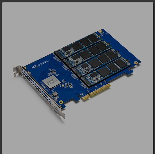

I have a 2012 MacPro 5,1 currently running High Sierra. I am getting ready to upgrade to a Sapphire Radeon RX580 Video Card and Mojave.
Once I work any bugs out, I am looking at this as a possible Boot Drive solution:
This unit says it comes with SoftRAID, but I am a bit confused since I have never set-up a RAID configuration before. How would you set up this card "by itself" to use SoftRAID? Would I not need multiple drives to make that work?

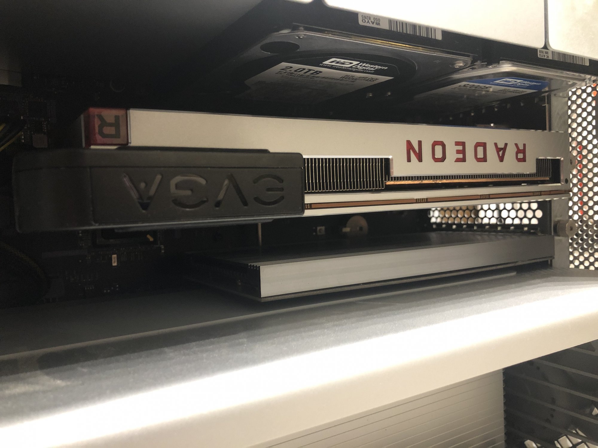

Attached below you see my setup with the sacrificed empty slot for max SSD speed in slot #1. Regardless of your PCIe adapter card of choice, this is how it would look like if speed is of the essence.

Check the photos in the link you supplied, that card already has 4 blade ssd's.

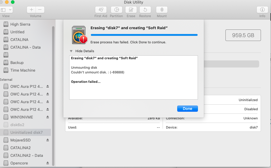

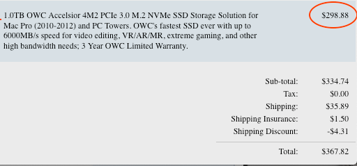

Sure glad I purchased my OWC Accelsior 4M2 in January before they almost doubled the price. 😱

Sorry, I assumed you already had a working SoftRaid volume.
Maybe try reading the SoftRaid documentation, especially the part where it says...
"SoftRaid does not support creating, modifying or converting APFS volumes."
