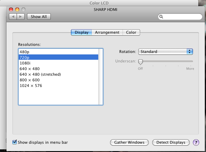

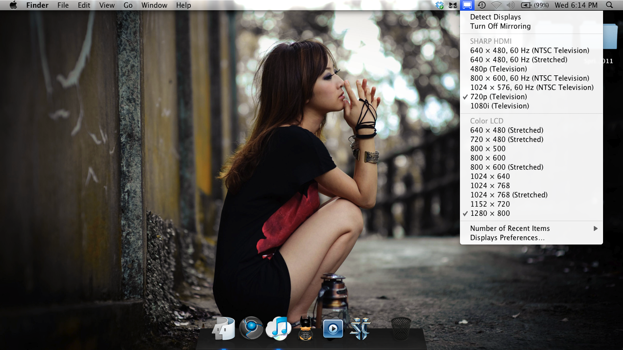

hello guys, i am having a bit of a problem with my set up.i currently have my MiniDP to HDMI hooked up to my 26" sharp hdtv. i got audio and video going through to it, but the video is not actually 100%, its now showing the title bar that is on top. (being cut off) picture of it being cut off:
and this is the current configurations i have for it:
any help would be appreciated!

im not quite sure what you're talking about hah. sorry im a rookie at this stuff, but i went into system preferences and saw underscan but could not move the slider:

don't mean to double post but i got it 😀 after doing a few research this is what i did:
  1. turned off mirrored monitors
  2. set my HDTV as the primarly monitor (under arrangement tab, move the white rectangle to the bigger box)
  3. lastly did underscan to make it fit onto my tv 🙂
