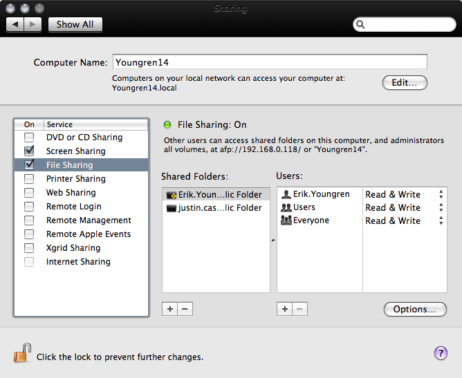

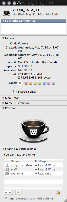

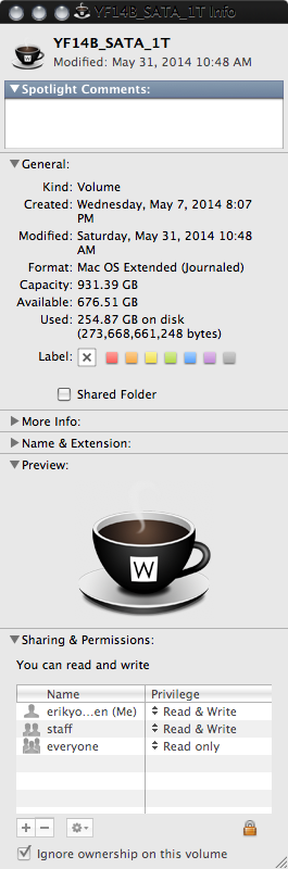

Create a folder where you want everything to be shared. Or a drive. To avoid permissions issues you can Get Info on a drive and make sure that the "Ignore Ownership" box is checked.

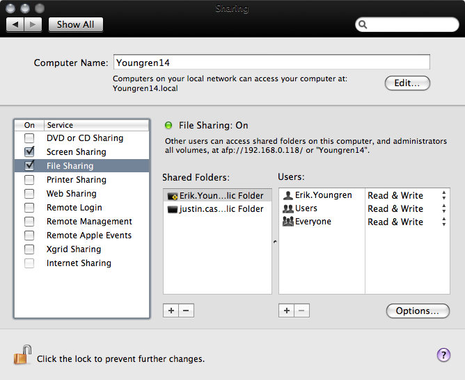

Add the folders you want to share (or drives) into the Sharing prefpane under File Sharing. You can add accounts for Sharing only if you like and you can adjust permissions in here for every folder/drive you drop in there.

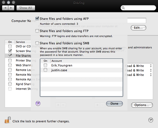

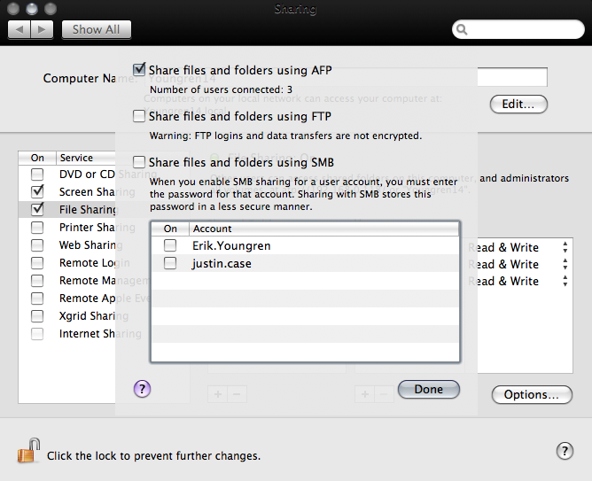

If you press the Options button (which you will want to do) make sure the SMB option box is checked (so you can share with Windows PCs).
