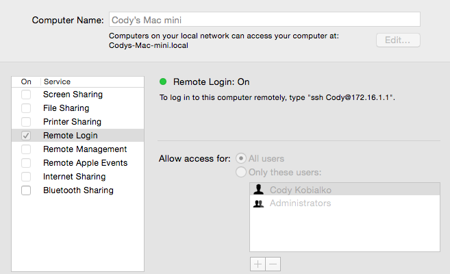

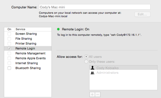

Okay so I'm having an issue with creating a working sftp server on my Mac, I have setup the new user account properly and port forwarded my router, the problem being I can connect via localhost although cannot connect from remote locations with all credentials being correct, any help with this? I can go over my firewall port forwarding settings again, and the account information. I have also enabled the remote file option in the sharing section.
Do you mean Remote Login in System Preferences? This is the service that you need to enable for SFTP to work, and it should just work out of the box. If not, how exactly have you set up your server?

Yes I enabled it in system preferences, what exactly am I getting myself into to get it to run on *.22 I have never used ssh/sftp on this device either, is there any articles on how to manually configure th shh_Config file?

System firewall is off and Intego firewall I have off, I can connect locally on any computer within the local network, although I cannot connect with my public IP on a different network, I've used terminal to connect locally, and a graphic app called cyber duck, I've configured port forwarding on my router for port 22 on tcp

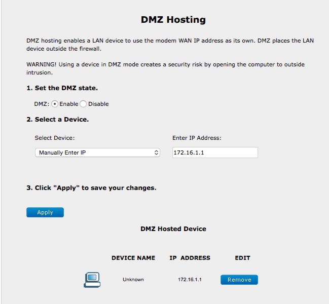

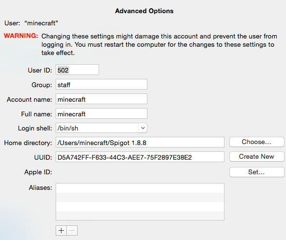

here are some screenshots of the things i have done, and this computer is set to have a static IP and theirs no issue there, I also had this problem when i tried to open up the minecraft server, local connections only even though i had taken all the proper steps to make it public, and i had to run[ sudo pfctl ] to get that to work on a public network. or if enabling the DMZ hosting was the reason it the mc server started working publicly, but i disabled it shortly after and it continued to work., keep in mind all IP address's in the images are local IP addresses not public ones.

What device is managing the DMZ? Is that a configuration on the router? I'm guessing that probably isn't the problem though.
Yes the DMZ is a configuration on the Router. here is the original pf.conf file located in etc/, also when i did this for minecraft i just created a new pf.conf file and added this line into it, Im not to sure if that was the correct way of doing it considering I'm fairly new to mac operating systems. and that conf file just sits on my desktop not doing anything,

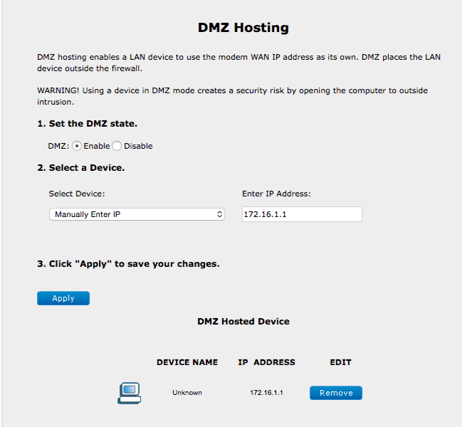

And to be completely honest with anyone reading this post, It is completely mind boggling as to why it doesn't just work like it says its supposed to, I may have to contact my ISP to get this resolved, it may not even be a computing issue. The main reason for this is so I don't have to deal with the server as it is someone elses. Its looking easier to go with prohosting on this if it doesn't work

Since you got a timed out instead of a connection refused, and since the machine accepts connections from the local network, it seems most likely that packets from outside aren't making it to your machine at all.
I'm a bit confused as to why this isn't working. Did you restart the router after you set 172.16.1.1 as the DMZ host?
Yes Ive reset the the connection from inside the router setting, I've reset it from behind the router, I've unplugged the router, and I've even hit the refresh button on the front of the router.. I too am very confused, I guess i may just have to contact my ISP on monday.
