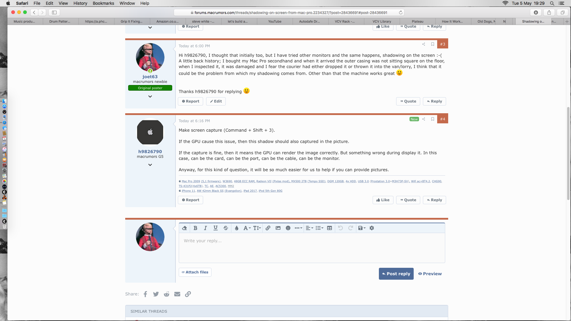

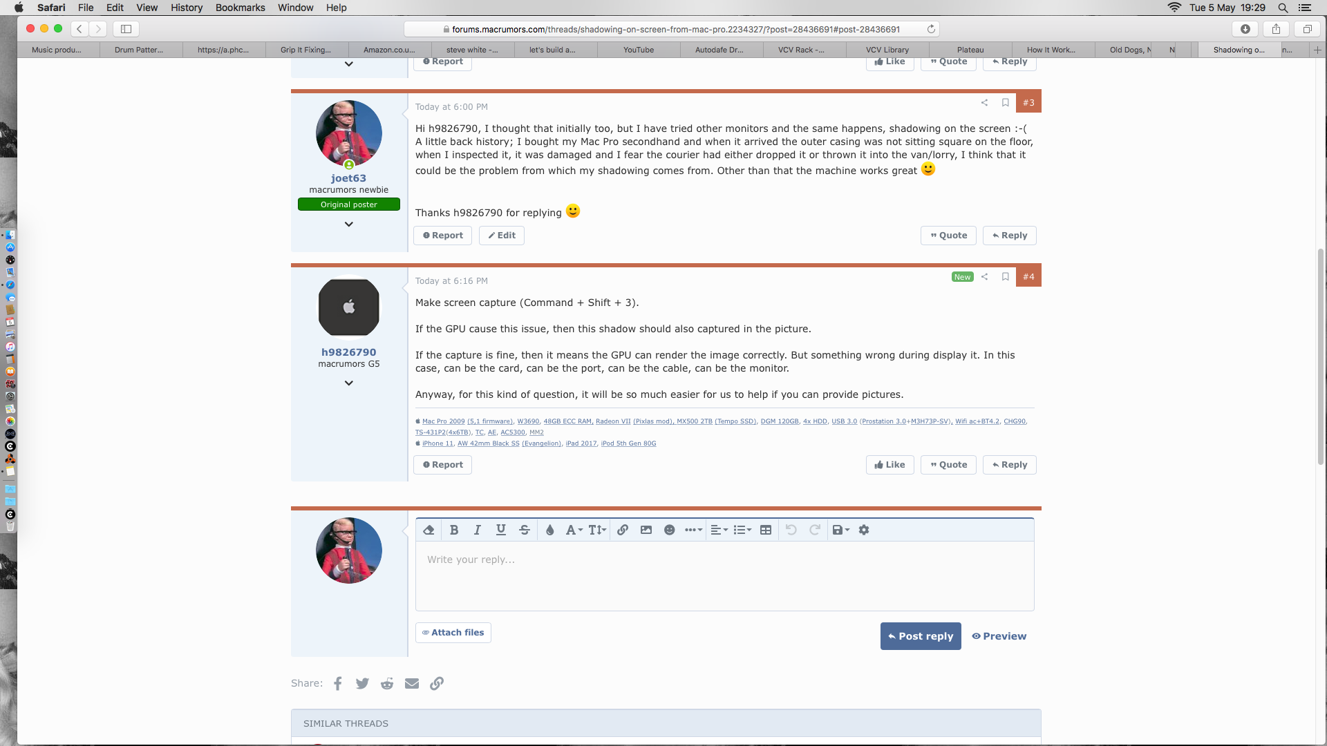

h9826790, here is a picture of our post, can you see the shadow on yours' and my profile pic? Also the MacRumours header has a shadow(s)

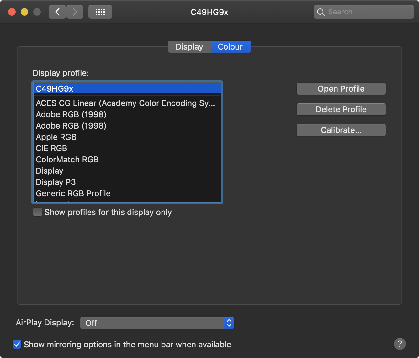

I have had look and the colour seems to be ok, I calibrated the monitor and no change as such but will keep digging. I also had the page like yours above and it was a bit of a minefield as to knowing what to look for and see any changes happening :-(
